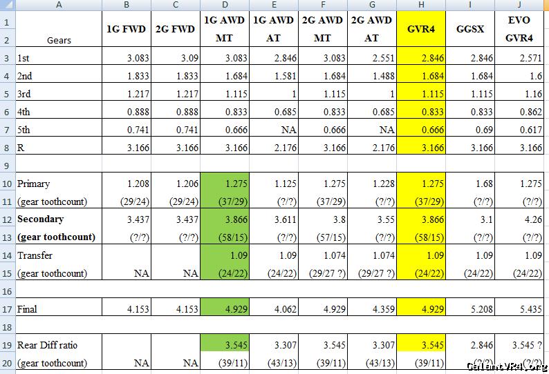

So, according to the table of gear ratios on vfaq,
The highlighted yellow is what I was running, and the green is an option. So I can go with a VR4 rear end and have no issue.
However, vfaq didn't mention anything about a LSD or open. Which ones are LSD and which are open? And how does somebody convert from one to the other?

I'm not sure we ever got this edition here in the states, but I *believe* it's the same platform as the GalantGSX.
... four wheel drive / non turbo
If that's the case, you will need a 2000GTX / GGSX unit, as I *believe* the final drive ratio is unique to those models.
You *might* be able to swap your ring and pinion (with a little work) into an lsd carrier, but you will need to get the matching axles, as the lsd units use (at least one) different driveshaft then the open units.

^^ There are a lot of factors that need addressing:
1. Auto or Manual trans on the GTX. On TEL models there was a choice which means final drive ratio for rear end and transfer case are different. John mentioned swapping the ring gear on whatever rear end you get, this will negate the need for TC swap.
2. All GVR4 models were manual trans with open/non-LSD rear end. IIRC the sticker code is B1B but again if sticker is gone or someone swapped out the rear diff cover it could be misleading.
3. LSD rear ends have different inner CV joints ( stub shaft length ) than non-LSD as noted. Again knowing what ratio is in your car now is vital.
