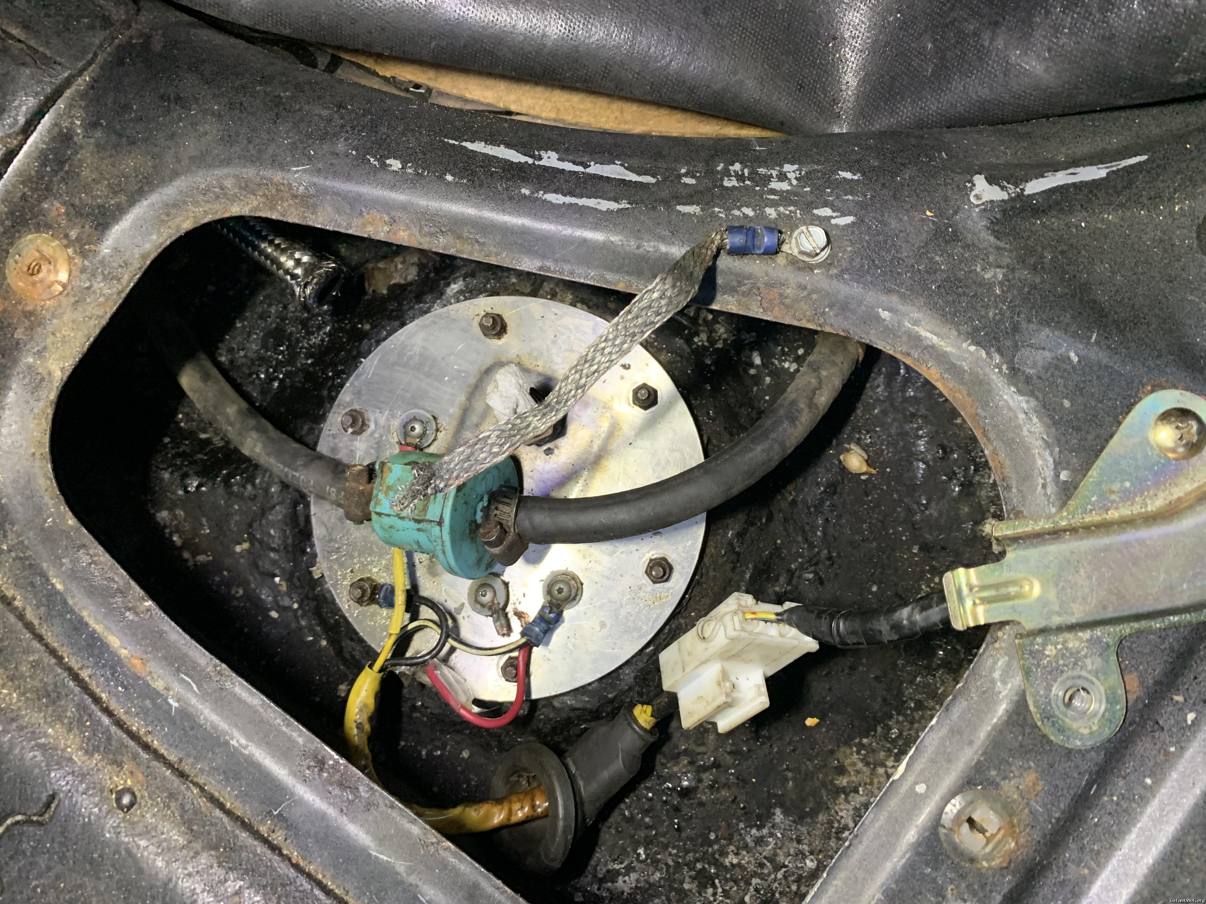

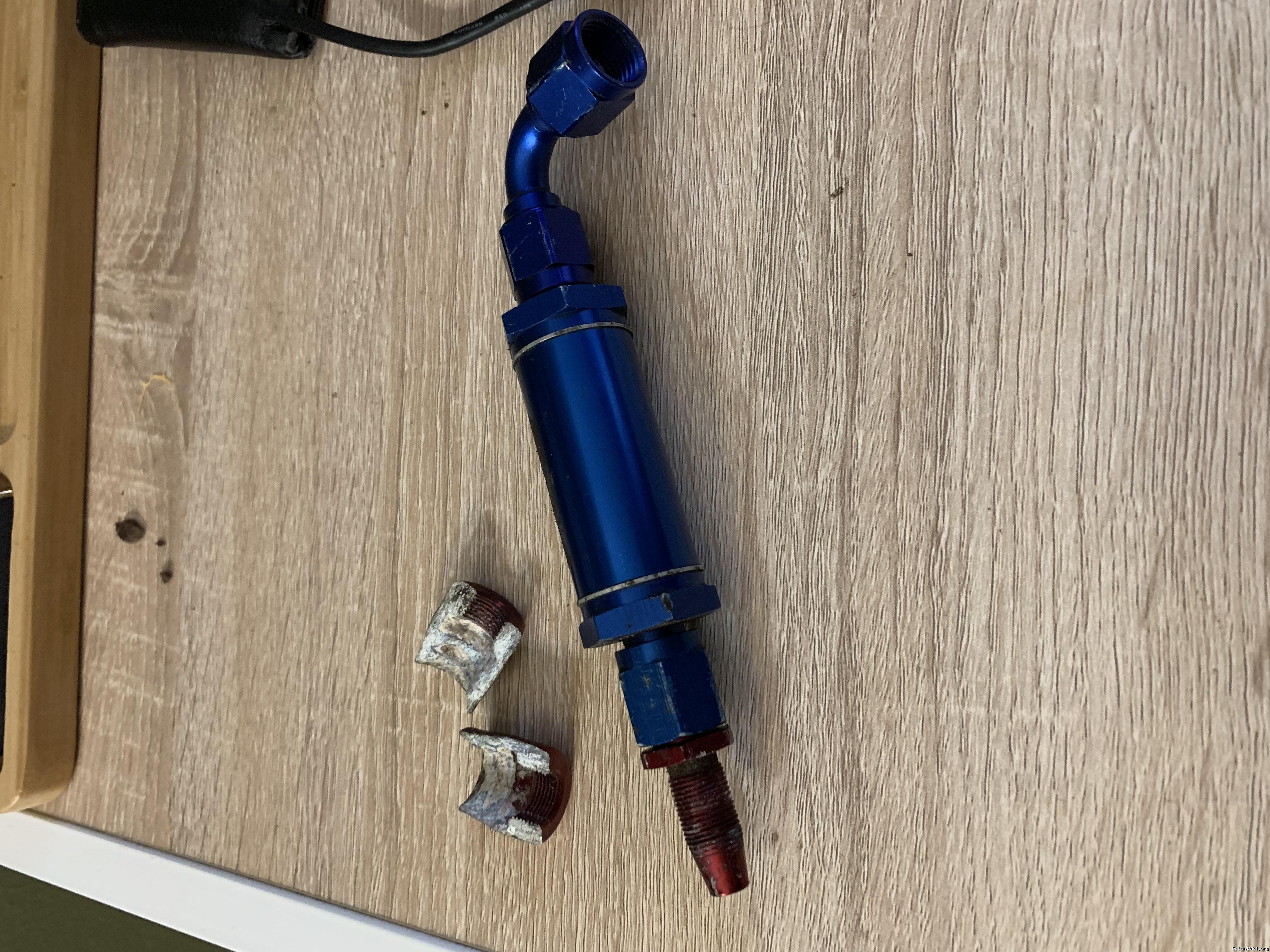

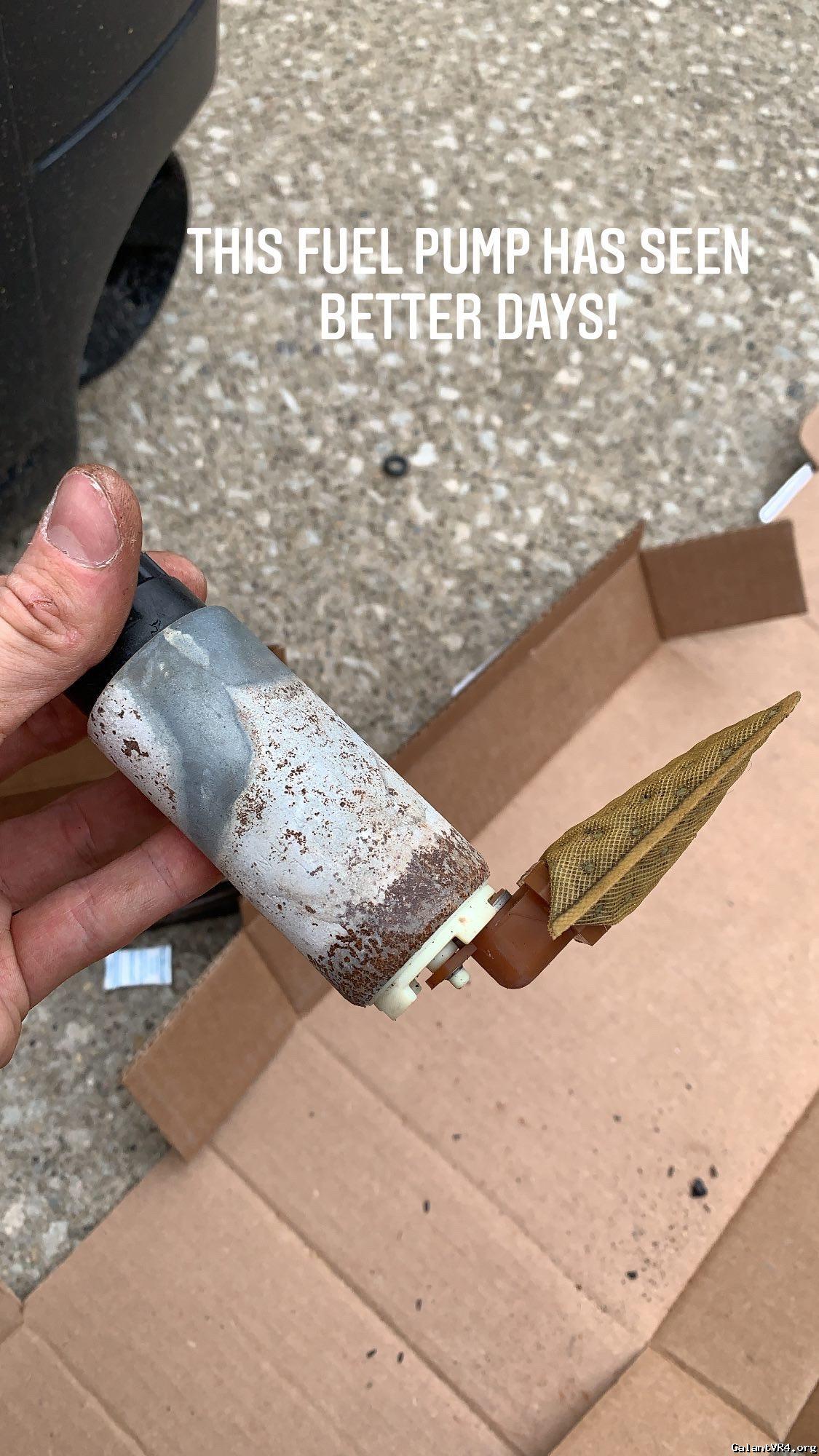

525 got me to work today!! I dug deeper into my fuel issues. I was seeing 27psi of fuel pressure, I read here the base is 37. The car has a -6 AN line which is cool. After getting to the sending unit, I saw many issues. The cap of the sending unit was very dirty, when I went to wipe it off a wire came loose. I found the Earls fuel filter there. The gaskets on the sending unit were compromised and causing shorts. When I loosened up the AN line going into the filter, I was met with dirty colored fuel. When I removed the other side of the filter, the AN fitting just snapped in half. Extremely corroded. I found many pieces of road salt sitting atop the tank, most likely aiding in the corrosion process. I ordered up a new filter and AN fittings also a walbro 255 kit. She sat for a couple of days as I awaited parts. With new parts in hand I got to work. Removing the fuel pump was a breeze. The pump had certainly seen better days. I discovered the floater was stuck as well. I had a low fuel light, but the needle said I had half a tank. The car has an after market sending unit and walbro 255 already, so replacement was simple enough. I replaced the gaskets on the top of the sending unit and put some new connectors on the wires. Checked for shorts and back in it went. Now time to replace the AN fitting on the line. Thank goodness this line had a extra couple inches. I used electrical tape and a dremel with a reinforced cutting wheel for this job. It took me 3 tries to get this to the point I was satisfied with the fitting. Reconnected everything and had my gf start the car as I watched for any leaks. Bone dry and now I see ~50 psi into the regulator. Sweet, I took the car for a spin around the block for the first time. YAY! The car hesitates in first gear almost stalls out until up to around 10 mph then normal in 2nd, 3rd, 4th. I am going to throw in some pictures I took during the process. I need to get more when I work on this next time. For anybody like me who does not know what exactly what they are doing, taking pictures before you take things apart and during the process is always a good idea. Also, I keep finding plugs and wires that are not connected to anything which is troublesome. Anybody know what the shielded wire is that is sheared ? The car has a sound system so I imagine it has to do something with that. I found it when I went to remove the plate on top of the sending unit.

That braided wire is typically a ground strap. I don't recall one in that area normally, so it may have been a ground for an audio system like you said. If it is severed, it is not doing anything, so you can remove. Where is the other end attached?
