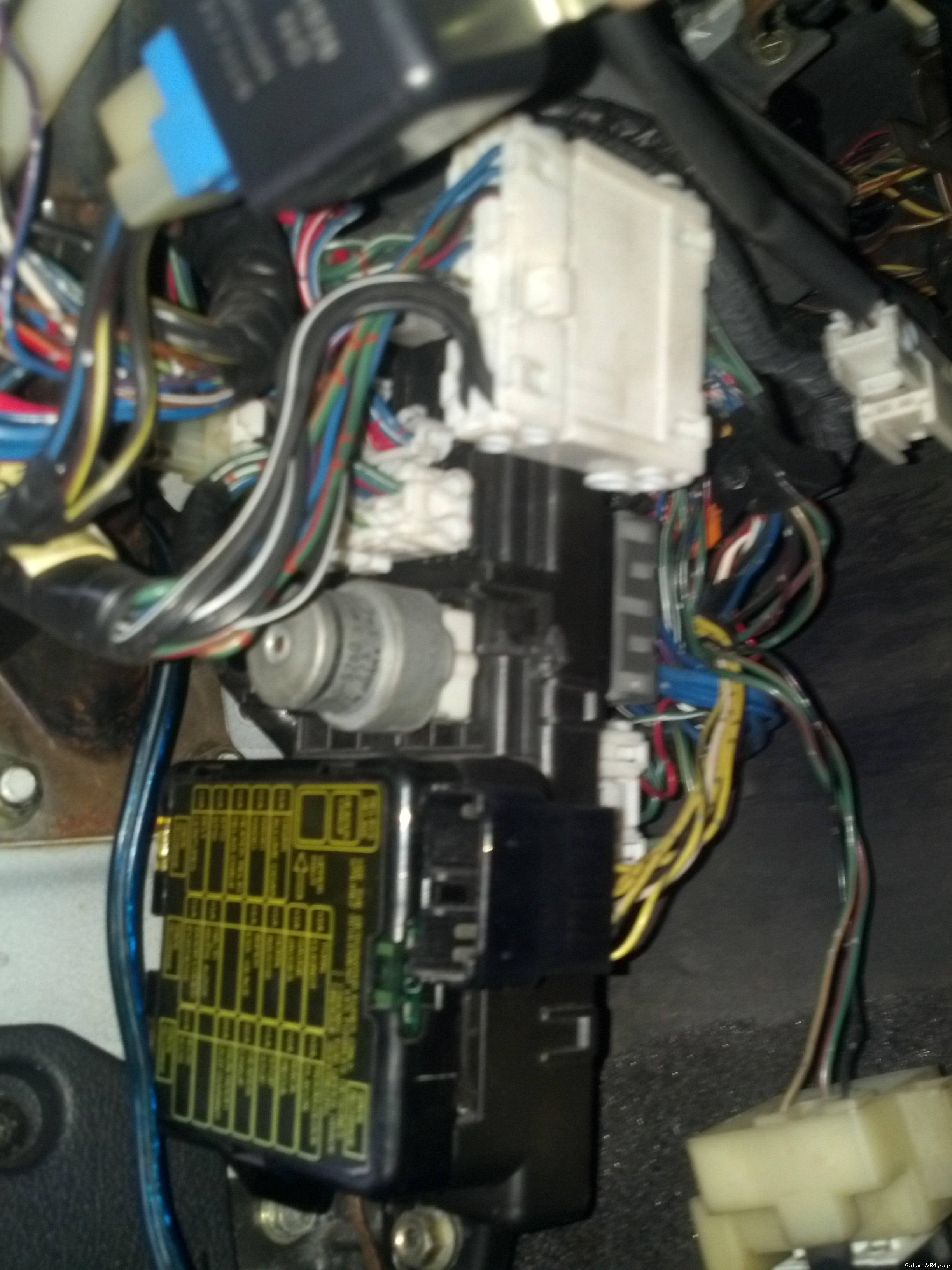

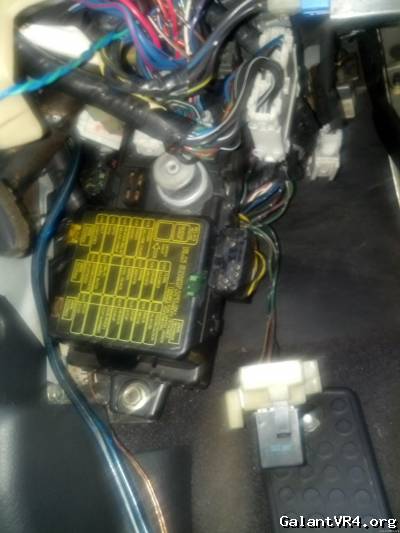

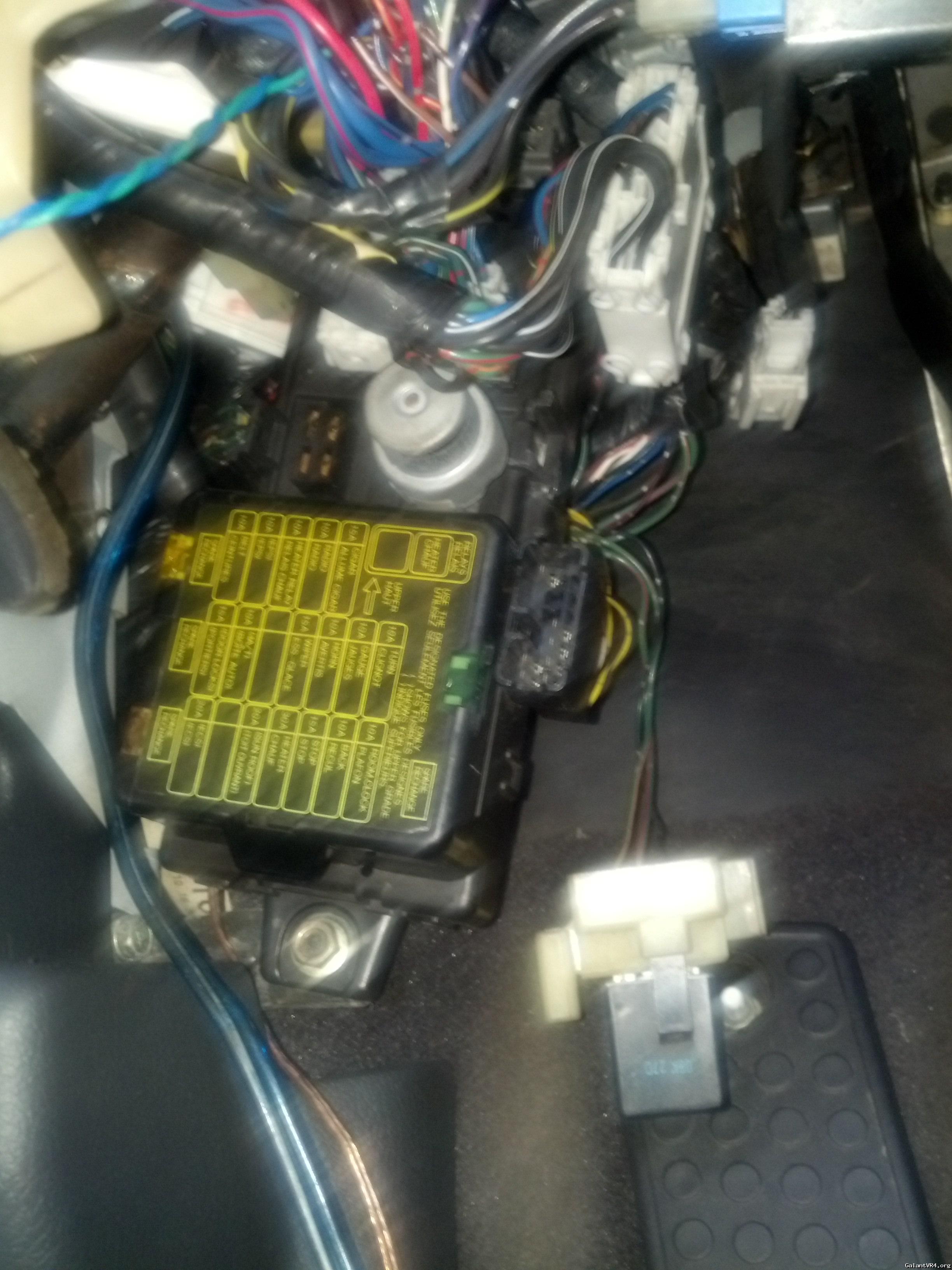

Here are a couple photos I just took maybe this will give a guy familiar with these what I'm looking at before I dig into these service manuals

Okay crap sh*t got the manuals out its ass backwards dash harness is stock and the engine harness is the one that was swapped

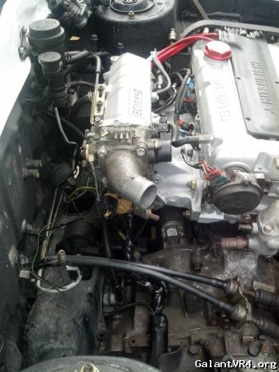

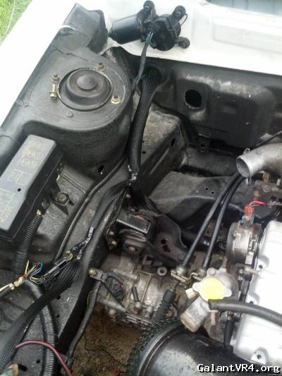

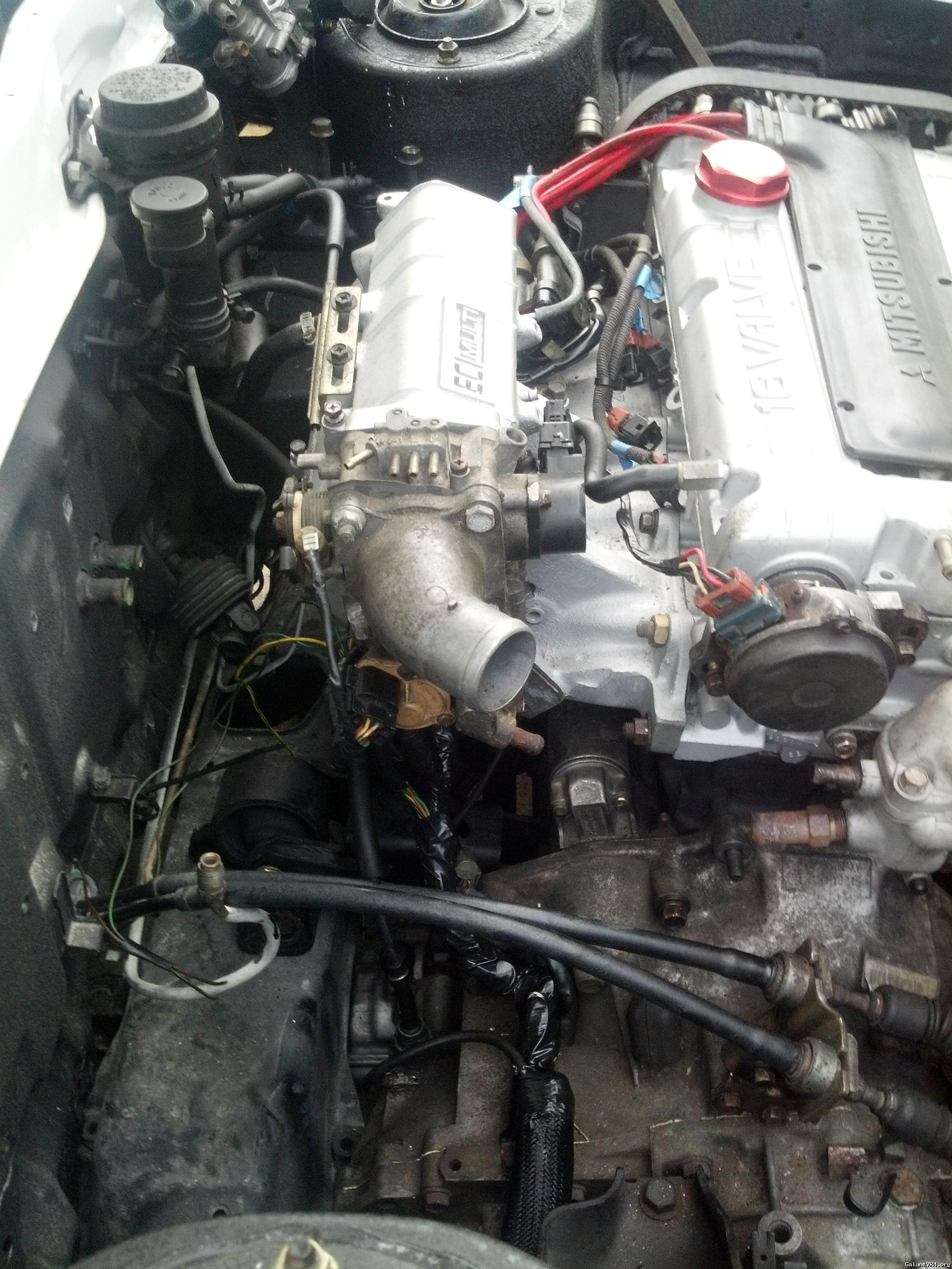

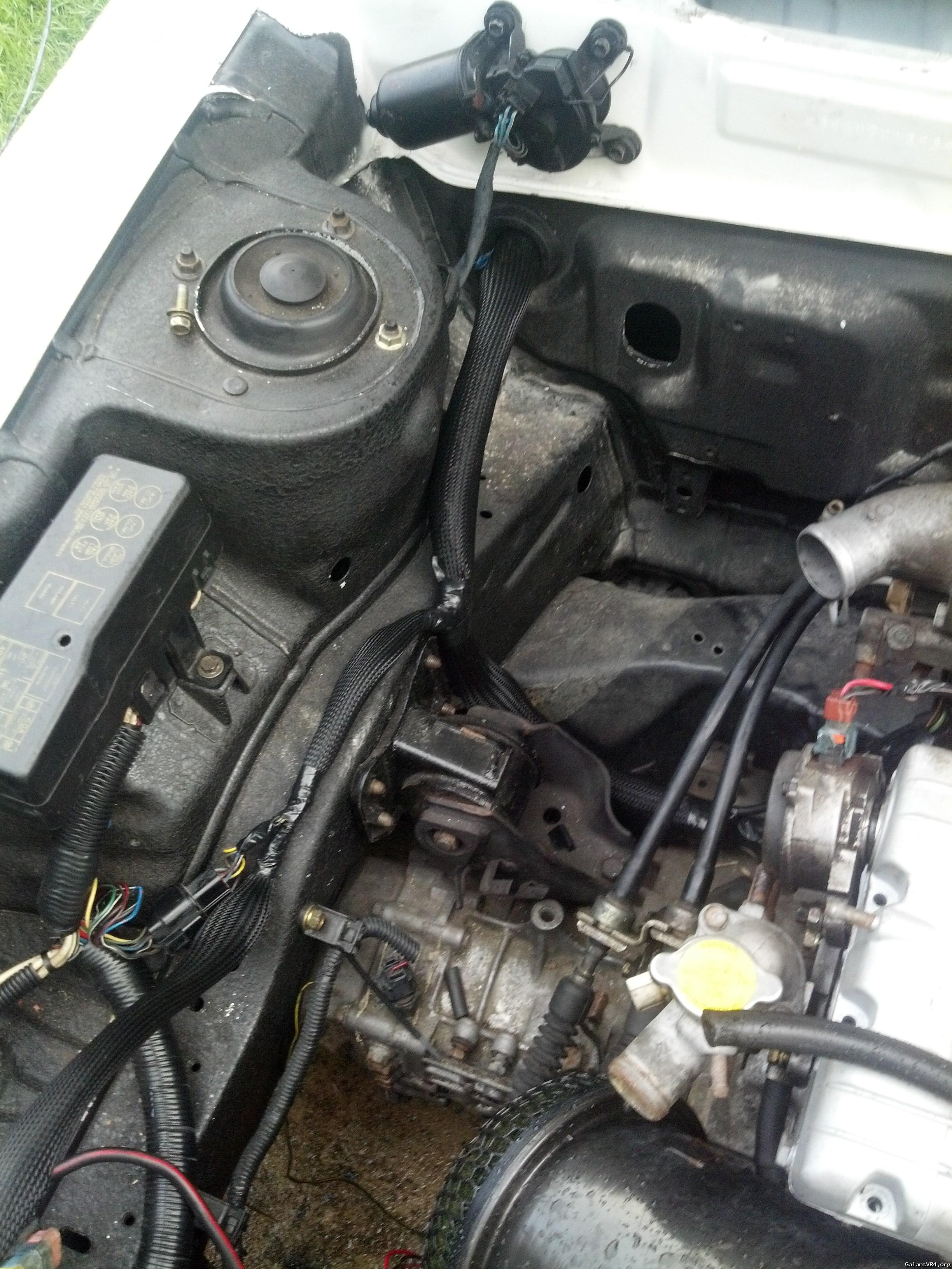

A couple nights work, 3 harnesses and a couple new castle turned into a proper engine harness. Big sigh of relief just have to finish with proper loom and mounting then the coolant temp sensor connector none of my harnesses had them, they all were spade connectors.

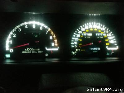

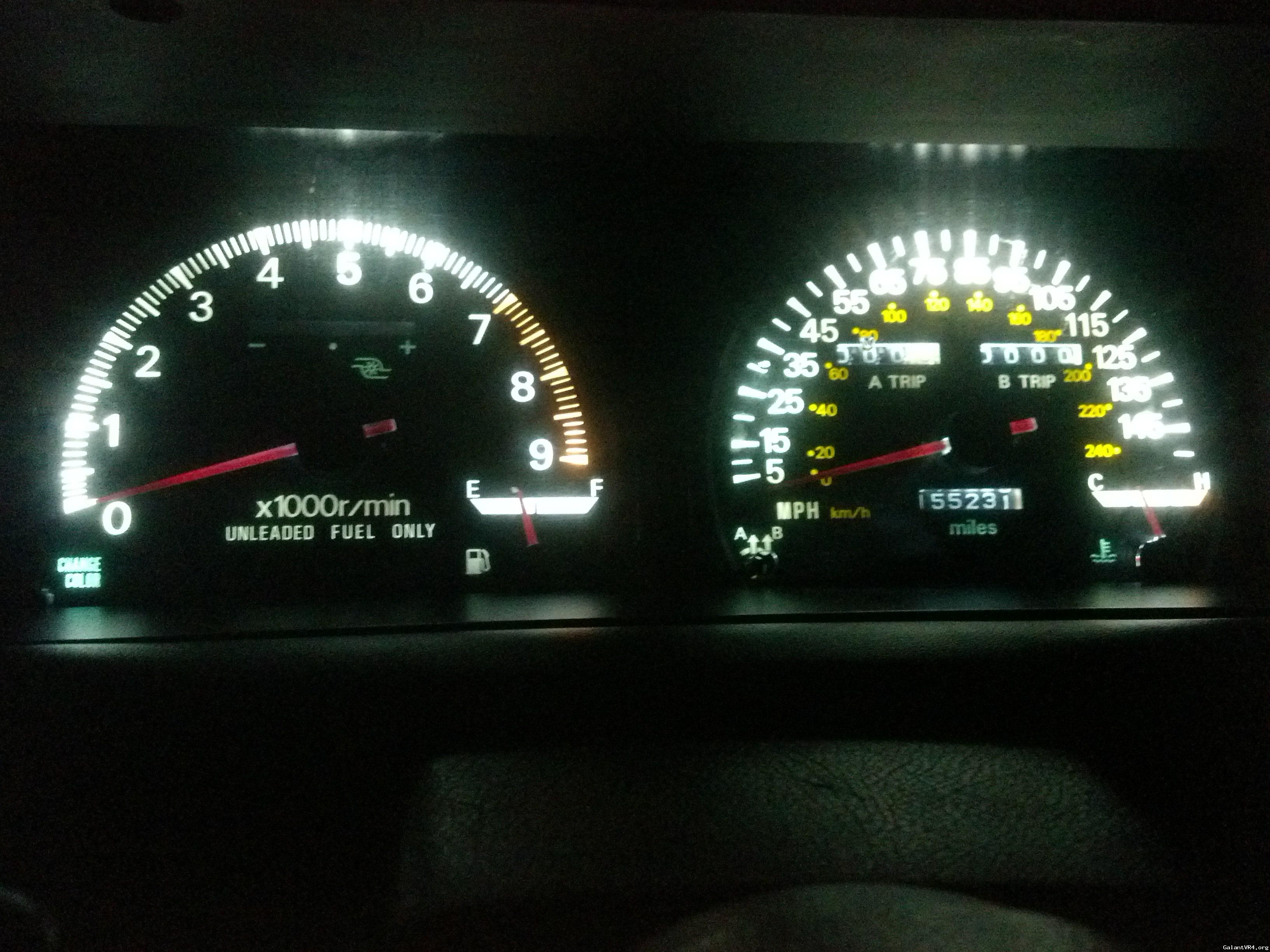

This looks to be progress, was stuck doing remedial work due to rain delays so I tore the cluster apart and sanded the green off the backside and install led lights to replace the incandescent guys. Not perfect and needs are dim didn't have the proper paint for them but all in all I'm okay with it. Would much rather see it fire up though damn you mother nature!!!
