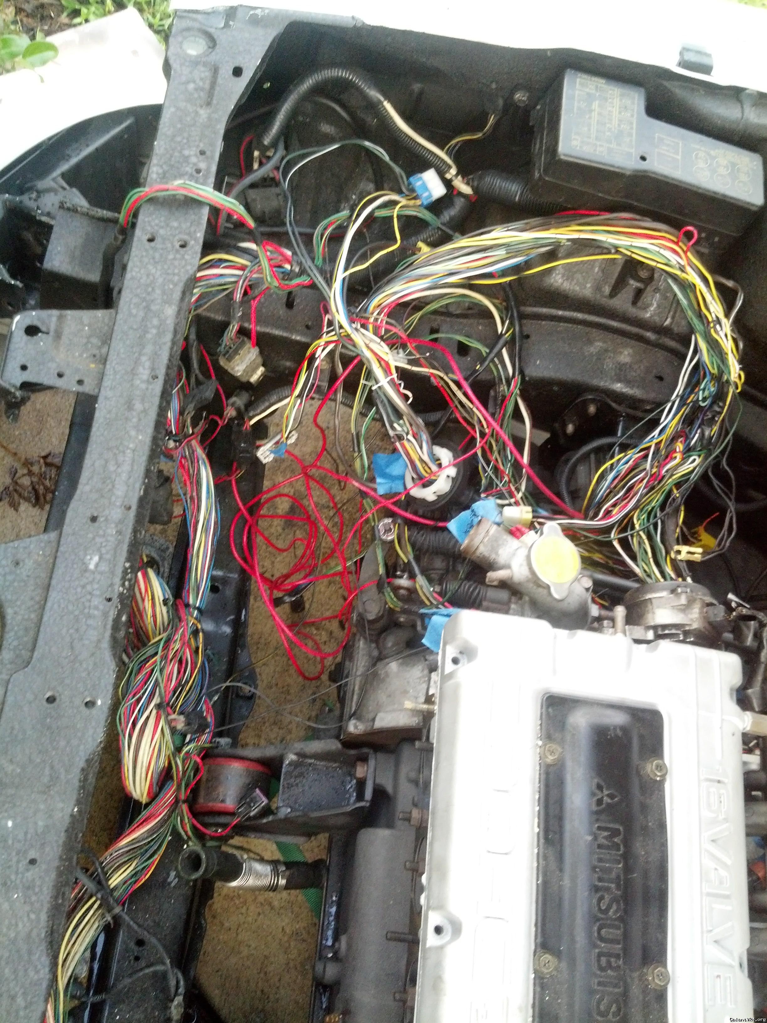

So my galant has a 1g DSM dash harness installed in it. I understand mitsu like other manufacturers use many same style plug ends but just because a plug slides in doesn't mean the pins are located the same like using a 2g aem in a 1g have to swap a few things. It would be wonderful if someone has came across this because I won't hook battery up until every wire is retraced or I buy both new harnesses. Needless to say it is a hot mess. /ubbthreads/images/graemlins/uhh.gif

There aren't any damaged wires. Its the whole dash harness from a 1g so that's assuming the cluster HVAC and every other thing that bolts to the gsx is the same as the vr4. I didn't say hundreds days like 16 hours. I completely built a new harness for my tc but I started the job and finished it. The car doesn't run but my mind says of any power and grounds leads are different from this gsx harness I have then the vr4 stuff will then burn up so I'm trying to avoid that. So I don't know how you would get there is only two hours of work there. I will upload pics. Not trying to be a resistance just some of the stuff said didn't match up with what I was saying. The dash harness is unmolested but from a gsx. Installed in my vr4 and the engine harness is a whole different monster.

That's the engine harness as it sits when I bought he and the po told me it plugs right into the 1g gsx dash harness minus 1 connector is different. But I haven't dug into anything yet just kind of fiddled around so far like make the brake lines and going over the bolts and nuts. I would essentially have to ohm every point the dash and engine harness meet and make sure they go to the proper place in the car.

I can see how that bad hair, er, I mean all those unwrapped wires might seem difficult to trace out but not really too bad. The electrical manual will allow you to trace every wire. It has wire colors, gauge, everything you need. Today I helped a friend trace out and label the two big engine compartment wiring harnesses. If I recall there were something like 70 - 80 or so connectors. That includes just about everything under the hood including all the engine connectors, ABS pump, and the front of the car (e.g., lights, horns, ABS wheel sensors, etc.) I think it will be the re-wrapping and tucking work that will take longer than actually tracing them out.

Yeah the engine harness portion doesn't bother me that rats nest is easily combed through just going to get out there tonight and go through the dash harnessand make sure all tthe wires are going into the right spots.
