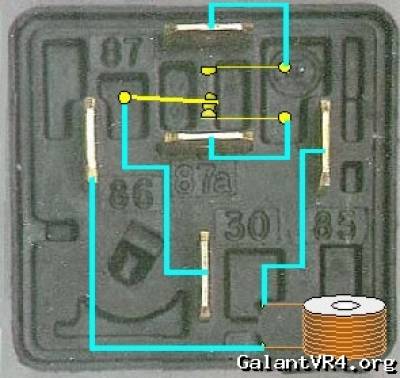

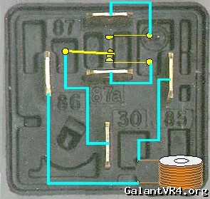

Cleveland, OH
85 - Ground (chassis)
86 - Your switch. (pull power from an ACC location. power from acc into switch then out of other pole on switch to relay)
87 - To fan(s)- Other side of fans gets grounded
30 - Fused power from wherever (You can pull power from the Batt, and install an appropriate inline fuse.)
That's it man!

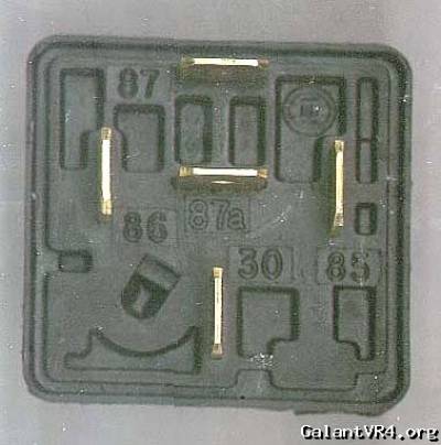

Bosch style relay is what is essentially in the pics above. You can usually grab them at the auto parts store for fairly cheap. They will sometimes have generic wiring kits as well, but if you're wired up/and have some extra wire, just grab a relay.
As a point of reference, the 87a terminal on teh Bosch style relay could be used when your switch is meant to 'switch' power between two different components. In one switch position, the relay would supply the 12v power to whatever is connected to the 87 terminal, and in teh other position, it would supply power to the 87a terminal. If you are just trying to get power to one component, just use the 87 terminal.
