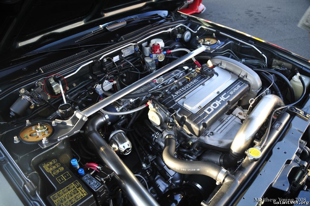

Is the intermittent feature working correctly? Usually the relay is bad if they start doing that.

Actually now that you say that, They don't work on int.
Where is that relay located? That makes sense.

11,982
Quoting 3rdstrikedsm:
Circled in red:

11,982
The wipers should be off with the stalk in the fully up position. Down one is intermittent, down two is slow constant speed and down three is fast constant speed.
Sounds like you may have a stuck relay. /ubbthreads/images/graemlins/dunno.gif
