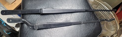

I believe flatblack is correct. The wing only came on the driver side. From the factory, I don't believe the passenger side was drilled and tapped for the little wing. The arms are the same shape though, so it is easy to have a passenger side arm with the holes.

However, the arms are different from driver's to passenger's side, least on mine. They both have the rubber insert for the wing but seems like only the driver's side is threaded but there are the same holes. Weird they did that, although thinking because Japan and say England and Australia drive on the opposite side and on those, they have the wing on our passenger/their driver side. Just a guess.
Here's what mine look like right now, passenger @ top and driver @ bottom. You can see the rubber insert at the 'top' of each wiper in this pic...both have two holes that match the wing spacing, only the driver's side appears to be threaded. Probably could thread the passenger side with the screws but not going to do that if only one side was stock.
Started sanding them down, going to go with flat black this time.
