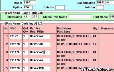

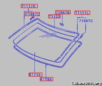

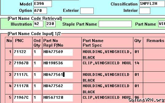

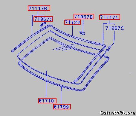

Quoting brunoboy:
I have some messed up wondshield moldings on the passenger side which includes missing the chrome corner. Has anyone use a universal trim all the way around their windshield? If so, how much was it? Brand? And how was install?
I got the set from mitsu for mine. They sais this was the 2nd last set in the US. The corner pieces - aka the 2 90 degree turns are included with the straight vertical pieces that go on each side. The center piece is NLA from Mitsu. Rears are also NLA from Mitsu. Hope this helps.
