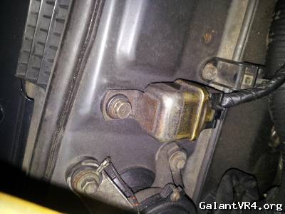

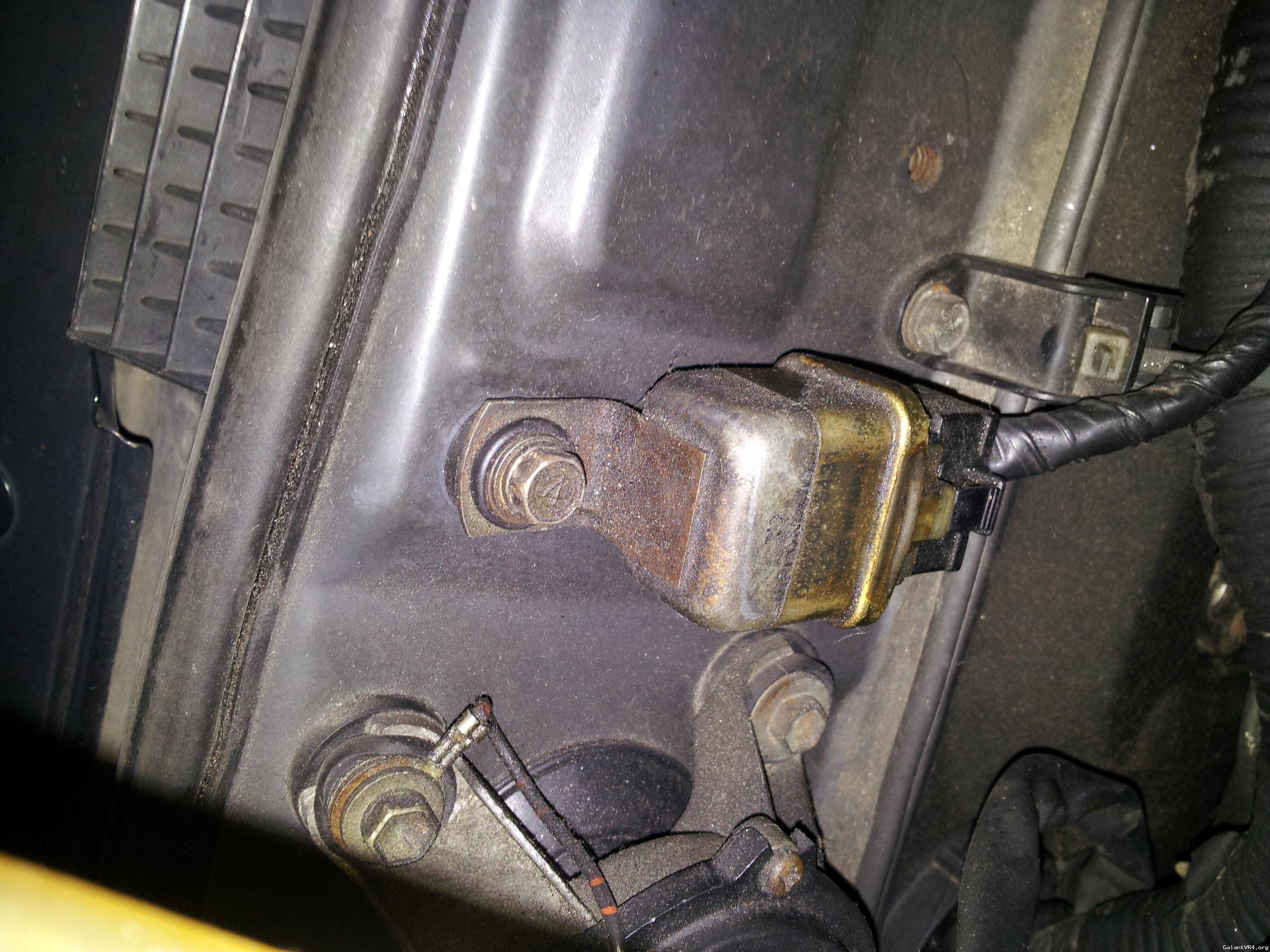

is this the windshield wiper relay? its on the left side of the firewall. my wipers run slow but when i disconnected this relay they still were moving. can someone send a pic of the right relay?

That looks like the Wiper relay, the wipers will work on slow speed even with it unpluged. The relay controls the intermittent settings

That is the wiper relay. Replacing it fixed the problems I was having with my wipers.
