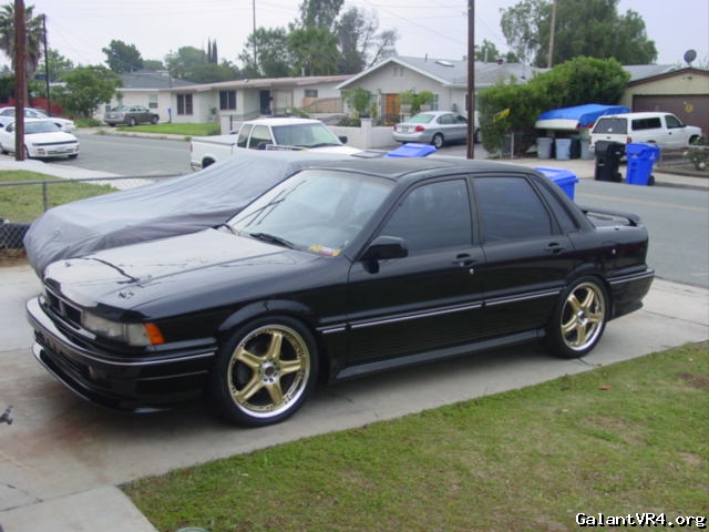

i used to own a 91 vr4, and i used cheapy coilovers on my, it is a very low drop and i had to raise the rear all the way up just to level it out. it is a severe drop but looks clean as hell( ps i likem low)
