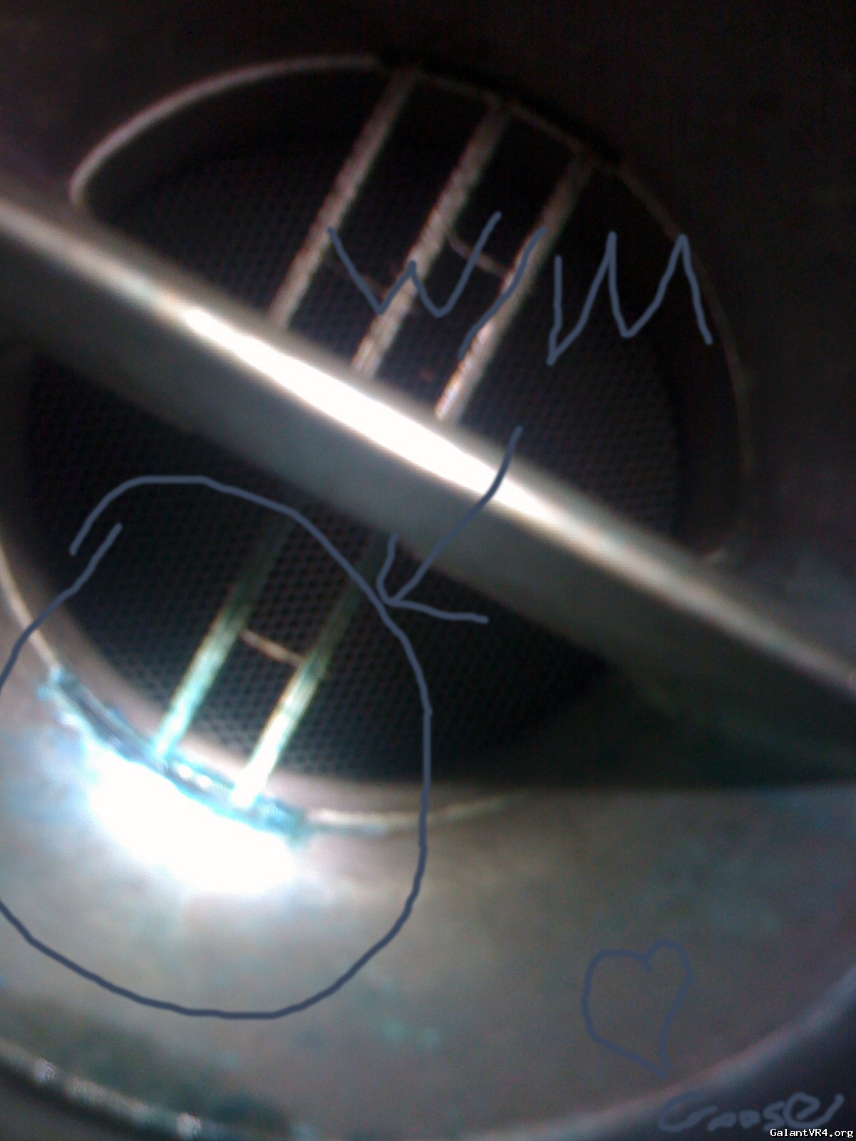

Out of curiousity, I was going to rotate my MAF 90 degrees so the bars are parallel with the ground and found this when looking at the backside.
Good ol water/alky puddled on the bottom (white spot area) and all over the bar near the hot wire. Not the smartest tool in the shed but im pretty sure this would cause some if not all of my issues. /ubbthreads/images/graemlins/uhh.gif
I guess i'll just yank out the injection system for now and just run good ol pump gas.
Cleaned the sh*t out of it with MAF cleaner. Same thing. This is fuel delivery related, I'm definite about it now. It's either the fuel pump, fpr, or the line itself.
