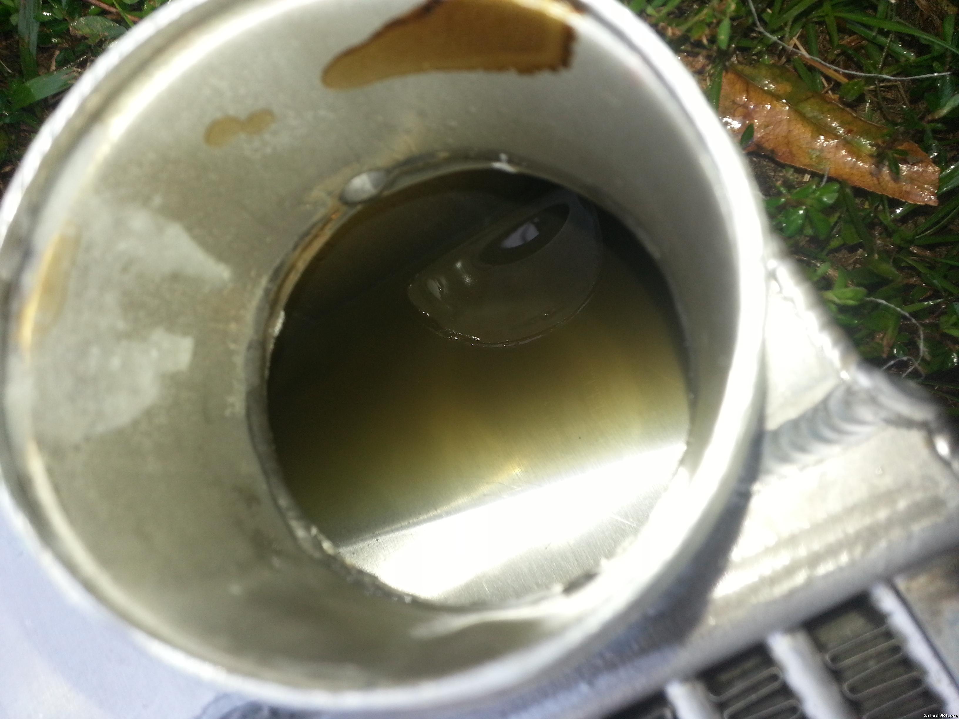

Gallon of gas, brake cleaner, and engine degreaser. Nasty. I knew it was gonna be bad when I got it and there was oil sitting in the ic. A lot cleaner inside and out. Gonna install for mock up before I pull the engine and transmission. Gonna make a build thread for 452 soon.

Right now what I poured out is sitting in a small trashcan. Plus the fool I bought it from stuffed it in a box with Styrofoam peanuts and broken pieces. I believe I got all of it out. The last bit kinda poured out thicker than gas lol. Im gonna flush it one more time then hook it up tomorrow.
