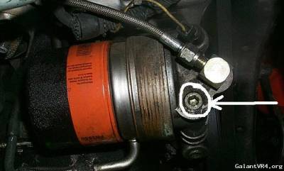

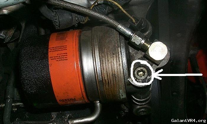

Check out this link, it will get you set straight.
I am using the hole in the housing that is right below the one in the pictures on that website...... Cant tell if thats filtered or not from their diagrams.
If you are using the bottom hole in this picture; http://www.roadraceengineering.com/instructions/oilline/oillinelocation-1g.jpg , you are feeding your turbo unfiltered oil. That's why your turbos are dieing.
Barnes
Feb 9, 2003
6,249
Richland, WA
Correct. Unfiltered. In all likelihood this is why you are killing turbos. Not because of high oil pressure.
Ill be sure to thank the P.O. for installing that there. /ubbthreads/images/graemlins/banghead.gif
I Might just go off the head still because i am not running that large of a turbo..... If I ever switch back to the OFH i guess ill know then.
