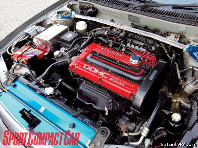

Comment on the fitment? He's taken the FR TD05HR manifold and attached a new turbo flange so the inlet now points more towards the gearbox - probably because the turbine housing clashes with the radiator.

Totally different car. That is evo8. Evo3 is still passenger side trans, and that mani points the turbo to the drivers side. The only twinscroll mani I've seen, that is for our cars is punishment racing. UMS tuning is in the R&D phase of a tubular twin-scroll that utilizes all evo 8-9 turbo options.

Correct me if I am wrong, but don't people run stock Evo III ported manifolds on our cars? This is what makes me think that the TS t4 manifold designed to fit the Evo I-III should work for our car as well.
Unless the pictures of the manifold on the engine are incorrect in that link then they show the Evo 4< engine which is reversed from the Evo 1-3.
I'm thinking they mislabeled the parts on the website.

Holy price batman lol.The first portion of the link is incorrect(Mitsubishi » EVO I-III ('92-'95) » Turbo Manifolds » EVO-4G-TM-TS-T4 from looking at the engine and the pics car it looks more like a later series evo setup. If you look further down the page they also show the dyno results with a GT4088R and a 2.4l evo VIII.
