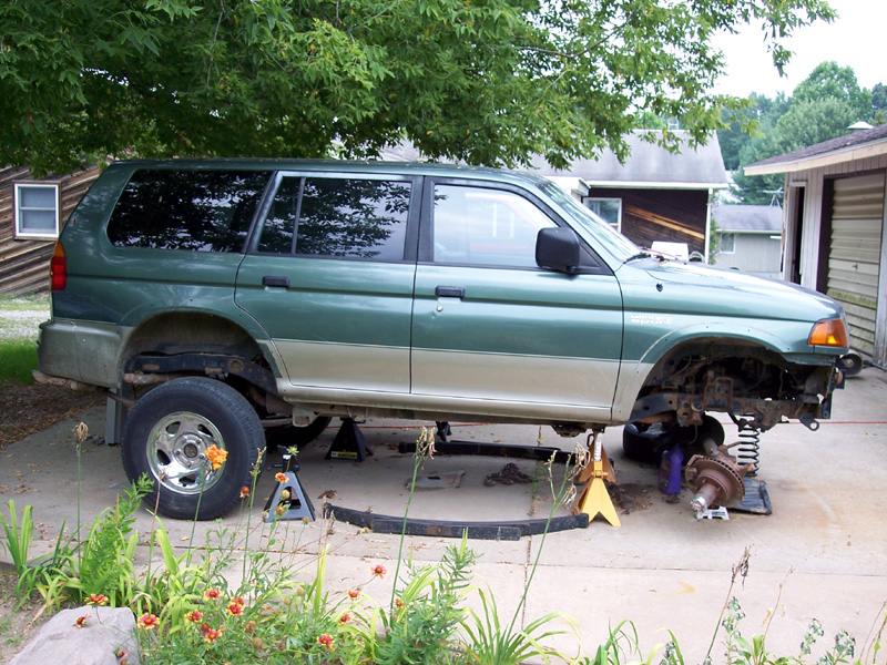

being a broke ass college student has made this truck slowly go...well, no where. I have to finish it before snow flies too much though. 6 months into the project and this is how it looks:
I got some of these for the lower control arms /ubbthreads/images/graemlins/laugh.gif and brackets from ruffstuff specialties, still need steering sh*t and other things here and there.
Wound up going with a Dana 44 high pinion front axle and ford 9 inch rear axle.

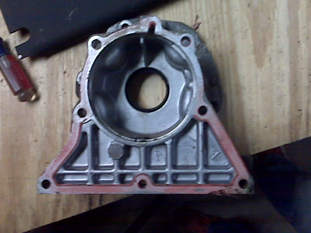

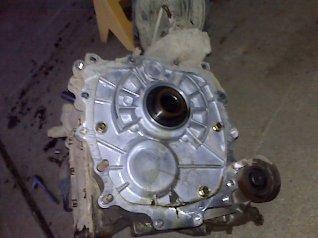

here's some pictures of the transmission and t-case comparison stuff
mitsushitty transfercase, otherwise known as the gigantic useless piece of sh*t.

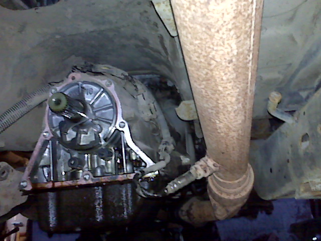

Trans still in the truck without the tail housing on it. Anyone into jeeps would recognize this transmission.

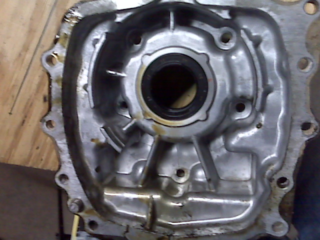

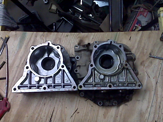

jeep on the left, mitsu on the right, mitsu is freaking over kill

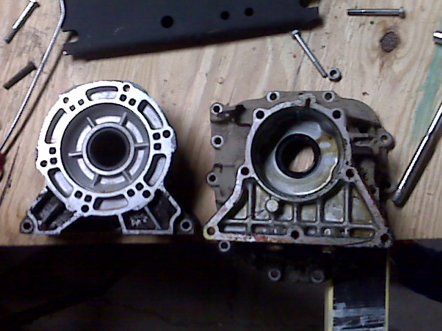

jeep on the left again, gee, they look similar.
5 of the 7 bolts for the tail shaft housing require the tcase to be removed to get to them on the mitsu hosuing, on the jeep housing they're all external
backside of jeep one
