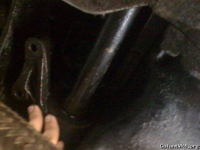

so while removing the f'd xcase i happened to look up and well OMFG im missing a bolt.... now what bolt you ask yourselves, well it is on the driver halfshaft... right behind the oilpan.... pn was 586.... 2 drilled holes.. but only one is used and it sinks into the pan im assuming /ubbthreads/images/graemlins/banghead.gif.. "maybe thats my oil leak problem as it has oil in the hole" /ubbthreads/images/graemlins/bawling.gif but no to the smart-asses out there it is not my drain plug..... ive never removed this said bolt so i dont know the size... /ubbthreads/images/graemlins/uhh.gif anyhelp? TIA

it is this hole right here.... so its a carrier bearing you say? what size is that bolt... i mean its like an "L" shaped bracket on the intermediate shaft...

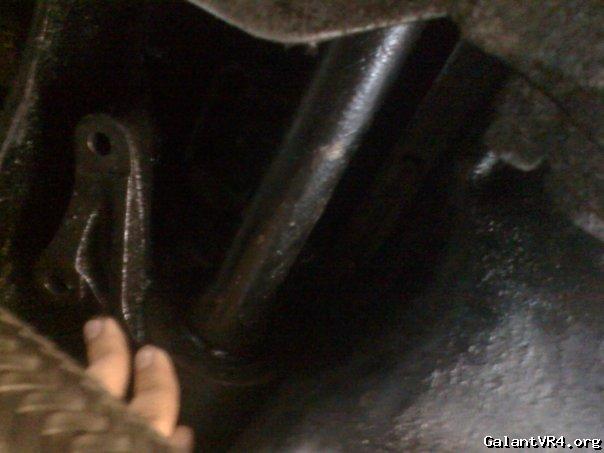

Thank you all i have this picture here i just snapped with my phone... i know its bad but o well... im not driving it right now. /ubbthreads/images/graemlins/smirk.gif.... but
/ubbthreads/images/graemlins/blush.gif /ubbthreads/images/graemlins/mad.gif
and there is not a bolt in the said hole... so i just need a size and a good place to get it..... Mitsu here is a killer in pricing /ubbthreads/images/graemlins/banghead.gif... and well im not going that route...

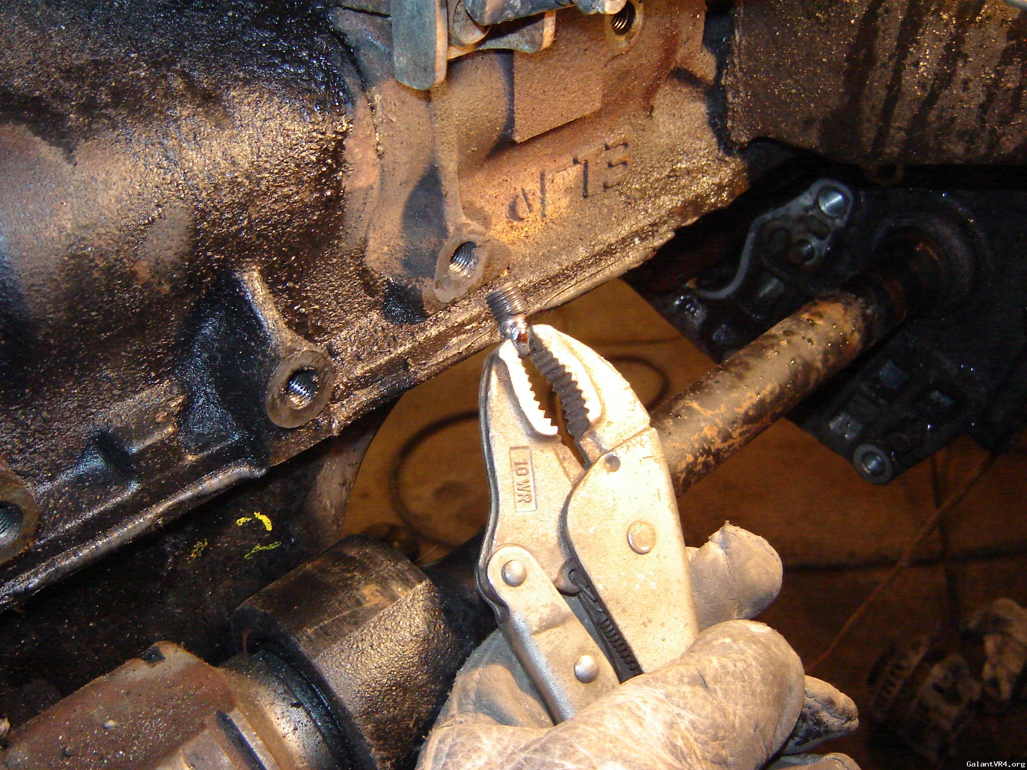

Also, this is what I was refering to as when the "inferior" bolts break or fall out. The bolt in the picture that I am showing how to remove is an aftermarket Bolt (homedepot, lowes, cornerhardware store, ect...)
