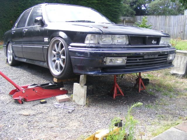

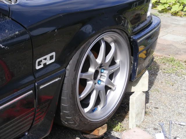

18x9 +30 with 235/40's
I've only lipped the guards thus far, but these tests showed that the only place the tire contacted the car was the outer lip of the guard - even at full lock and max suspension compression the tire still clears everything else (I removed the outer guard panel for full lock tests, no pics though).
I should point out that if you have stock steering tie rods they will hit the chassis long before you get this much compression (about 35mm ago)

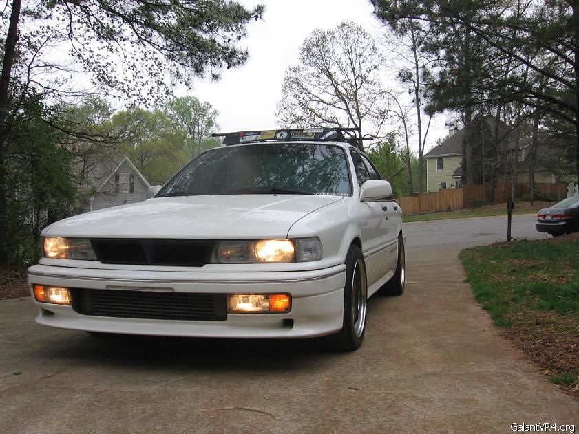

225's +35 on a 8 inch wide rim looks good. This is with my old 16x8 Forgelines. Car sat too high in these pictures but with more lowering it sits perfect.
Playing with different tire size and sidewalls on another 16x8 +35 wheel, on my te37s it seemed they fit more in the fender but I think that is just an optical illusion since there is no lip.
