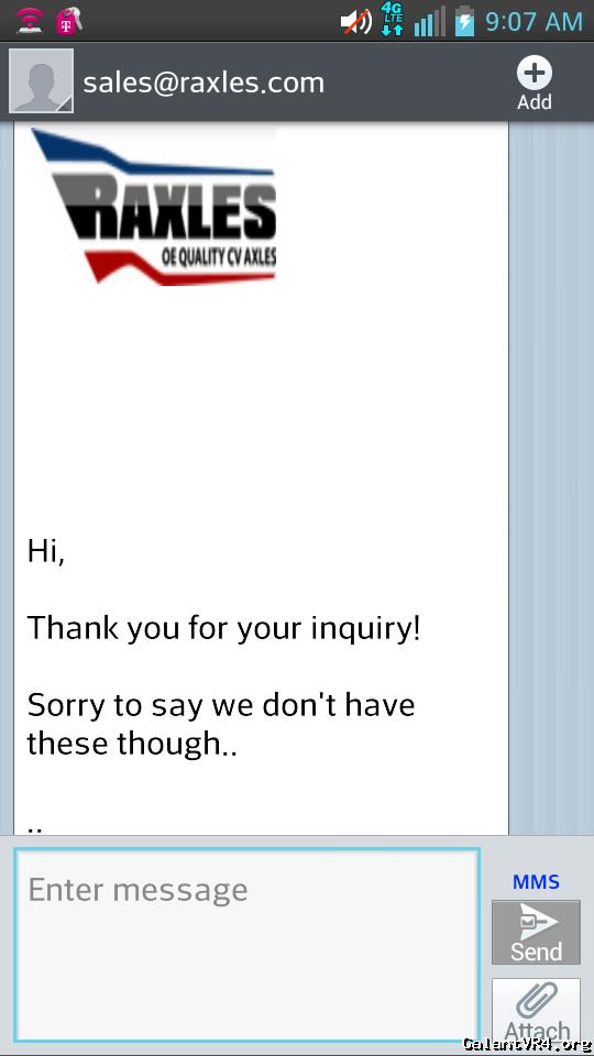

If you are looking for a little more than stock but not insane there is a couple levels up from Driveshaftshop.com. They do have front and rear in a 600hp level and a 1000hp level.
10,996
Quoting mikus:
^ that'll do but add one vote for RAXLES and really they're not very expensive.
Last I heard, Raxles did not make parts for these cars anymore. Maybe that is wrong info though.
