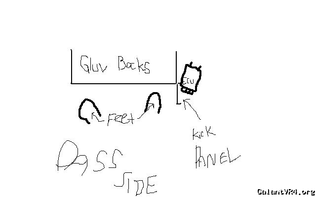

if ur sitting the in the passenger seat, where ur right foot would be, its to the right of that behind the panel.

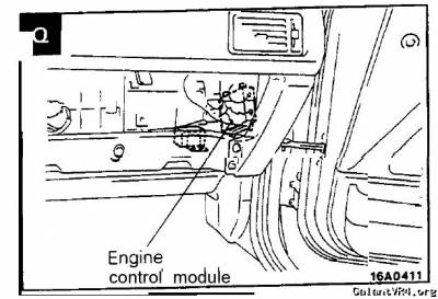

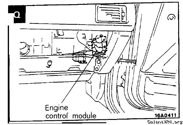

If you just peek over the top of the passenger's side kick panel you will see a 12mm bolt and a 12mm nut/stud, which are to hold the ECU upside down in that location. You need to remove that plastic pan under the glove box, if your car still has it.
This is a not-so-helpful picture from the manual:

"Gluv Bocks" Hilarious. An artist in the making hahaha. But yes you are correct.

Haha I was just really bored! It was quite fun and as you can see a lot of time and effort went into that. I would have posted a real pic but my car is not around at the moment.

The factory manual may explain it better, but that MSpaint rendering is worth saving in teh how-to archives. /ubbthreads/images/graemlins/bowrofl.gif
