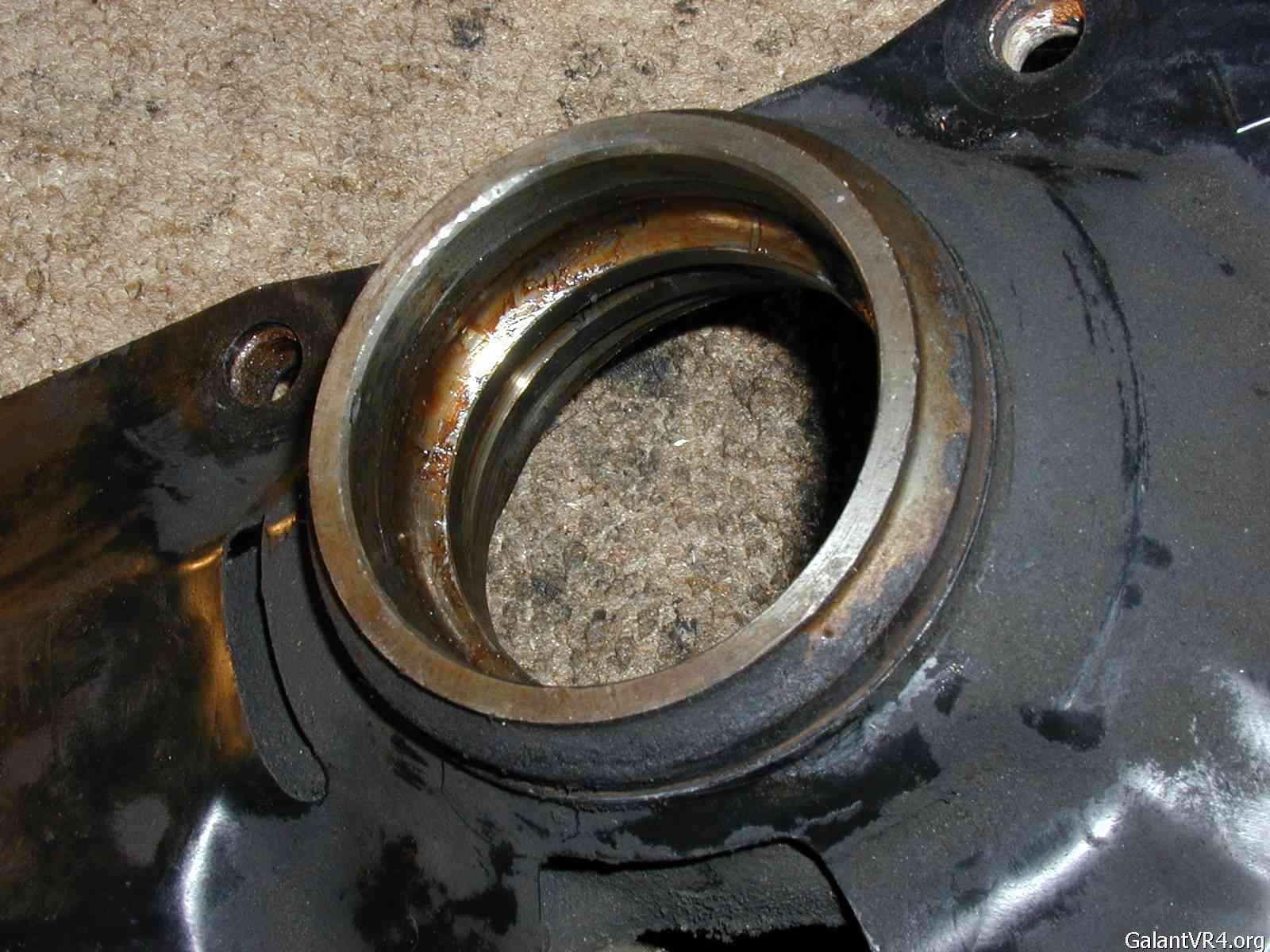

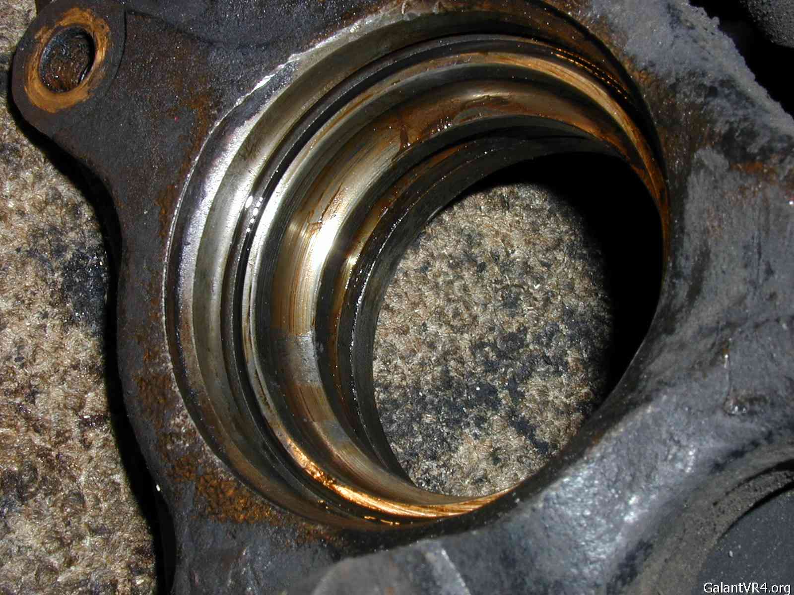

ok, the wheel bearing just won't come out, it just won't budge at all, I can't even use a press to get it out since I have noting to hold on to, it's flush with the knuckle, can anyone circle the place that you guys hit it out? thanks
this is the hub side, see it's flush with the knuckle
this is the axle side, the snap ring is gone, you can see the bearing outer race stuck in there

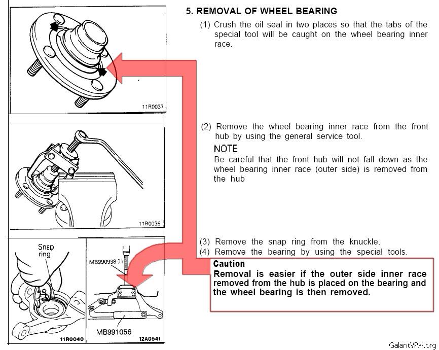

I looked closely at the service manual and this stuck out.
I haven't done the wheel bearings so my opinion may not be of much help. Every time I call Mitsubishi and inquire about the /ubbthreads/images/graemlins/worthy.gif "Special" Tool, they tell me they use a standard puller.

I am about to do this without the "SPECIAL" tool. I will be using a standard bearing puller, so I am interested in how easy it is to crush the two sides to gain some place to pull it off. I have read the FSM, but I haven't looked at the hub yet to see what is what. Keep us informed. It looks like that has to come off so you can knock the race out from that side.

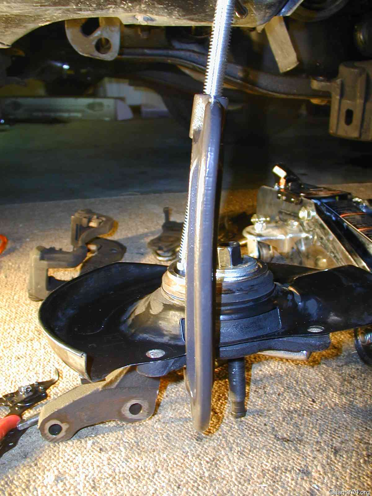

I tried that already, I read through the service manual, chilton and anything that I can find online again and again and again, nothing work. i don't have the special tool, but I use some big washers and hammer the $h1t out of it like the pic up there, won't budge at all, I even hammer my thumb 2 times, now it's all swollen and can't even move. I even ask my neighboor and borrow the air hammer, still won't budge. was thinking to torch the sucker, but just afraid that I will mess something up. and I am pretty sure you can't crush the side to gain any space, since that's at least 1/8" thick 1 piece circular steel. I also tried PB plaster, nothing, clean it up nicely using brake cleaner, nothing, went through 2 6-pack, on my third right now, still nothing... I think I am gonna give up and take it to the machine shop tomorrow and have someone to press it out for me, that's gonna suck since I have no other car... anyone else have any idea?
