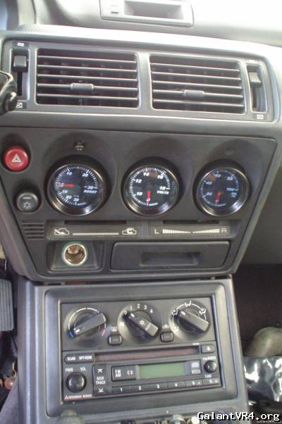

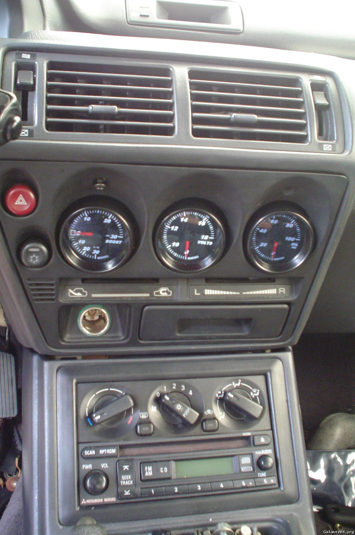

I cut a pigtail off an 8th gen galant in the bone yard and then bought radio install harness for a 6 gen galant. Soldered them together to make plug-n-play adapter for my evo radio install. No cut wires, clean and is completely removable.

sh*t forget the radio, how did you get/source the hvac controls in the radio spot?

Yeah, 8g galant and 3g eclipse both use them. You have to hack up the mounting tabs on the sides of the controls to get them to fit and knob for hot/cold works backwards. One day I'll pull it back out and see if I can get it the way I want it. Not holding my breath though, because I originally did this back around '07. /ubbthreads/images/graemlins/rofl.gif

I really do like the look of the OEM Evo radio with the 3g Eclipse HVAC controls. Came out great!
