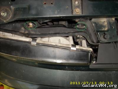

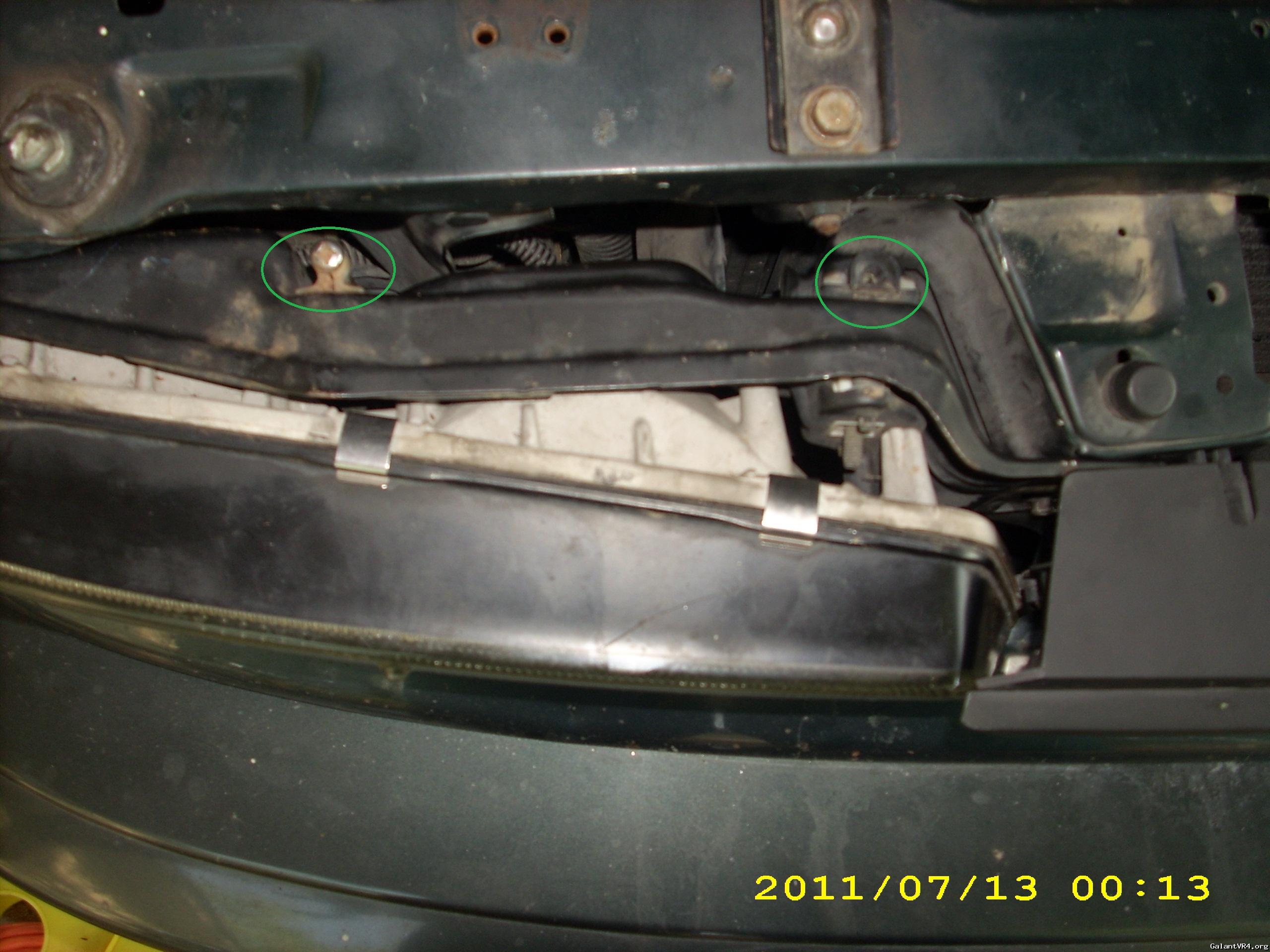

All, I am having trouble figuring out where the screws are so I have attached a pic. The one circled on the left doesn't seem to do anything at all. Is this one of the adjusters and if so which one?
I speculate that the one I circled on the right might be an adjuster but I am not sure. I certainly don't see anything sticking out of there.
Is the screw missing or am I looking at the wrong thing?

So the left green circle does indeed adjust the headlight vertically. It happens so slowly that I had to take a power drill to it, to observe any change.
I can see where the horizontal adjuster is but don't see any clear way to adjust it from the top outside of the allen key in the rear.
Any ideas?

As I said before, you stick a philips head screw driver into that slot on the adjuster pictured on the right and turn in like a perpendicular gear setup. /ubbthreads/images/graemlins/dunno.gif
For the philips screw head on the left, yes, that is an adjuster. If you were to remove that headlight, you would see that the left adjuster philips screw is actualy just a philips screwdriver itself on the other end, and is doing the same thing that putting a screwdriver in the right adjuster would do. What you have to watch out for on the left adjuster is corrosion preventing something from turning. The parts that hold the adjusters together are all plastic, so if you try to adjust it when it is stuck solid, you will snap the plastic retainers and the adjuster will be broken.
Sorry, I can't find the words to describe it any better. Just stick a philips screwdriver in the right adjuster and you'll see what I mean.
Gotcha and very clear. Now what about an actual procedure for adjusting the lights horizontally via the horizontal adjuster. Vertical adjustment has always been pretty easy for me. I like doing things the easy way. For vertical adjustment, adjusting both lights to the same point on a wall (usually the bottom of my knees) has served me VERY well. As far as a horizontal adjustment goes, well I notice that alot of US Spec cars don't even have a horizontal adjuster at all so info seems to be more limited. Again, I like to keep it simple but can't think of any way to keep it simple with a horizontal adjustment. My headlights are out of wack (long story) and definitely need adjustment. Vertical adjustment is just fine. My only suspect is horizontal adjustment.
