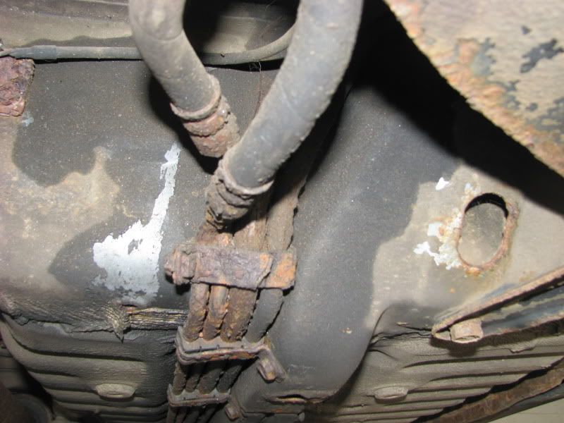

The rear end on the car? I know very few have been through a complete teardown and rotisserie restoration, but what are all your thoughts on welding to resupport the rear section of the frame? from my project build you can tell I've been dealing with a lot of rust, but as seen in this photo which is right above the gas tank, it is pretty bad. I refuse to give up on this car and understand it's going to be a long term goal and a lot of work to get it back to 100% again.
I poked the metal near the hole earlier and a small piece broke free /ubbthreads/images/graemlins/uhh.gif
Just looking for ideas and any sort of path to complete this task, thanks gvr4.org

Damn, that picture makes me sad. /ubbthreads/images/graemlins/frown.gif

Let this picture be a reminder of what happens if you don't clean up after having fun.
Just rinsing the sheetmetal/outside body off won't cut it. You've got to rinse the bottom of your car thoroughly.
If you don't get all the nooks and crannies, your fuel/brake/4 wheel steering hardlines (and other components) under the car will corrode, making underbody service a f***ing nightmare in years to come.
Hardware will break every f***ing time you want to do a simple little job, and just changing something as simple as brake pads and bleeding the brakes can take all day and fill the air with colorfull adjectives.
In addition, the corrosion will eventually set in and attack the unibody itself, leading to the problems raptorreed is now facing.

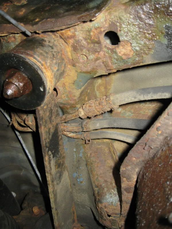

4WS pump, pretty much what my pump looked like. The actual pump sending unit cover is NOT going to come off.
The driveshaft is in crap shape. I have one off a 90' talon in better shape just needs a galant center section. I have thought about just picking up another car to transfer my project to, but I would really want to restore this car knowing it will cost a great amount of time trying to tackle the cancer.

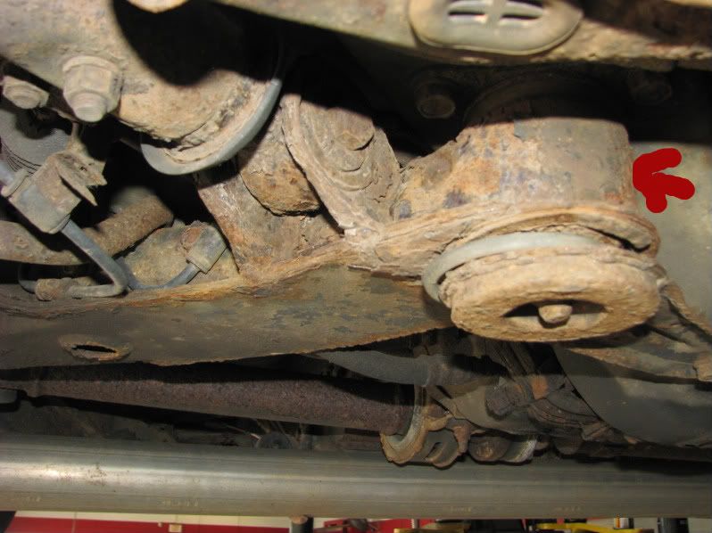

Looking at old pics I have it looks as though the frame all around the fuel tank is what has the worst condition of everything
Old original rear subframe - Arrow points to location of where the crack was

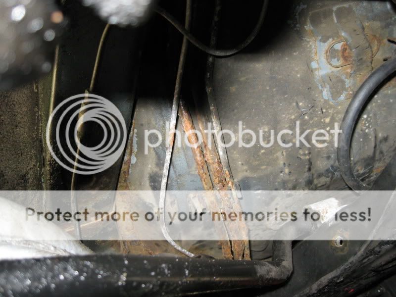

If you need a visual of what toybreaker means what can happen to the 4WS lines and pump, here you go
This is going to suck!
