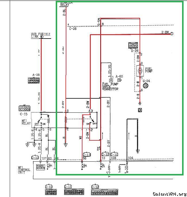

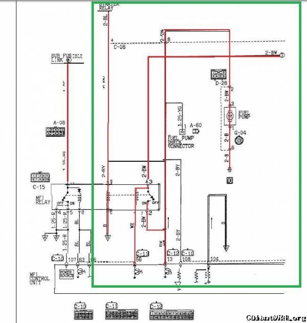

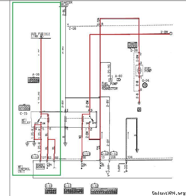

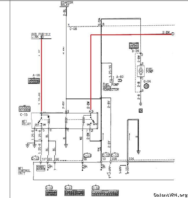

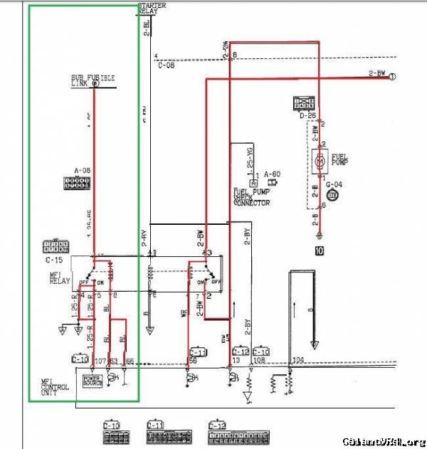

Basically, the MPI relay consists of two relays. We'll call them relays 1 and 2.
Relay 1 would be powered by the starter circuit (during cranking) or the ECU after the car is running. This relay can provide power to the fuel pump in either of these conditions.
Relay 2 would be powered once certain conditions are seen by the ECU. This relay provides the main power source to the ECU and peripherals.
I your case, you're mostly concerned with relay 1, which provides power to the fuel pump.
Power supplied in:
Key in the START position. The green box indicates the relay 1 side of the circuit. This is the circuit you'll be most concerned with:
Engine running. In this diagram, the green box indicates the relay 2 side of the circuit:
My advice would be to trace the harness in various places of the circuit. I'd start by checking for power at the MPI relay, and work my way back toward the fuel pump until I found something funny. I'd also do my tests tests with the key in the ON position, and see where there is power where there shouldn't be. If the fuel pump is running with the ignition in the ON position (engine off and not cranking), it's getting power from somewhere it shouldn't be. That could be the ECU, a short to power, a stuck relay, etc. It's going to take some prodding around on your part to find out what that is. Bottom line, there has to be a place where the pump is receiving power when it shouldn't be.
Keep in mind, there's a lot more going on in the circuits above than I have traced out. I just tried to give you a quick overview without going too in depth. What I've drawn out doesn't give a clear picture of the order of operations, so try not to interpret it that way. Just concentrate on what could be powering the fuel pump when it's not supposed to receive power. I feel like It's hard to convey logical electrical troubleshooting advice over the internet, so, I hope this makes sense to you. Good luck.
