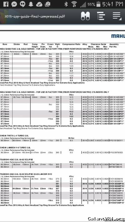

Evo head volume - 43cc
2G head volume -- 47cc
1G head volume -- 49cc
So when you say "2g/evo 9:1 stroker pistons" which is it 9:1 on a 2g or 9:1 on an evo.
Just something to think about before you start it up.
tektic
Dec 19, 2012
1,498
ronkonkoma, ny
I agree that the 1g heads were 47cc also.
I ran the numbers with a calculator
Bore: 85.5mm .02" over
Stroke: 88mm
HG Bore: 86.3mm Mitsubishi MLS
HG Thickness: 1.3 Mitsubishi MLS
Piston Dome: -10cc
Head volume: 43cc / 47cc
Comp Ratio: 8.82:1 / 9.33:1
Obviously if your head and block have been resurfaced it's higher, and also if your more than .02 over or running over sized valves.
I wish someone brought all that to my attention. Assuming a 47cc head my last engine specs out to 9.58:1. However I have 1mm over valves and both the block and head have been cut.
I'm using a 86mm piston with a -9cc dome and 94mm stroke. I should cc my head before I put it back together.
