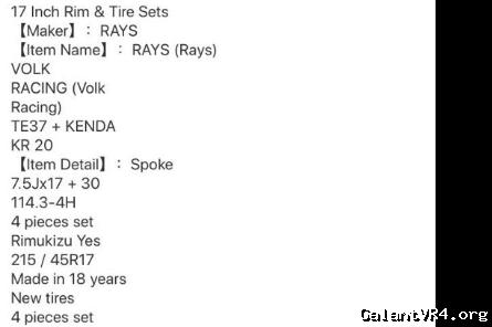

I have just gotten a 92 Galant VR4 #508/1000 and as of now she has snow tires and some other wheels, i am replacing them with the Volk TE37 White Wheels and was wondering what Coils to get for a good fitment, and what spacers i should get because when putting the wheels on, they barely nick the brake calipers because i replaced the original with the 3000gt vr4 brakes. Any help is appreciated, thank you!

What size wheel, including offset, do you have?

Thank you for your response! So i bought these and imported them from Japan and heres the snippet of the size and offset.
