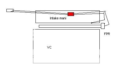

Sorry for my paint skills lol but this is what I came up with.
When I by run the hose straight from the nipple to the fpr, do I need to cap the line on that connector?(red square)

The mid connector you speak of is just a hardline attached to the intake manifold support. No you don't have to cap anything off on the mani support if you remove all the lines. Are you running an aftermarket FPR? If not, I'm not sure what taking the FPS out will do.

Just to clean up the bay. I'm gonna be gettng rid of the other vac lines. I might just keep the fps. Thanks for clearng uP the hard lines.
