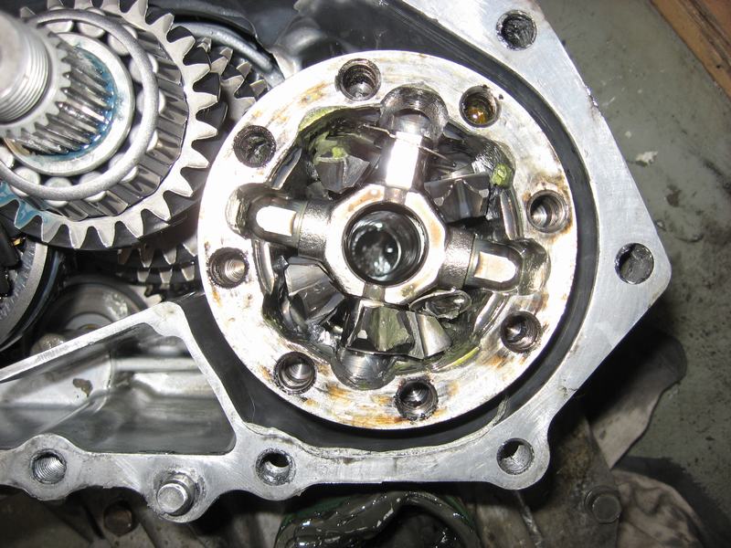

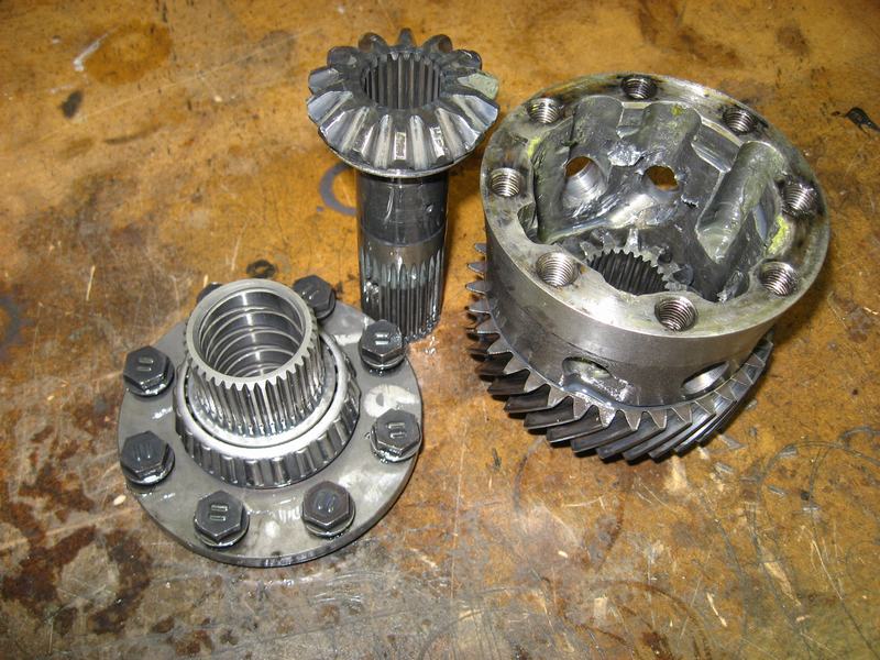

been a while from the last update.
this one is due to the car going between 2wd and 4wd at the last drag meet on the 6th jan.

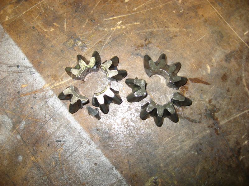

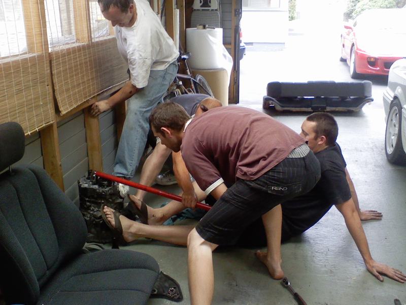

pulled box out about 3 weeks ago and after a bit of raw manpower got the center diff out.
the two spider gears were both broken into 4-5 bits each and luckly we were able to reconstruct most of them both out of the bits still in the housing.
the box looked pretty clean on the inside so im hoping not too much damage was done to the internals as it has only done 4500km scince a full rebuild.
the reason i feel that it was going from rwd to 4wd and back again was that because the bits of gear were still pretty much intact they were getting caught up and basically locking the center diff solid.
when it was locked solid it wemt back to 4wd then they would free themselves and it would go rwd.
just heard back from the workshop the box is all apart and there is some damage on the pin wheel, weather this was from the debris floating round or something else im not too sure as i will go down and look at the box tomorrow.

11,982
One guy is barefoot and another is wearing flip flops while working on a transmission. /ubbthreads/images/graemlins/rofl.gif
H05TYL
Jun 9, 2007
752
Wgtn, NZ
are you laughing at our patented safety shoes? /ubbthreads/images/graemlins/bawling.gif
