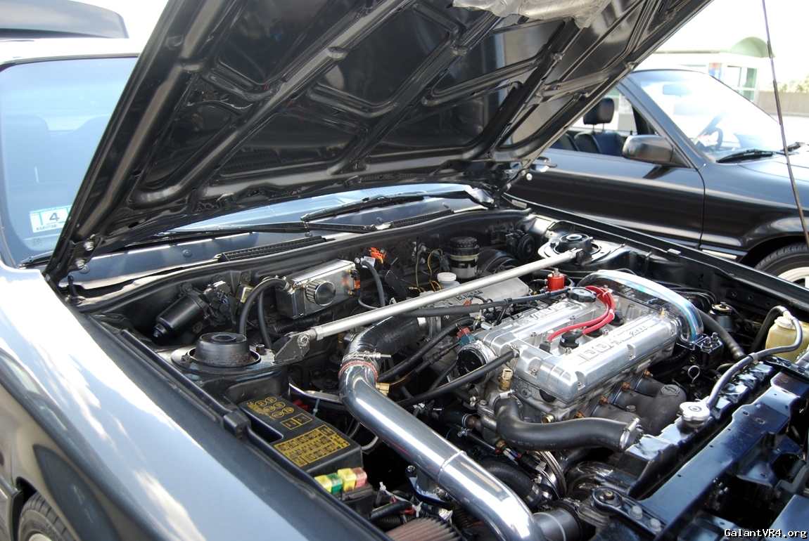

*Owner: Clint Cooper Location: Raynham, MA, USA Message Board Name: VR4coop Year: 1991 * Number: 222/2000 1/4 mile: 12.8 @ 110 mph on 93 pump gas Video of run HP: 324 TQ: 356 @ 19psi*
ALL OLD INFORMATION WILL BE UPDATED SOON
Motor Rebuilt at 150,706 miles
MODS
Performance

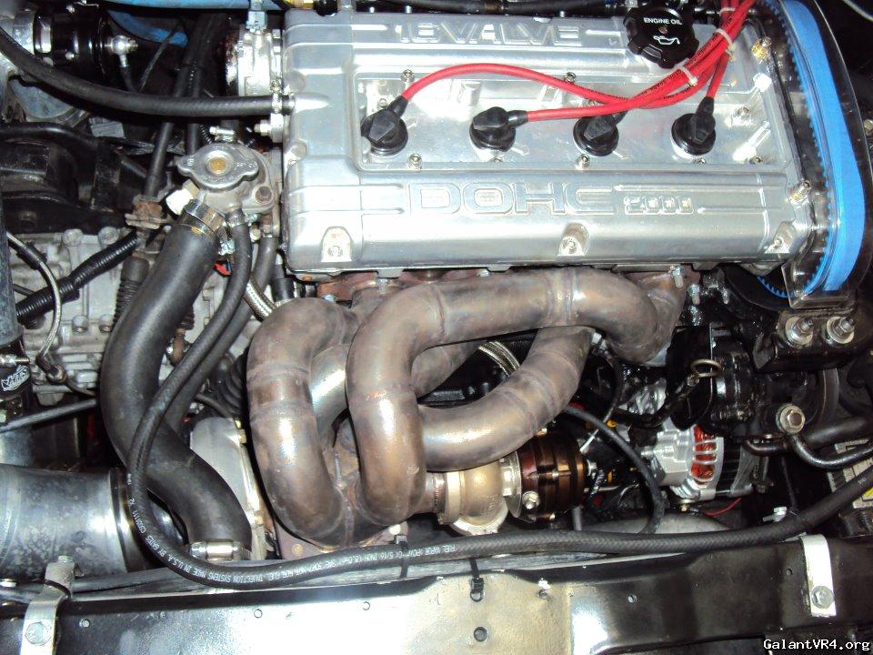

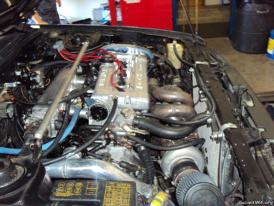

-Engine-Exhaust-Turbo

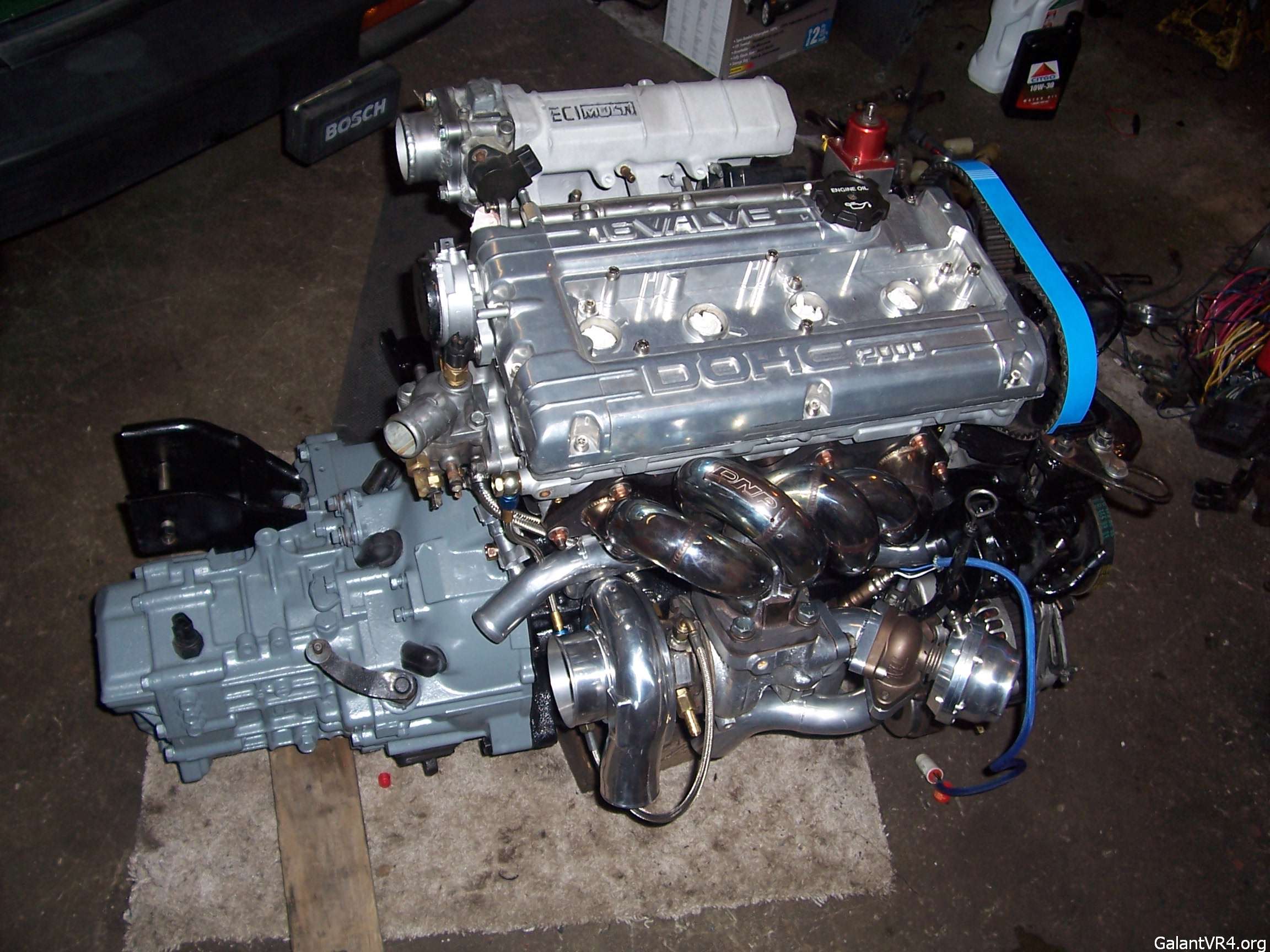

Rebuilt Motor
Wiseco 9:1's .020 over
Eagle H beam Rods
All ARP hardware
Topline Gasket set
Power Enterprises Timing Belt
Balance shafts eliminated
Re-Freshed Head w/ Extreme Motorsports Lifters
FP Exhaust Manifold
Victory Performance 2.5 o2 housing with 38mm Tial external dump
Tial 38mm external wastegate
3.0 Downpipe back exhaust and magnaflow muffler
SlowBoy Racing GT12 turbo
SBR Turbo Oil Return Line (Leaks like a bitch)
Alky Control Water Injection 50/50 meth/water with M15 nozzle
Indy Core 24x12x3 Intercooler core 2.5in Alum piping
Zaklee Corp Clear timing belt cover
-Air-Fuel-Transmission-Suspension-Brakes-
4-bolt no 4WS
2g hacked MAF w/ K&N
Homemade 3inch intake w/ BOV recirculated
Removed All Emission
Forge Motorsports BOV
Walbro 255 pump Rewired
SX/BR Adj Fuel Pressure Reg.(37.5psi base)
FIC 850cc Injectors
ACT 2600
ACT XACT Lightened Flywheel
Mofagus Short Shifter

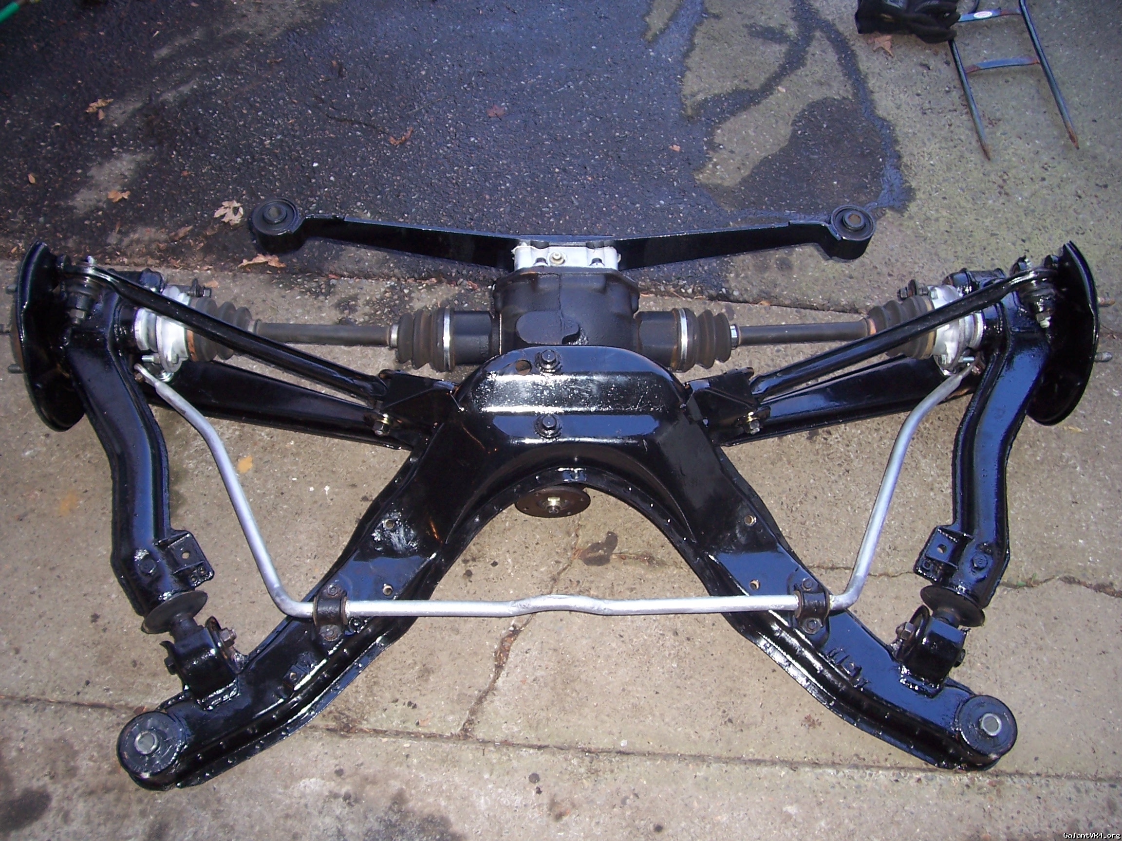

KYB Agx's Front GR2's Rear
Ground Control Coilovers 450lb spring rate. F/R
Greddy Front Strut Brace
Cross Drilled and Slotted rotors
Catch Can
Accel Wires
NGK plugs BPR7ES gapped to .026"
-Electronics-
DsmLink
Autometer Phantom Boost and Oil Pressure Gauge
Greddy Profec B EBC (Old School version)
Odyssey PC680 Battery w/JM Fabriactions Tray
-Interior-
OEM 1g Leather shift knob
Momo Corse steering Wheel
Sparco Pedals
Alpine CDA-9813 Deck
Polk 6 1/2 in doors
The Wedge Bar camera mount
-Exterior-
2002 Isuzu Trooper Anthracite Pearl Metallic Paint
1993 Galant LS front bumper ( No Fog Light Holes )
30% tint in the front 20% in the rear
De badged
Shaved trunk lock
Shaved Antenna
Velox 18x7.5 VX-8's w/ Sumitomo 225/40/18's (40mm Offset)
JDM Clear Corner Lights
Performance Cafe' HID's
Rear Bumper support removed
LED front Bumper lights
-Custom Stuff-
Front Grille
3in Intake
I/C piping
