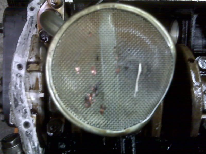

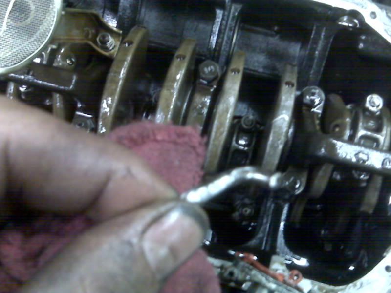

well i had a few minutes at the shop so i did a little investigating.
yeah thats bearing material.
WTF is this?

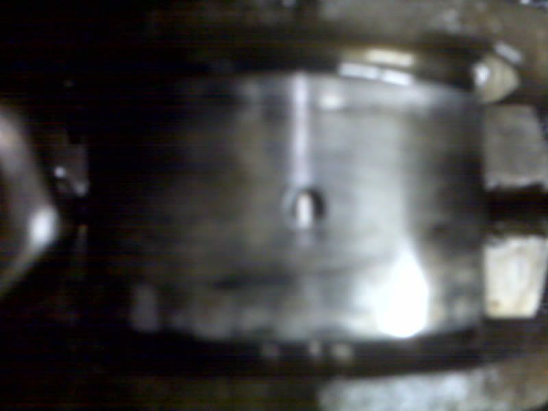

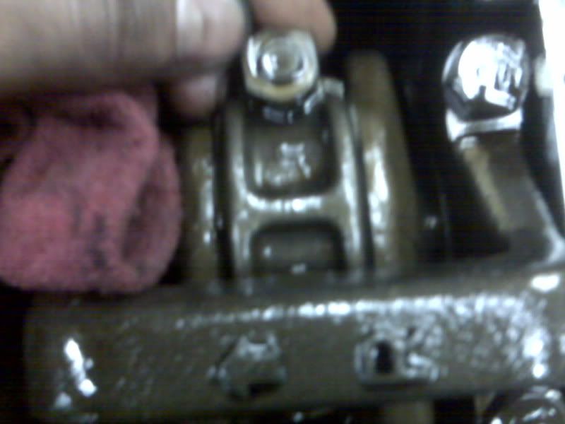

thats my number 4 rod cap. you cant see, but i assure you there is way, way to much play in it. im saving that cap for last.

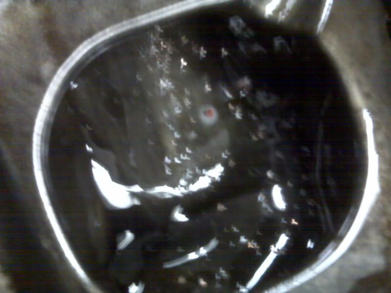

i just popped off a random cap, number 3 and this is the top side of the bearing, facing the cap. :TD:
but the pistons look brand new, and the walls look great from what i could see.

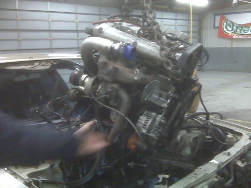

this is what i have to toat around in for the next few weeks.

Is that "bar" an oil squirter part?
Kevin was missing 2 of the 4 little tubes when we took his old motor apart. Never did find those little bastards.

Quoting Terry Posten:
Yep, that's exactly what it is. Common on 2.3L+ stroker builds if the squirters are not bent or replaced with EBO models.
Bummer about the scrapnel, hope you get back on the road soon!

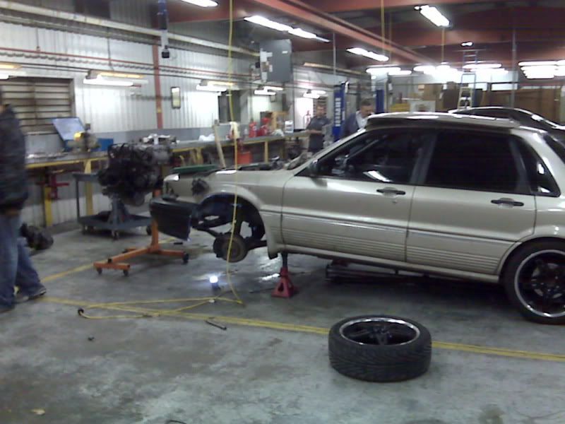

im working out of the Fort Leonard Wood mwr auto craft shop, a good friend of mine manages it and my brother is a mechanic there, so im there alot also.
i believe it is a oil squirter unfortunatly, i think its just rod bearing faliure. but time to go bigger and better.

i tore the motor down, and all the bearings were fine, except the numbe 2 rod bearing. it was TOAST. It scored my crankshaft, so im on the hunt for a new crank and rod. or just a running 6 bolt bottom end.
