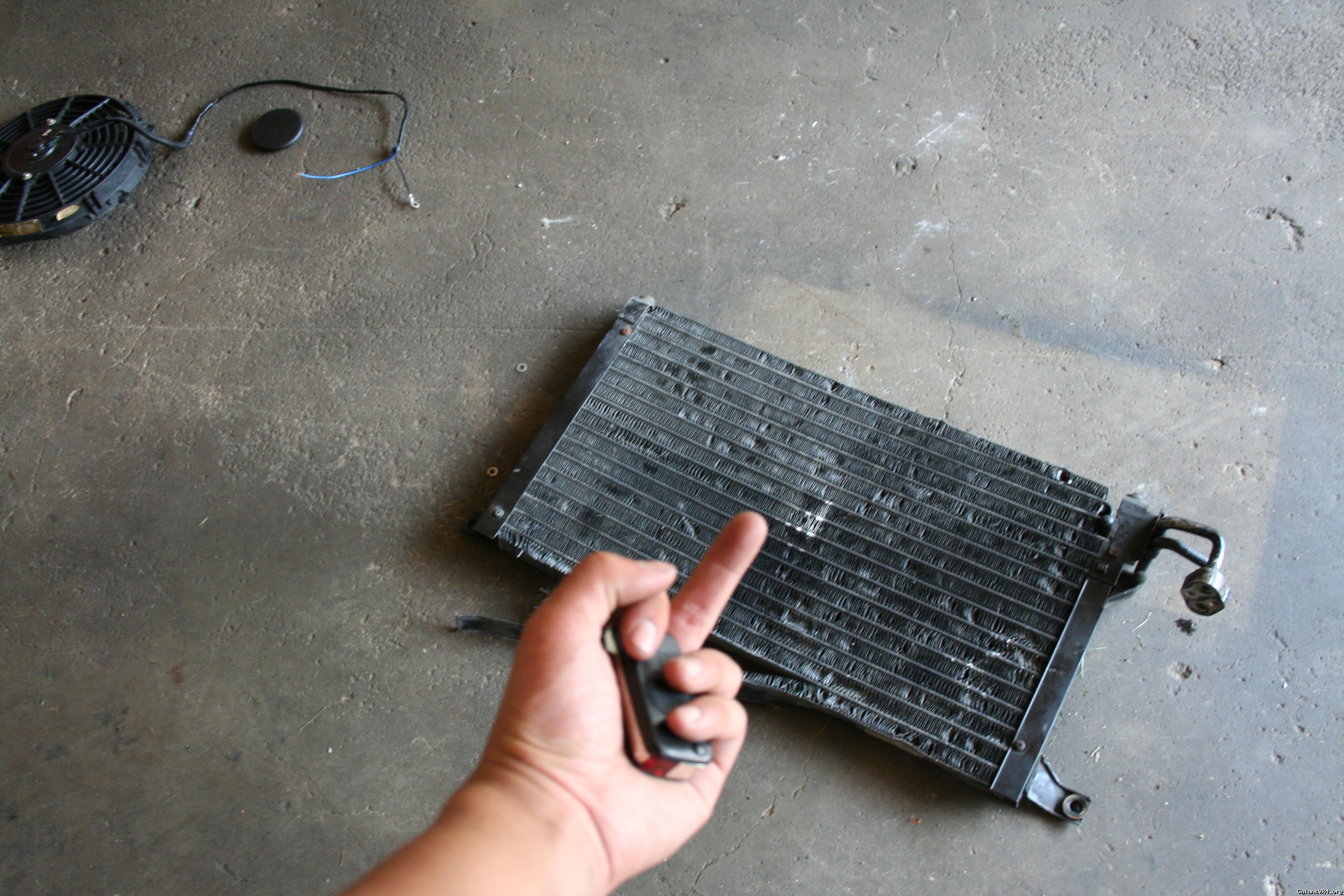

After 46/1000 struggling with creeping temps constantly, I looked to the local forum for help. People told me that the intercooler and radiator weren't getting enough airflow due to the useless condensor that was in the way. An hour or so later and a bunch of curse words later... I ended up with this.

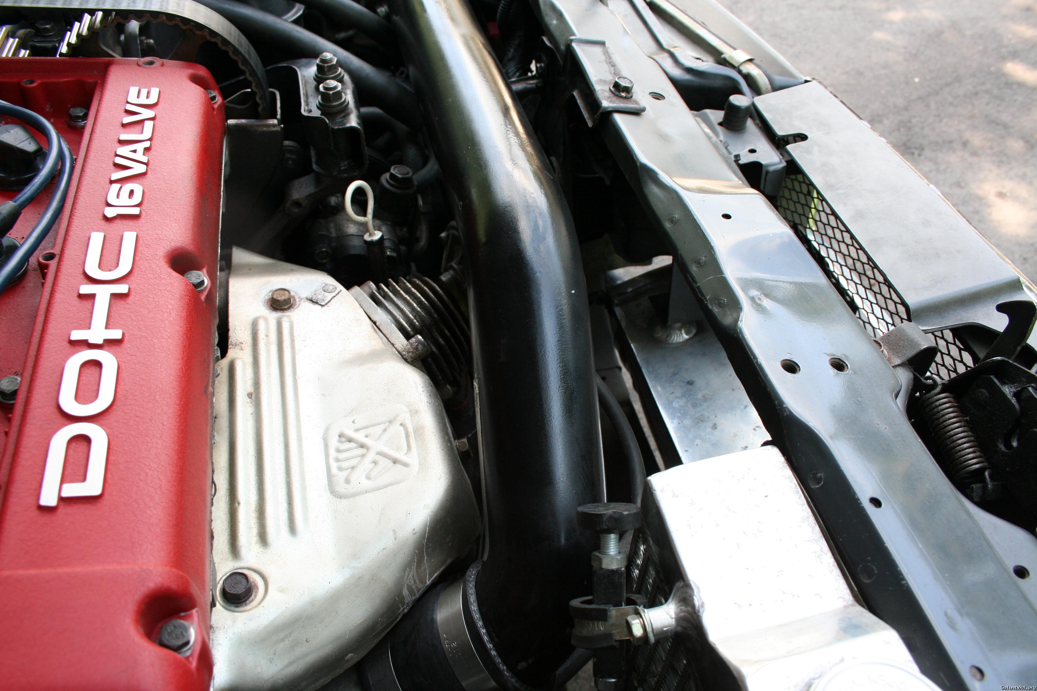

All that precious airflow was blocked by this. If you guys are thinking of running a civic half radiator, they work great, provided this piece of Sh*t is removed.
Then I idled the car for literally 45 minutes after a spirited drive to see if the temperature would creep up. Nothing. Just right below the middle mark. The car drove much better at lower temp as well. Delete AC and be done with it!

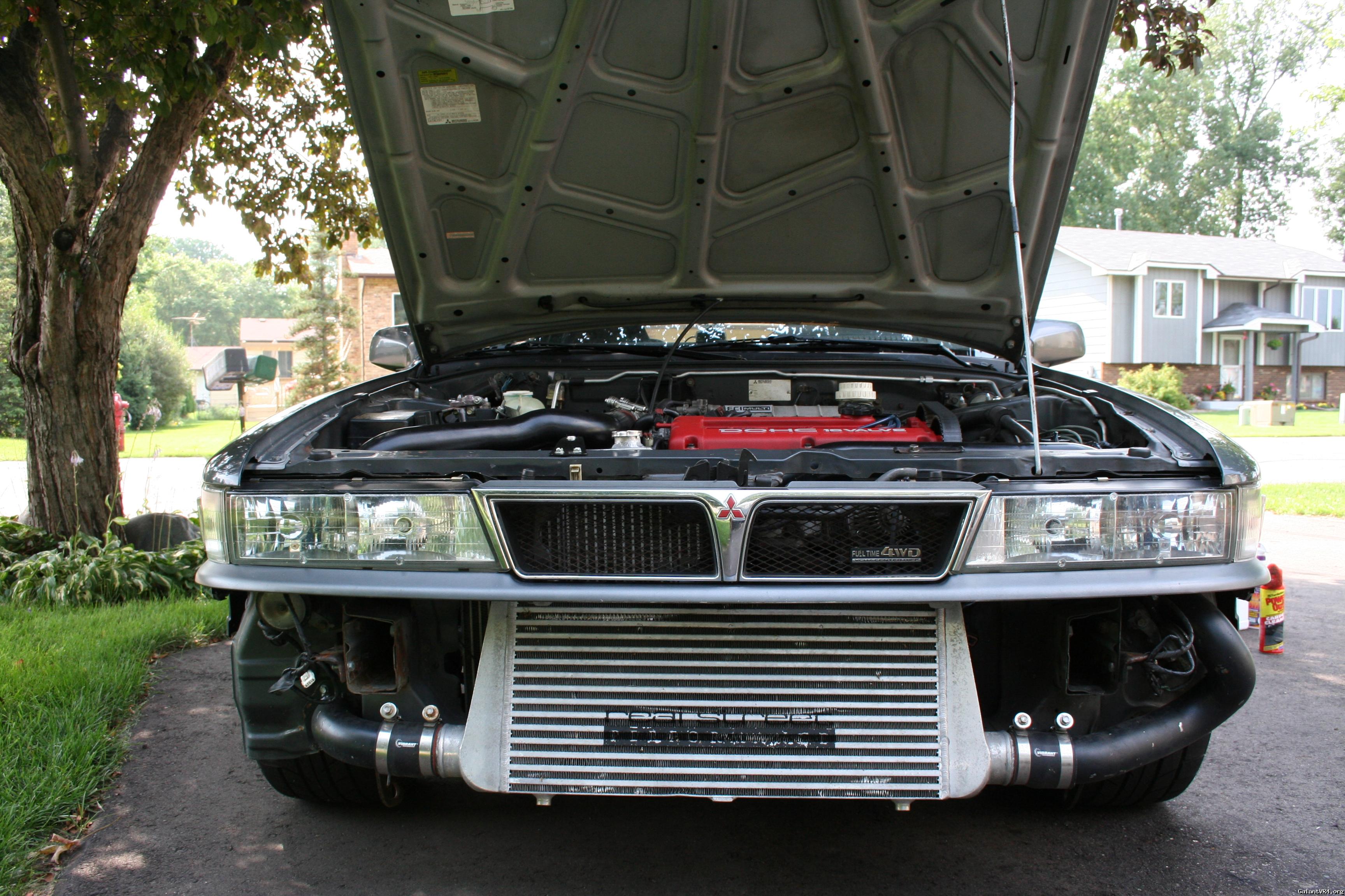

Look at all that extra airflow! /ubbthreads/images/graemlins/worthy.gif
