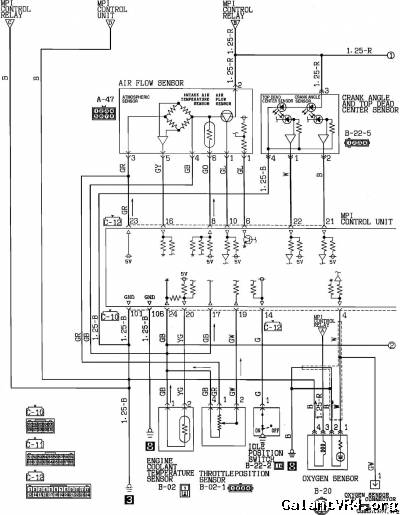

Your coolant temp sensor isn't sending proper signal to the ECU. I can almost guarantee it. This is exactly how my car behaved when i had forgotten to plug the CTS in after doing some work to it a few months ago. I would suggest if you do not have dsmlink or a logger, check the continuity of the wires from the CTS plug to the ECU.

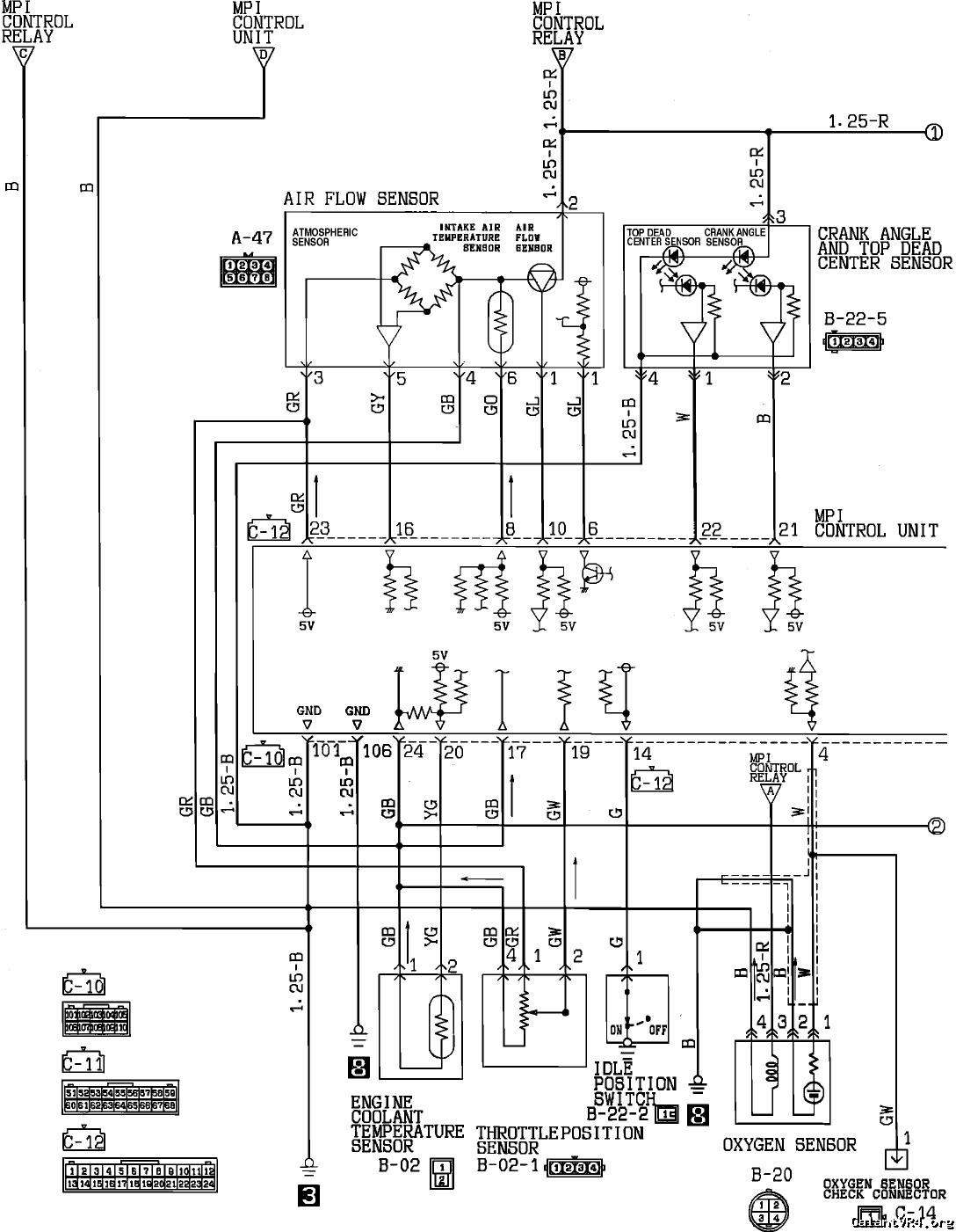

i cant tell from the wires, but it looks like the CTS wires are mixed up pretty bad. try switching the yellow/green with the other yellow/green and see if it works. also you might need to swap the connector locations. the wires are to clustered together for me to tell just from the picture. you'd need to separate them and show me the exact two wires going there. also you shouldn't use tape like that. go get wire connectors and wire loom and cap off any wires your not using. also get waterproof female ends to go on the CTS so nothing shorts out. tube of dielectric grease as well.

You need to see what is being shown as the coolant temp by the ECU. I believe if it's not hooked up right or not getting proper signal, it will default to some insanely low temperature. Of course, if the temp were actually this low, your car would probably run a little, until it warmed up and got further from the reported temperature.
The blue wire doesn't go to the gauge. It goes to the A/C system. The single spade sensor in the front of the water neck is for your gauge. I dont recall the wire color for that one.
It shouldnt matter how the wires are connected to the ECU CTS, because the sensor simply gives a resistance value between the two contacts.

one y/g goes to the bottom part of the T the other y/g goes to the broken off one next to the CTS. the other Y/G is the dash gauge. the one in the back is the blue wire. its an open circuit till the coolant reaches a certain temp then becomes a ground and turns the fans on. yes its for the a/c, but in my mind having it is also kind of a fail safe for the fan temp sensor in the rad.
yes it matters what wire goes where on the CTS it matters a lot.

i just went and swapped mine, your right. it doesnt matter. ive just always gone by the manual and i thought it would run different. not sure on how it would run once warm though.
