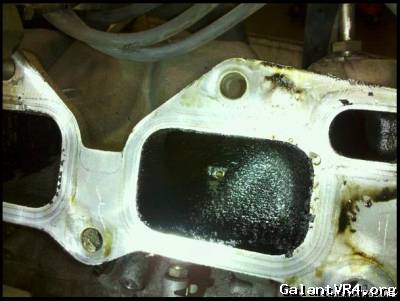

so after a long time of my car just sitting waiting for me to get to it, it turns out i had 0 compression in cyl. 3 and low compression in the others. my exhaust manifold looks like it got hit with a 8.9 earthquake. my knock sensor is melted, and my intake runners have a good centimeter of black crap in them. my turbo is good tho =). i got a good deal on a freshly rebuilt engine, so in with the new and out with the old
