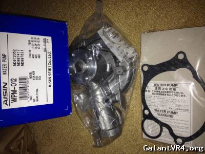

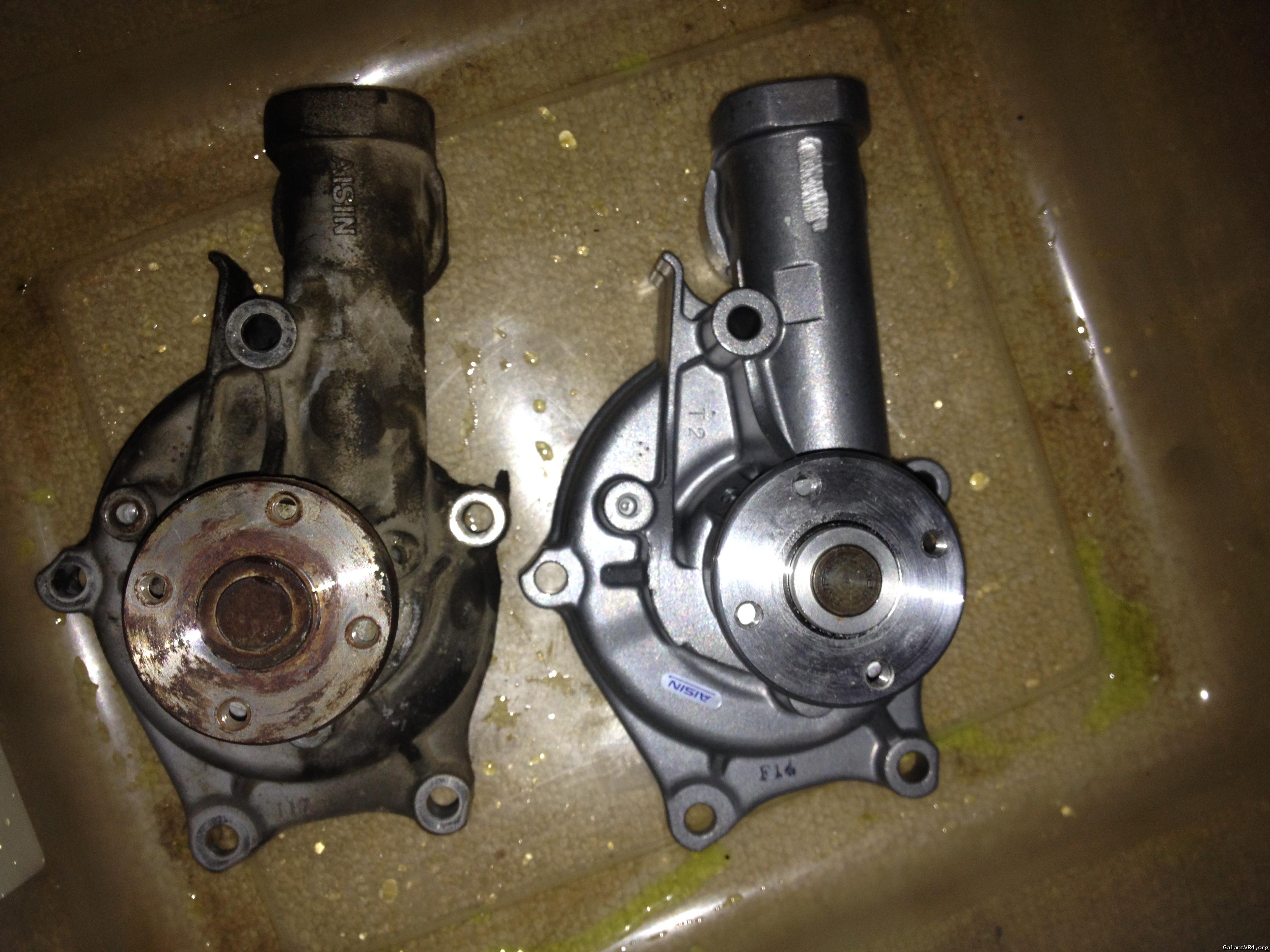

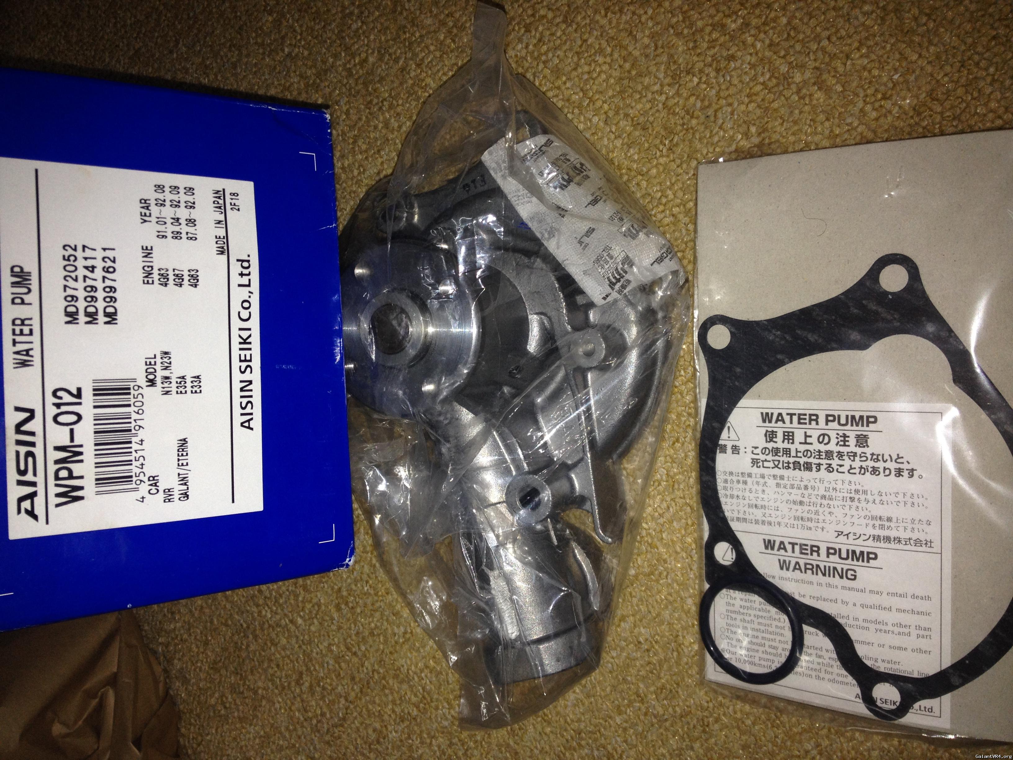

Correct me if I am wrong. I think the oem one made by AISIN from Japan model# WPM-012. I sow it on ebay and it is half price of the oem from local dealer.
