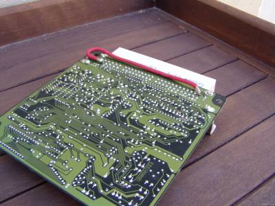

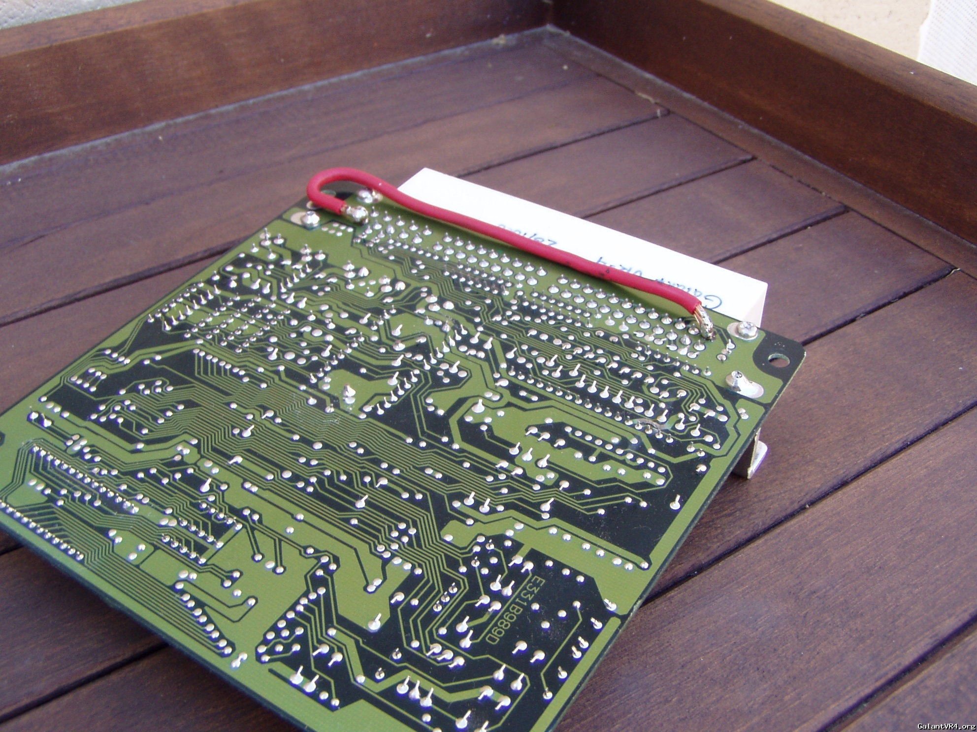

Alright, i fixed up some wiring and the car starts and runs great /ubbthreads/images/graemlins/smile.gif but I am hearing a strange electronic clicking noise coming from the area where the ecu and MFI relay are. I checked the MFI relay out of the car with jumper wires like it shows in the manual and it tested out fine. But it does sound kind of like relays clicking real fast all most a buzzing sound, could this be the ecu? I just had it capped and looked over by Terry so I'm really thinking its not the source. I dunno maybe i'm just being paranoiod because my car just randomly died and wouldn't start the other day when it was running great /ubbthreads/images/graemlins/confused.gif.

I had a weird clicking noise when my ground circuit got damaged (in the ECU), after my MAS mishap....Thanks to Jeff (keydiver), I made a temporary jumper [see pic] and Terry later fixed it...Not sure if this is the problem, but they'd be better to tell you:
