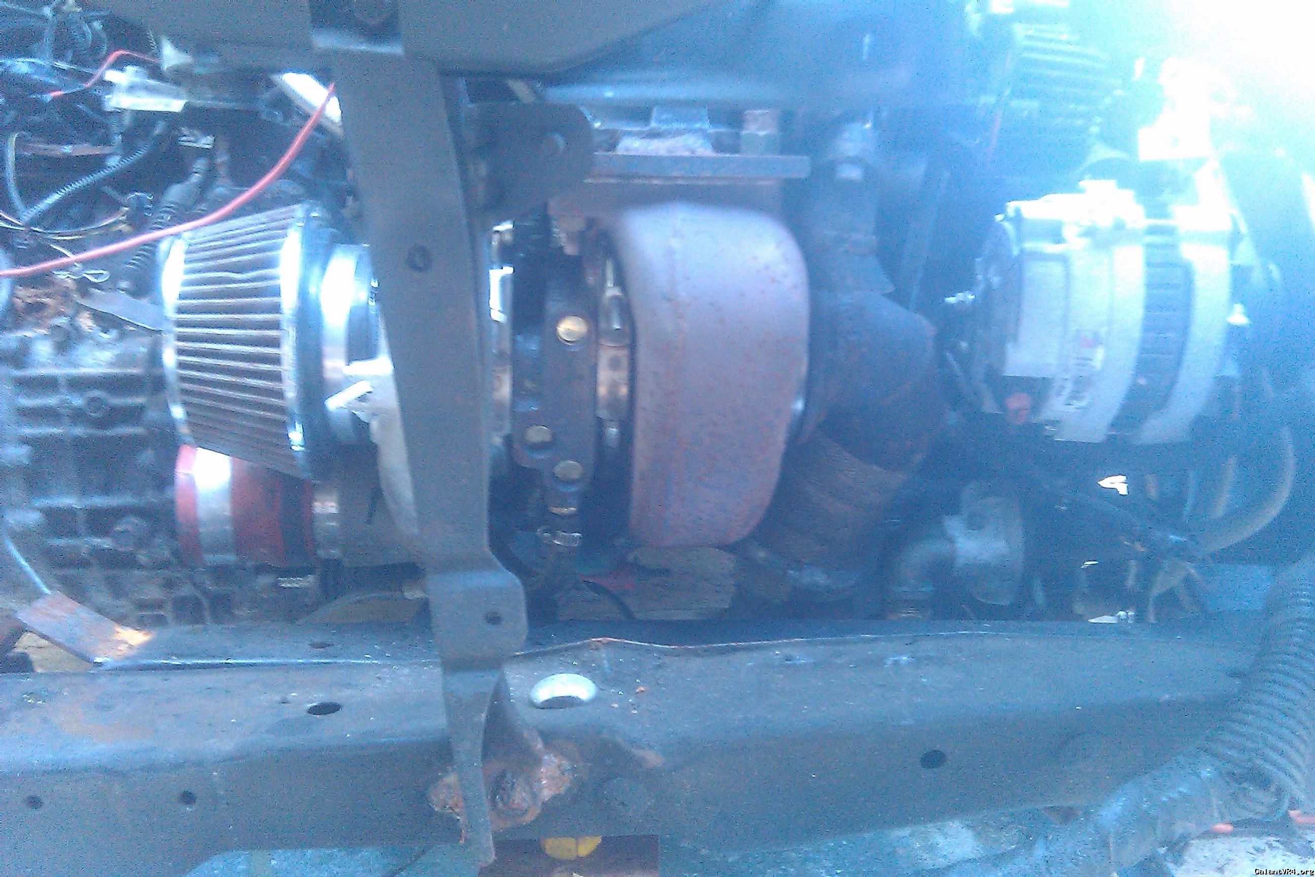

I wonder how much fab work will be needed to mount one of these big over size snail.All i can think of is brace brace and more brace.

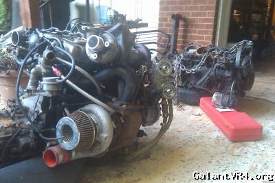

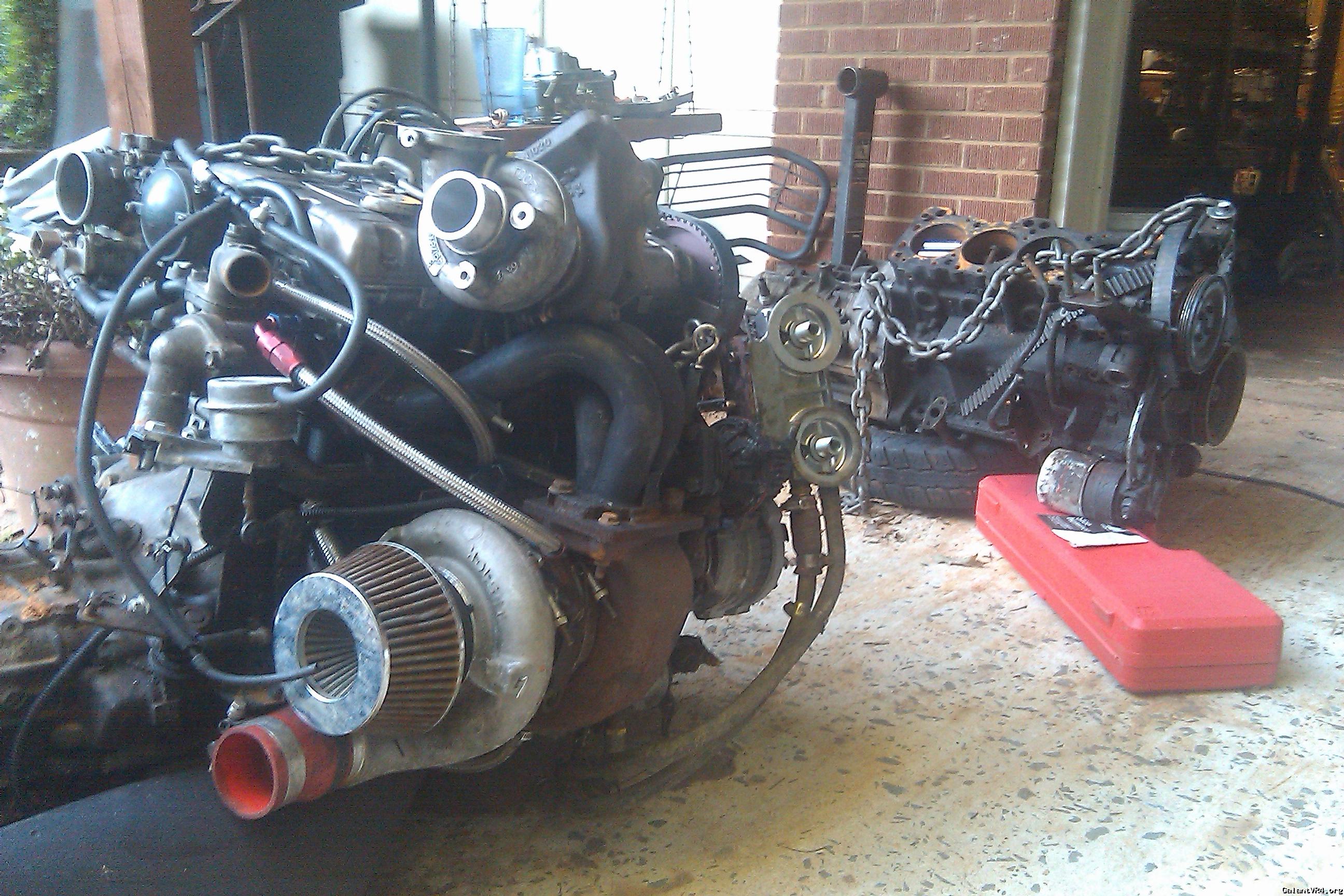

Boostx- Here is mine when it was in my eclipse, same configuration as it sits in my galant /ubbthreads/images/graemlins/smile.gif.

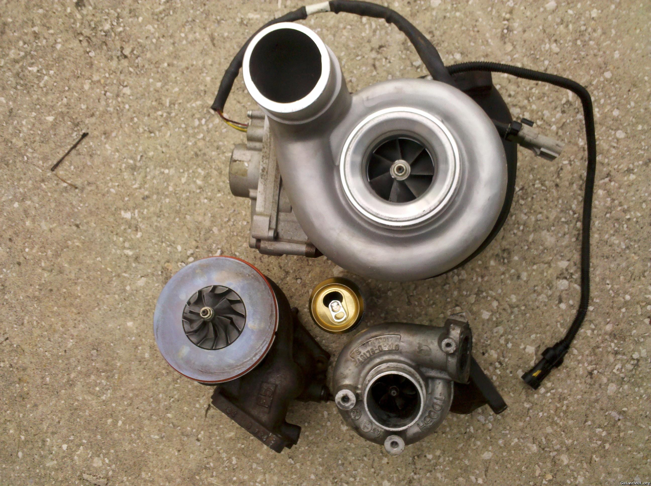

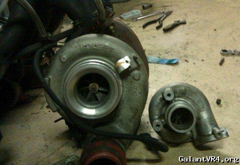

and just for turbo size comparisons....stock vs vgt
Boostx- All of my temperatures are "normal" except my water temp starts to get high when I am just sitting for more than a minute or two. I assume mainly becaust the exhaust housings is almost touching the stock radiator. My IAT's were generally between 80-120 depending on the temp outside if I recall correctly but id have to go back through my logs to verify.

Ok,I thought is would run a bit hot because of the exhaust housing,

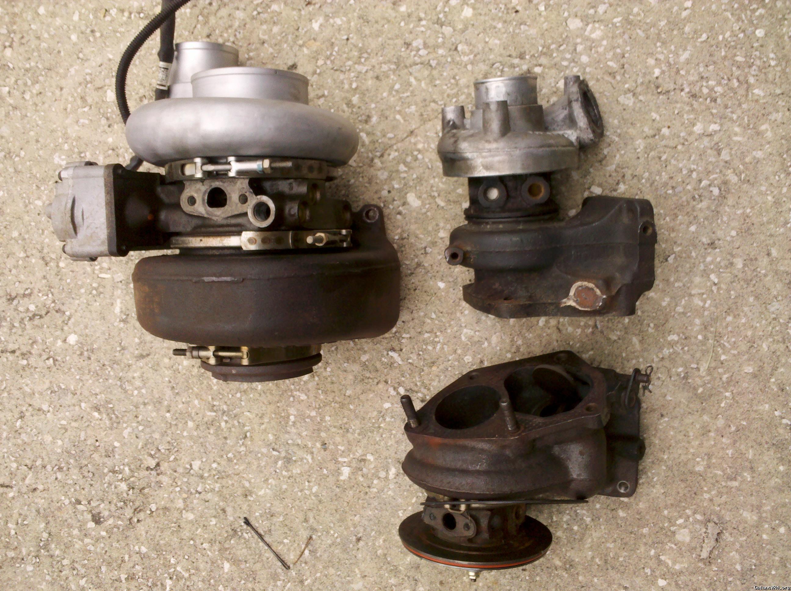

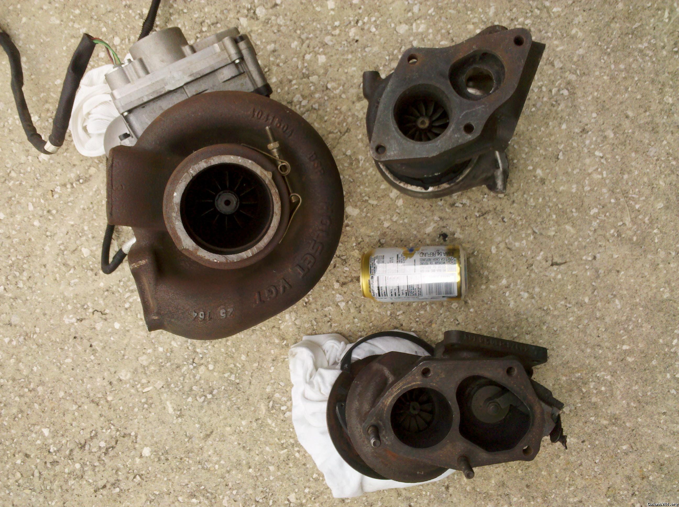

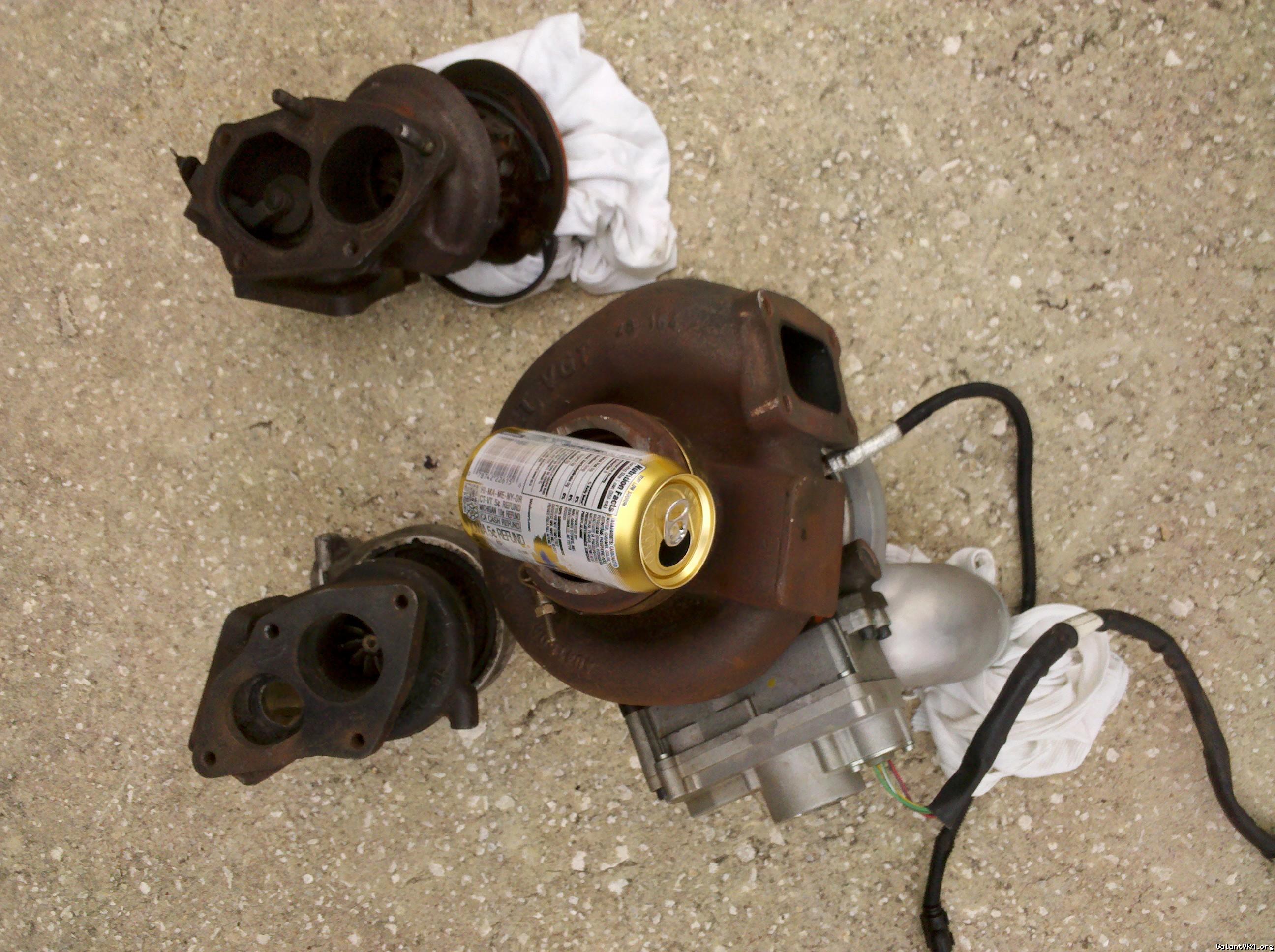

Another size comparisons....stock, evo9 and soda can vs Godzilla
