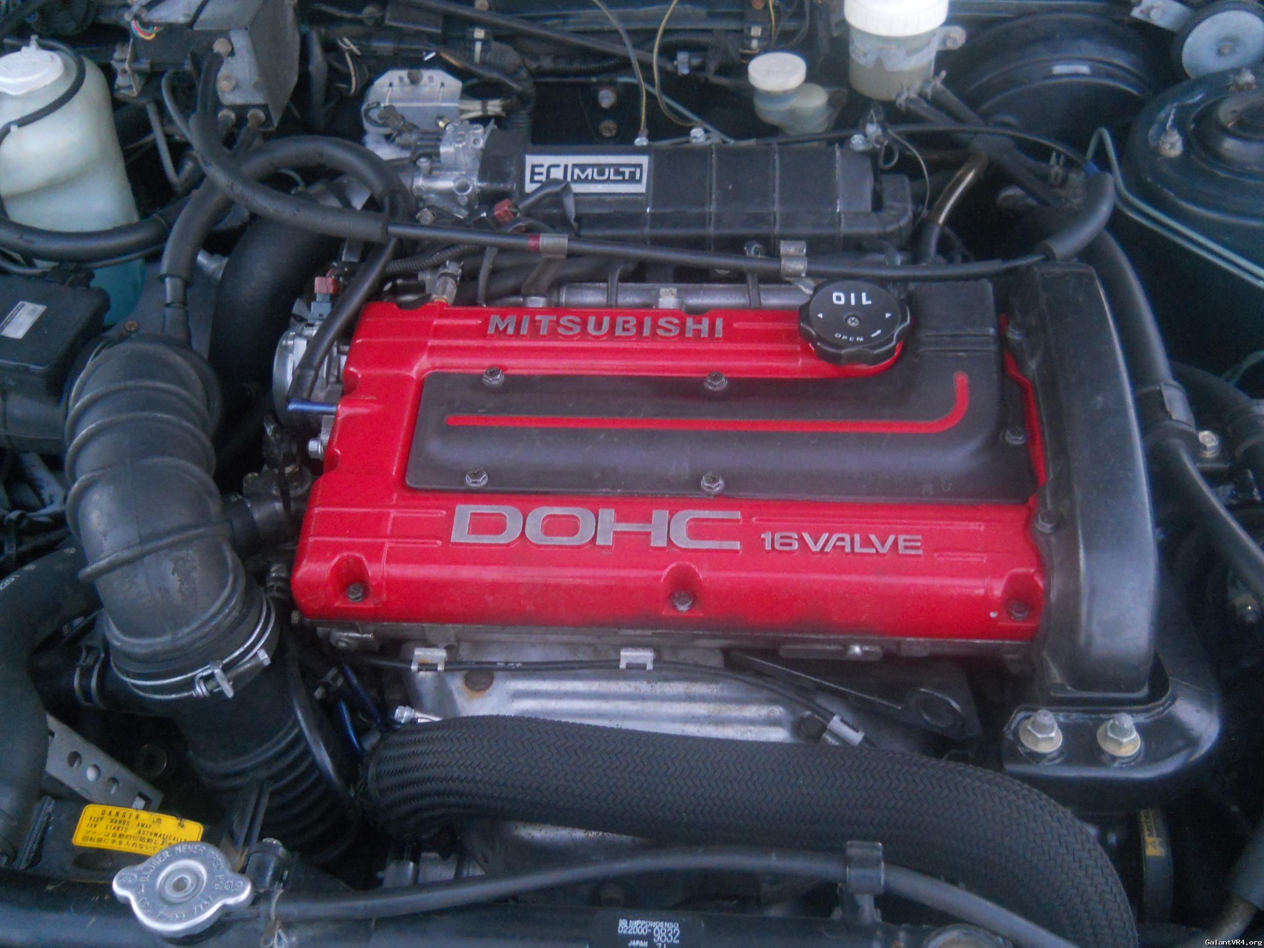

finally getting around to buttoning up the car to start driving it, but one of the last things is painting the valve cover...I liked the original red color and want to stick with that, but I don't recall what shade it was (mine's sanded all down [not shaved]) and the pics I see aren't crisp enough for me to determine the exact shade.
To me, it seems like a 'brighter red', but there is so many different ones. Is there a good engine paint that matches? Currently, I have Ford Red 1200 deg paint, but in doing some test areas, it appears more orangish-red and while it doesn't look bad, debating on using this, or going to a more correct red. I don't want a super-bright red, but at the same time, not sure I like this orange hue.

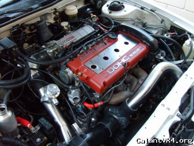

here's a pic of it I just took, showing the 'test color'...it is brushed on with no primer right now, so maybe using a primer will change the hue a little...Kind of hard to tell in the pic, but it is pretty orange /ubbthreads/images/graemlins/frown.gif
10,992

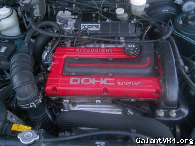

I had mine powder coated a red color I picked from samples. It is called Ruby red. I agree that sometimes the colors used are too orangy for me.

Wasn't suggesting you powder coat, just that that is where I found my color selection.
With the flash, this appears a little more "pink" than it appears to the naked eye in good lighting.

anyway, I like that shade (will take your word for it that it's not pinkish) and IIRC looks pretty close to the oem color. Thanks!

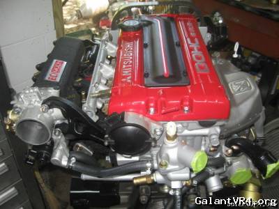

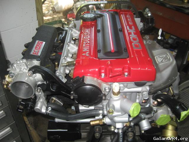

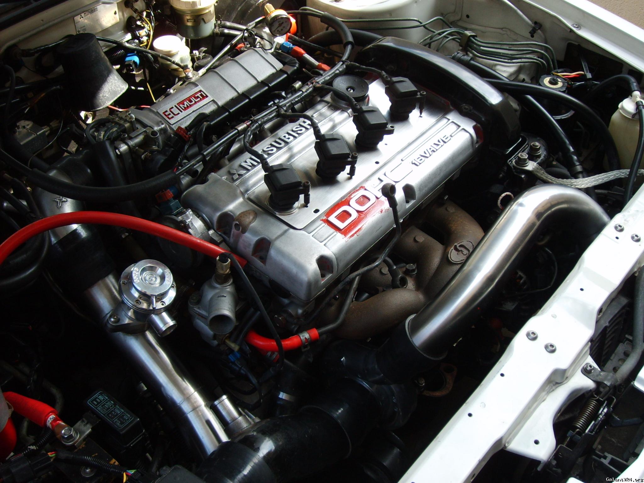

I have painted a ton of parts with Pactra paint made for RC car bodies. It comes in small cans but still plenty for a valve cover. The red I used is a very nice, deep red and its called "racing red". It actually dries to a satin finish since its made to go on the inside of a lexan rc car body so you'll need to shoot some heat resistant clear over the top. If you are planning on sanding or polishing the raised letters I would clear it anyway. Another tip is to sand/polish the letters first and then use some thinner and a rag to remove the paint from the letters while its still wet. You end up with a perfect finish and you don't have to worry about scratching up your new paint trying to sand the letters. Here is a pic of my last valve cover that I painted with this paint. I actually cleared it with automotive clear using a paint gun but you don't have to.

Your work looks real nice and thanks for the tips! I'll look into that stuff also...

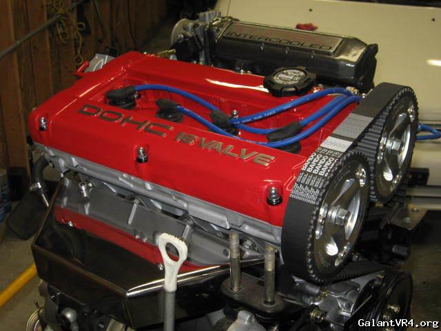

I chose a wrinkle red for mine- i think it turned out pretty nice.

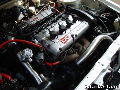

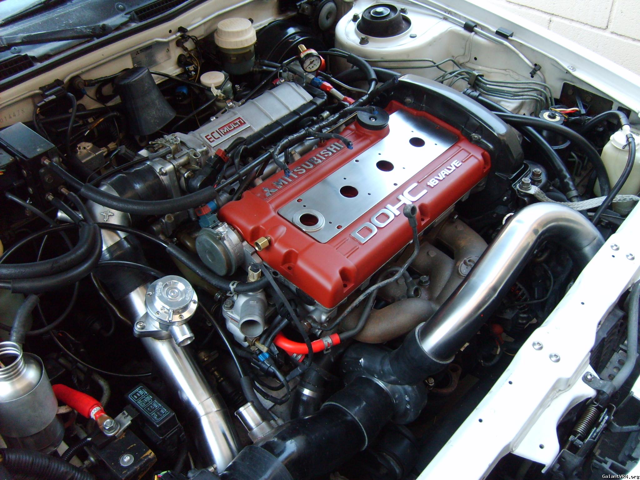

Put a burnt orange primer on it and polished the letters for now to get me some ideas...starting to gear more towards an orangish hue, so maybe I'll see what the Ford Red looks like. Anyhow, an in process pic, although it's not done of course and just a quick pic, so don't mind the dust and webs /ubbthreads/images/graemlins/grin.gif
JNR
Apr 23, 2004
9,839
ca
It started out as an extreme motorsports "prototype", but like the other stuff the PO (Sean Glazar) did, it looked pretty sorry, so I had Chris Beran do all the welds over and added a piece on the top...He did a good job although the 'added' piece was eversoslightly larger than what the pieces I had were, so when I ground/polished those welds, there is a little bump...no biggie as it looks 100X better than what it was...also made a new bracket and BOV flange/riser and relocated it, closing off the orig. location. Also, I bought all new couplers (they were blue) and constant-torque clamps, which are of course not on right now.
Oh yeah, I removed that cheap aluminum TB elbow (it got crushed too easy from the clamps!) and replaced it with a billet TB nipple I made (could've used a N/A TB I found out afterward, lol...that's OK though, the piece came out well and I enjoyed making it) and used the turbonetics elbow I had on the inlet, then added a boss for my water injection nozzle (can't really see it).
Just need to finish polishing the tubes..thinking about doing a brushed finish though. Almost everything you see had to be done by hand /ubbthreads/images/graemlins/frown.gif, but now I have some access to more ways to lessen that work and look even better!
