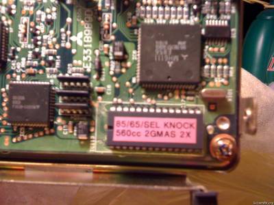

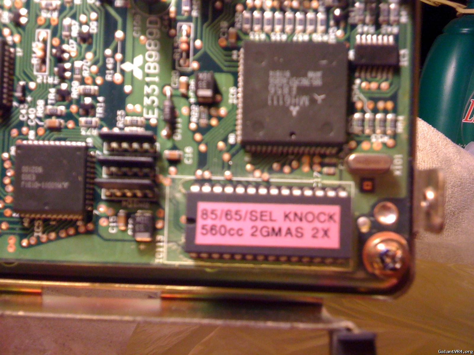

At idle the 2G MAS puts out almost the same Hz signal as a 1G, but your EVO injectors are flowing 30% more fuel than the stockers, so you will be VERY rich at idle. Don't believe what everyone on Tuners tells you.
For years many guys have gotten away with 550's and a 2G MAS, but its just not the same thing with the EVO 560's. Not only do they flow quite a bit more than 550's, typically 585cc or more, but they have LESS deadtime than the factory injectors, which means they inject >30% more fuel at idle. Most 550cc injectors have 180uS more deadtime than stock injectors, which means they flow less fuel at idle than the EVO's.
You could try removing the lower honeycomb, which should help lean out the idle quite a bit. But, the *right* thing to do is get a chip that matches your MAS and injectors, because the other thing the 2G MAS is doing is throwing you way off the timing maps. The 1G maps are already very aggressive, so more timing just means more knock issues.

I bought that chip from one BluFalcon in the FS section. He said it was one of your chips, that he got from someone else on the board, he said it was for a 2g maf, and Evo injectors. "Shane,
I bought this a few years back from another member on the board from his GVR-4.
Here's the info I got from Keydiver about the chip off his message board:
8500 main rev limiter
6500 NLTS
Selectable Stutterbox
Knocksum gauge
EVO 560cc injectors
stock 2G MAS
2X Karman to log double Hz
Since it's a stage 3 chip, it'll have all the stuff that he usually adds to his chips like, octane reset, fuel cut removal and the usual stuff from stages 1-2. More info about what's included in each stage can be found on his site: www.dsmchips.com " thats what he said, so im waiting for it to come in, i think it should be here tmrw. Thanks , If anything I will contact you asap.
