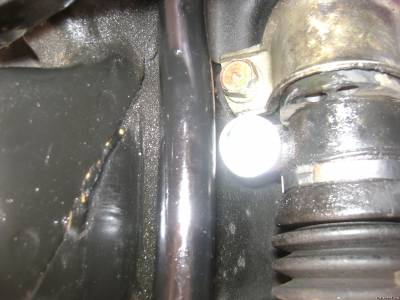

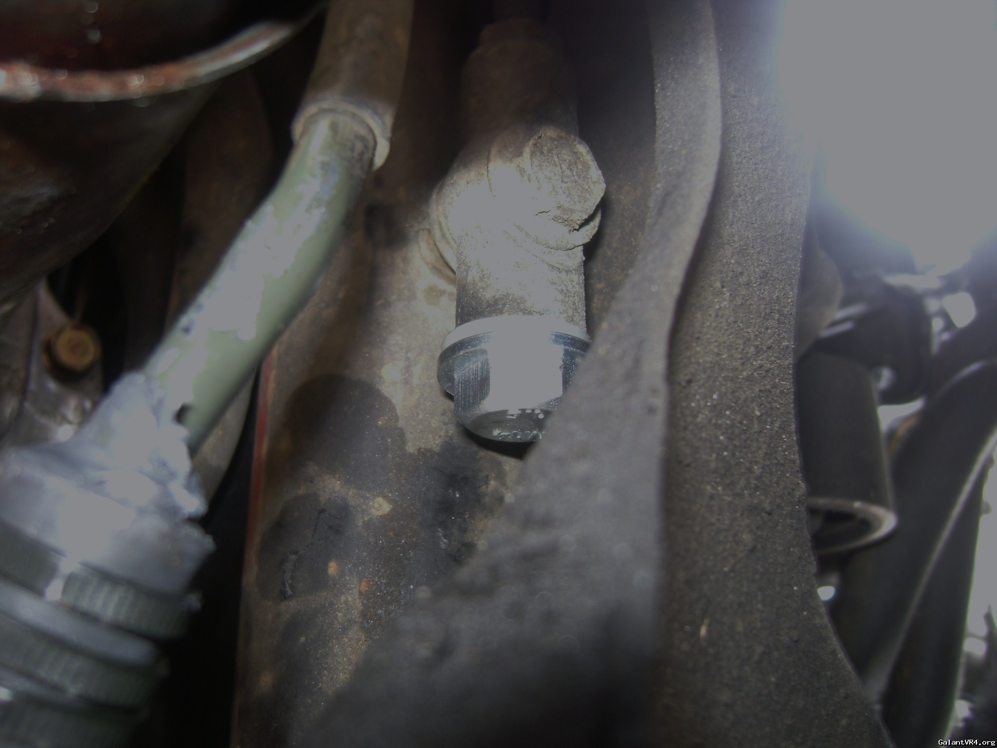

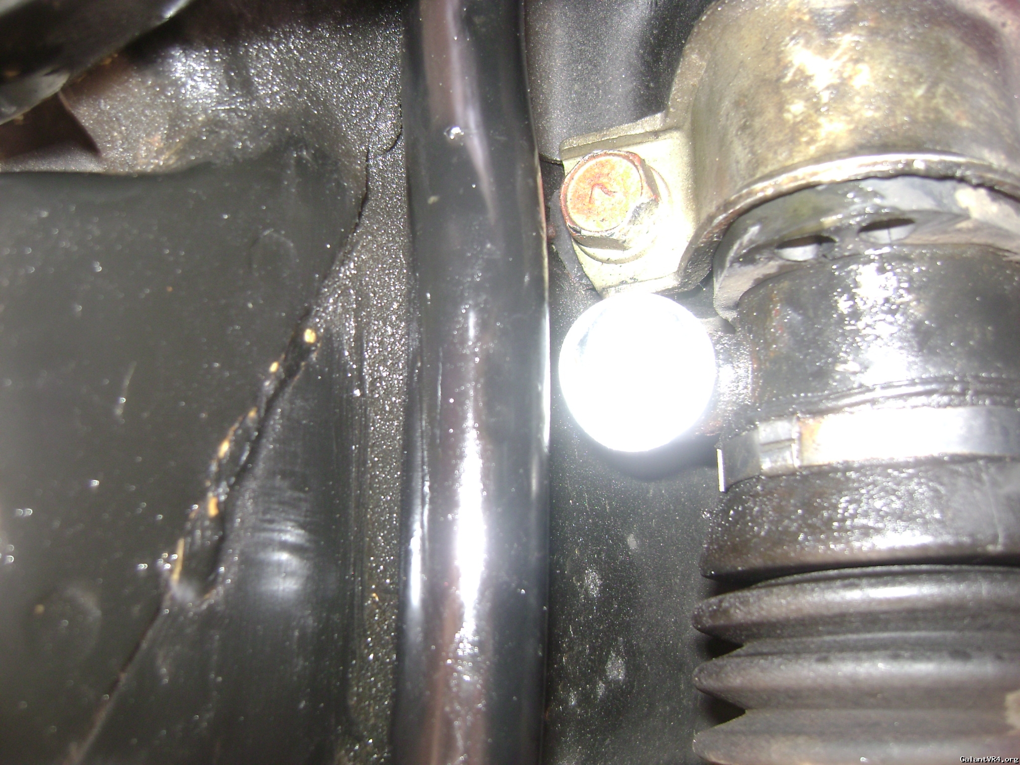

OK, I have the pictures,
This is the standard pic of what I have seen on this site as a main blocking point. I do not beleive this is the problem.
This is the T that I have seen done so no welding needed.

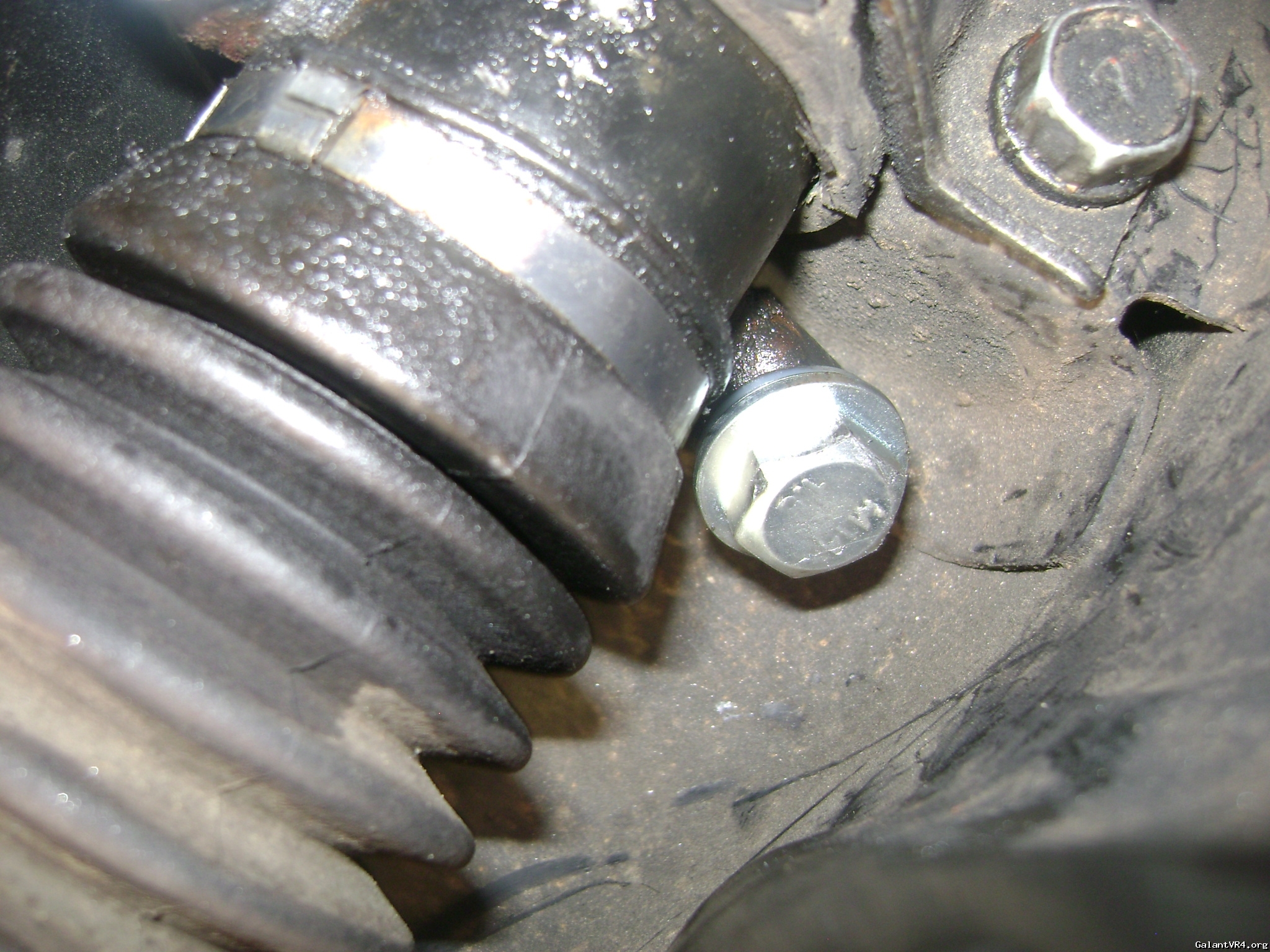

Ok, here is where I block of a line at the boot of the steering rack. THis must be the issue? If you guys think so, I am unsure where it goes back to from that location. I hope I didnt destroy the line either. I destoyed several lines. removing them.
Please advise, I this was al line not to be capped please tell me what to do at this point. THanks in advance.

Is the third picture the driver or passenger side tie rod boot? Looks like you did possibly remove one line too many.
My suggestion:

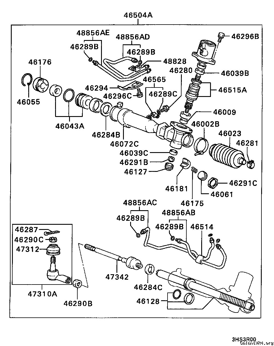

You remove and plug where 48856AE (passenger side of rack) and 48856AD (one side of the joint or "T"). Looks like you may have removed also 48856AC.

I can't really tell by your pictures, but you removed one too many. Removing the "T" one is correct, and removing ONE of the passenger side lines is correct. You should have been able to tell which ones needed to be removed by tracing the lines forward from the rear of the car.

You remove and plug where 48856AE (passenger side of rack) and 48856AD (one side of the joint or "T"). Looks like you may have removed also 48856AC."
Picture 1 and 3 are completely opposite of one another. I should have capped 1 but not 3. I have mangled the line so it looks like I need a new line now. Picture 3 is waas up in there and needs baby hand to get the bolt started. I take it if I run the line back to 3 then I will have power steering to the right. Picture 3 the angle is bad. Alost 45 deg. So you feel that 48856ac is the correct line? I did mangle it. Is that a Mitsu part #?

OK, if picture 3 is on the driver's side, then you will need to find the location on the other end that has on open spot for the fitting on the other end of that line as well.
That is not the part number, but the key #. Part number is MB564864. It is available.
