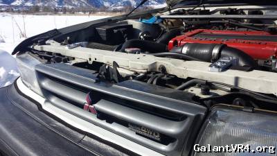

I'll goto the store tomorrow and grab a set of bushings and see if they fit easily. Then i'll post pics. As for the brackets, i'm sure there is something out there that could be made since they are pretty straight forward in the design. Just a flat piece of aluminum with a couple bolt holes and a large hole for a bushing.
Wiz
Wizardawd
Aug 7, 2007
1,323
Franklin, NC
[/url][/img]
[/url][/img]
[/url][/img]
Really need to learn to hold my hand steady when taking pics. But, the bushings are $8.99 plus tax for 4 of them. THey are found under a Fox body (say around a 1990 Mustang GT) for the sway bar link kit. Polyurethane (not in red for this company..poo) and took about 30 seconds each to install. Hog out the old bushing, leaving the metal race. Then, I just tapped the new bushings into place and the radiator definately does not move. I'm gonna get them to fit a little further in, this was just a quick throw together I did at the parts store.

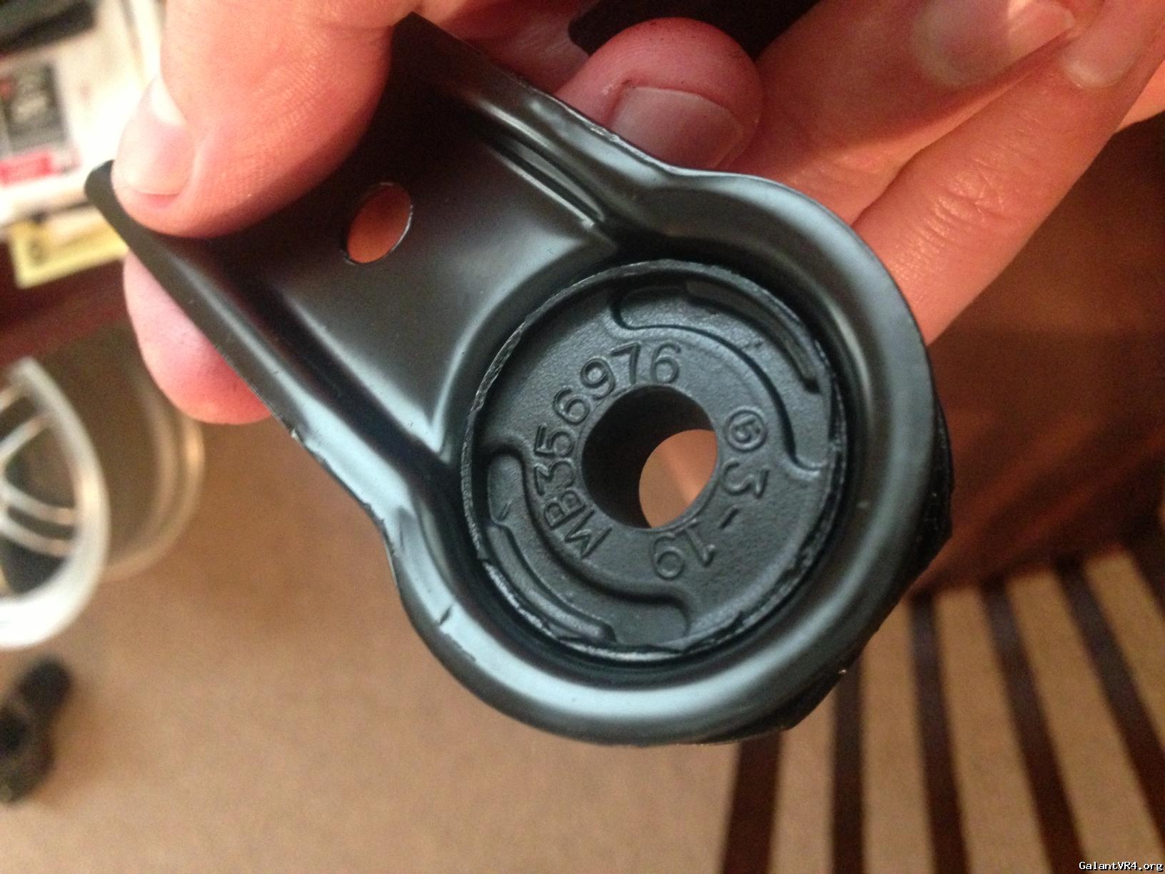

Guys, guys, guys, guys...
Bracket w/bushing is PN: MB356975 (still available, bought a few new ones recently)
Just the bushing is PN: MB356976 (but it may not be available anymore)
