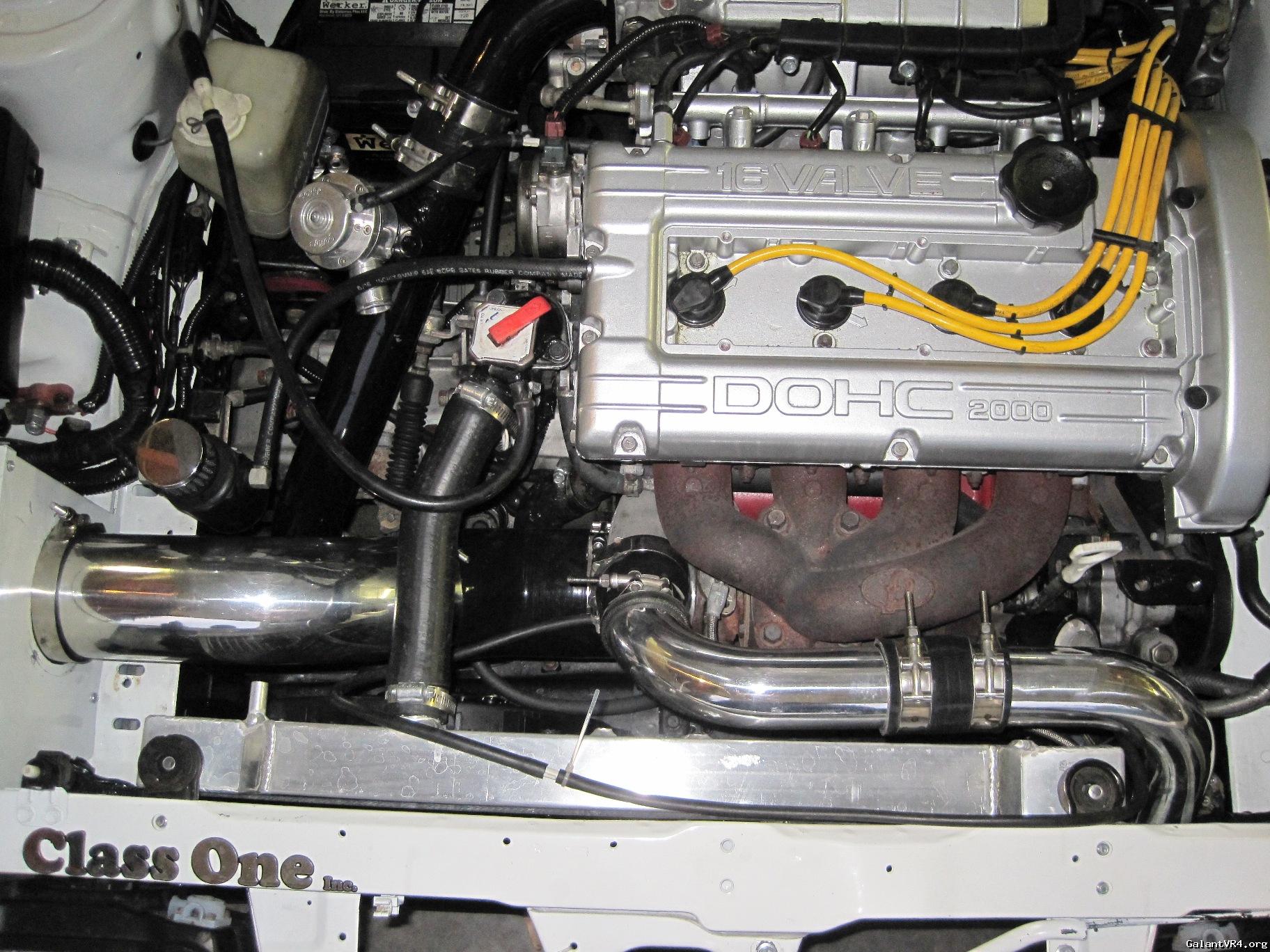

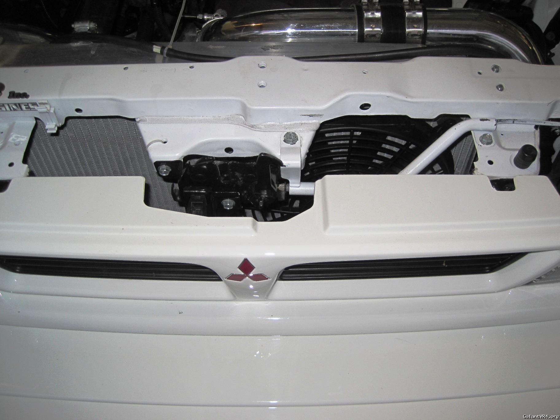

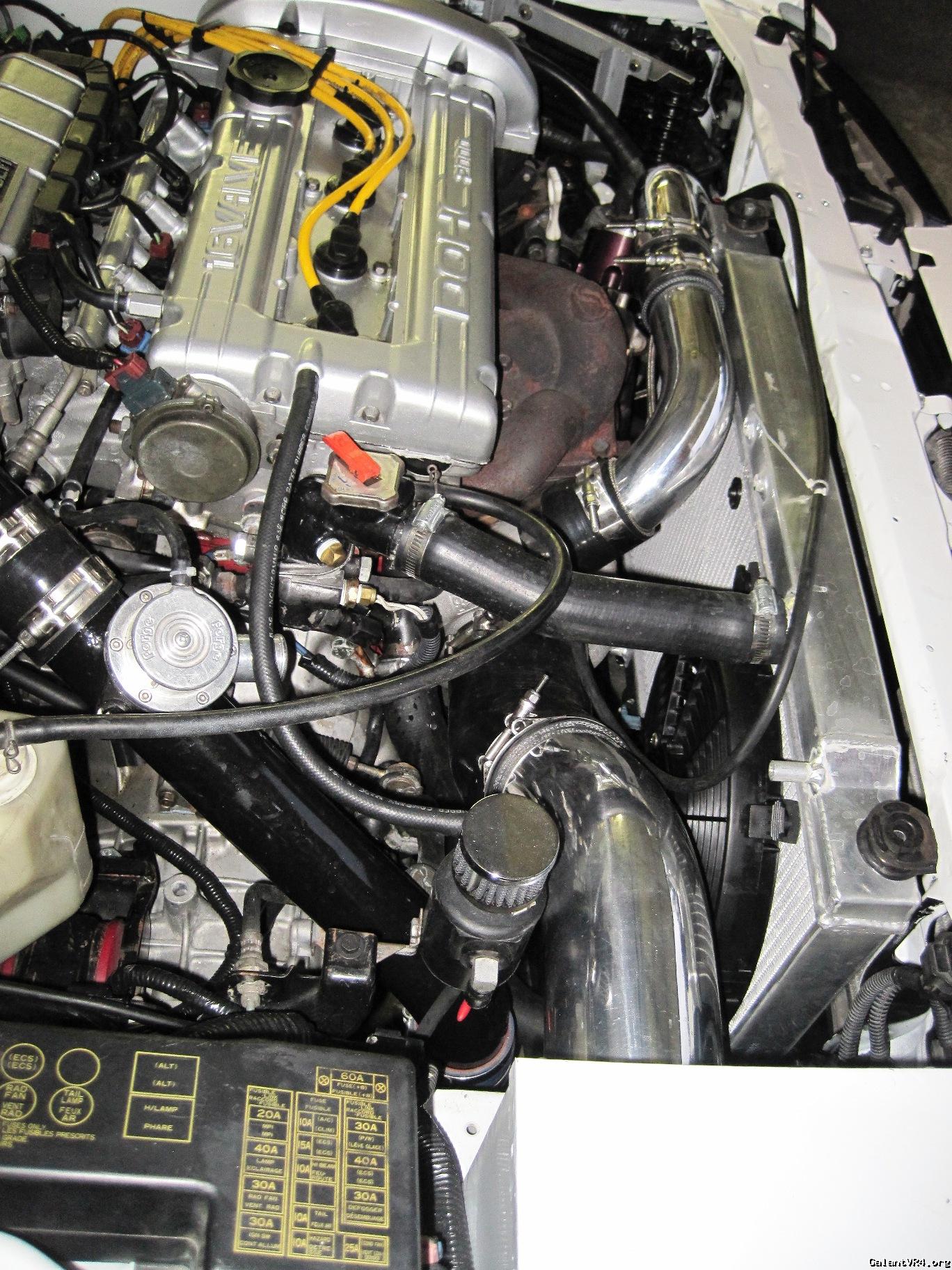

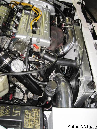

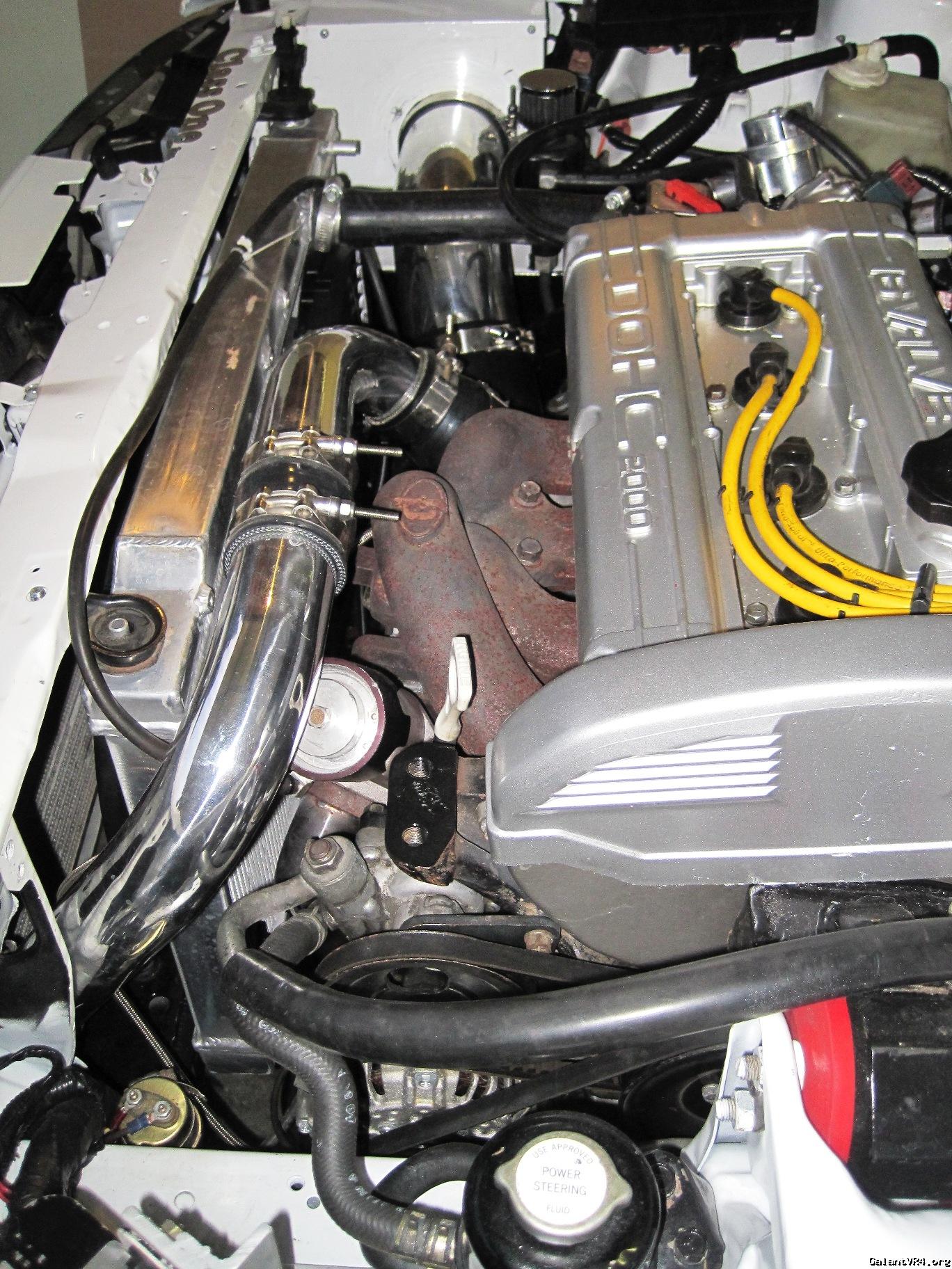

Here is the new radiator setup.

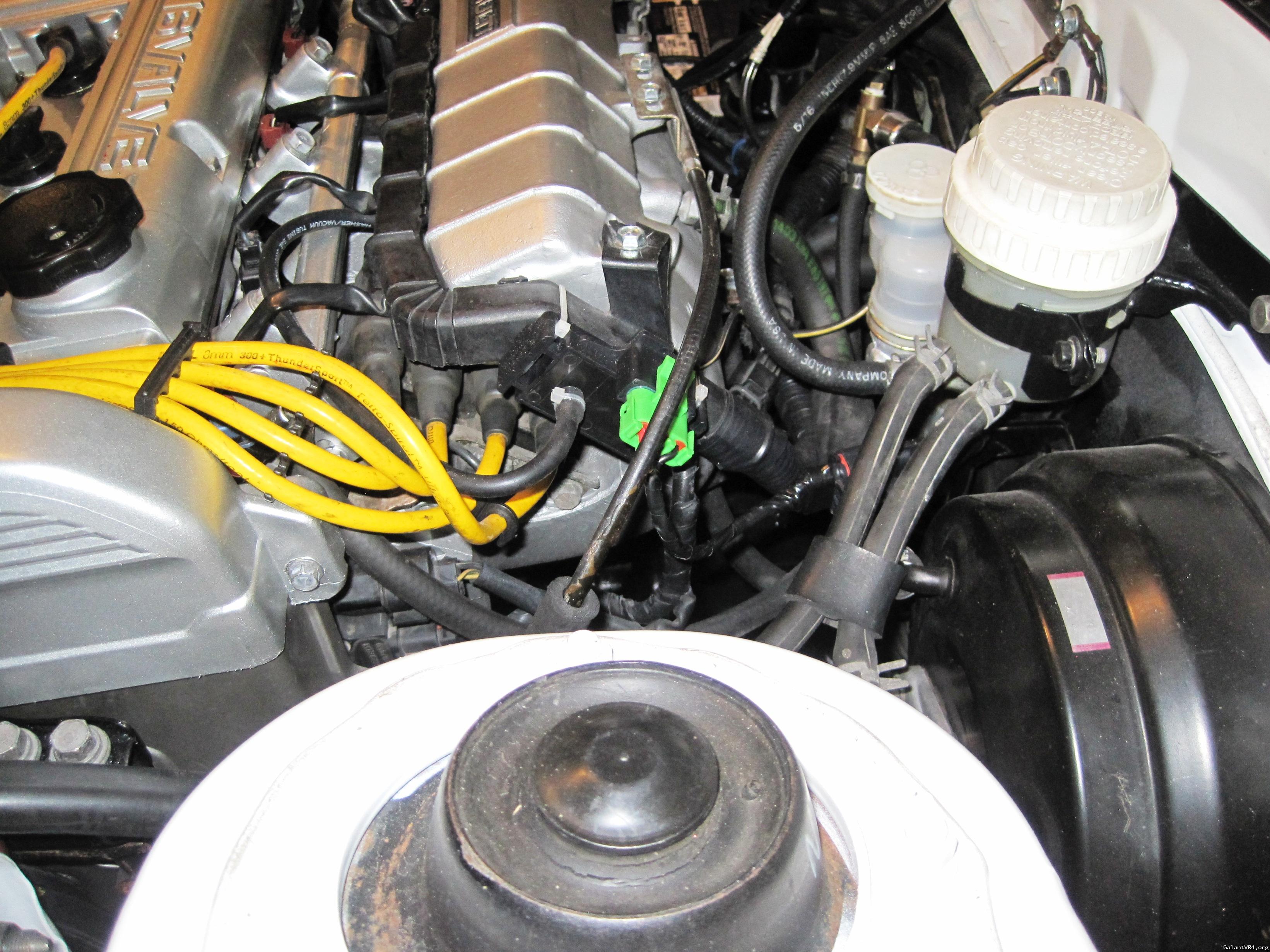

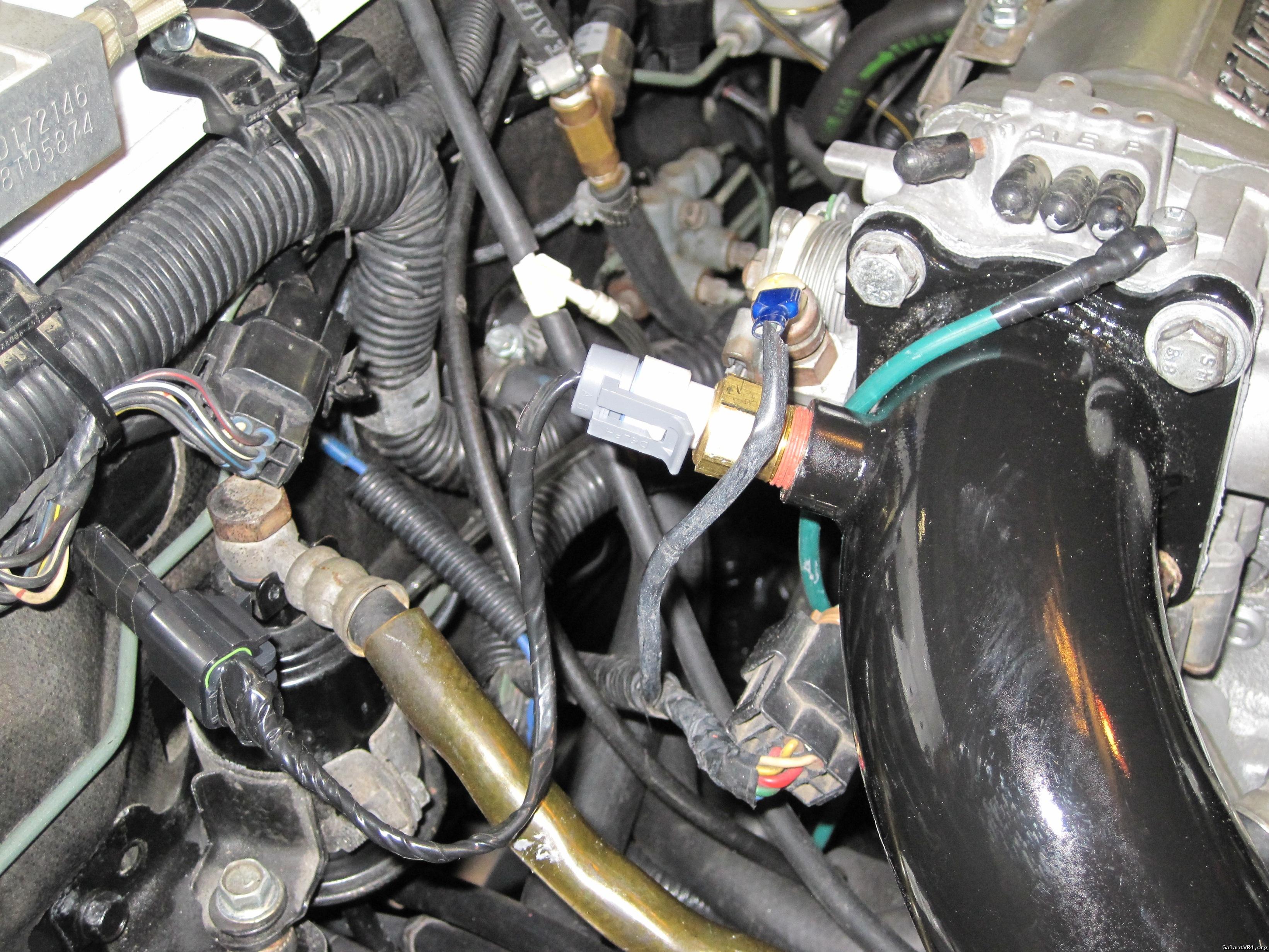

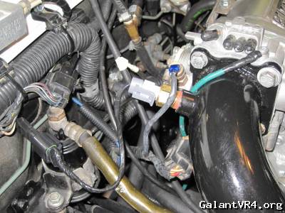

Here are some new pics of the speed density setup:

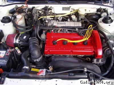

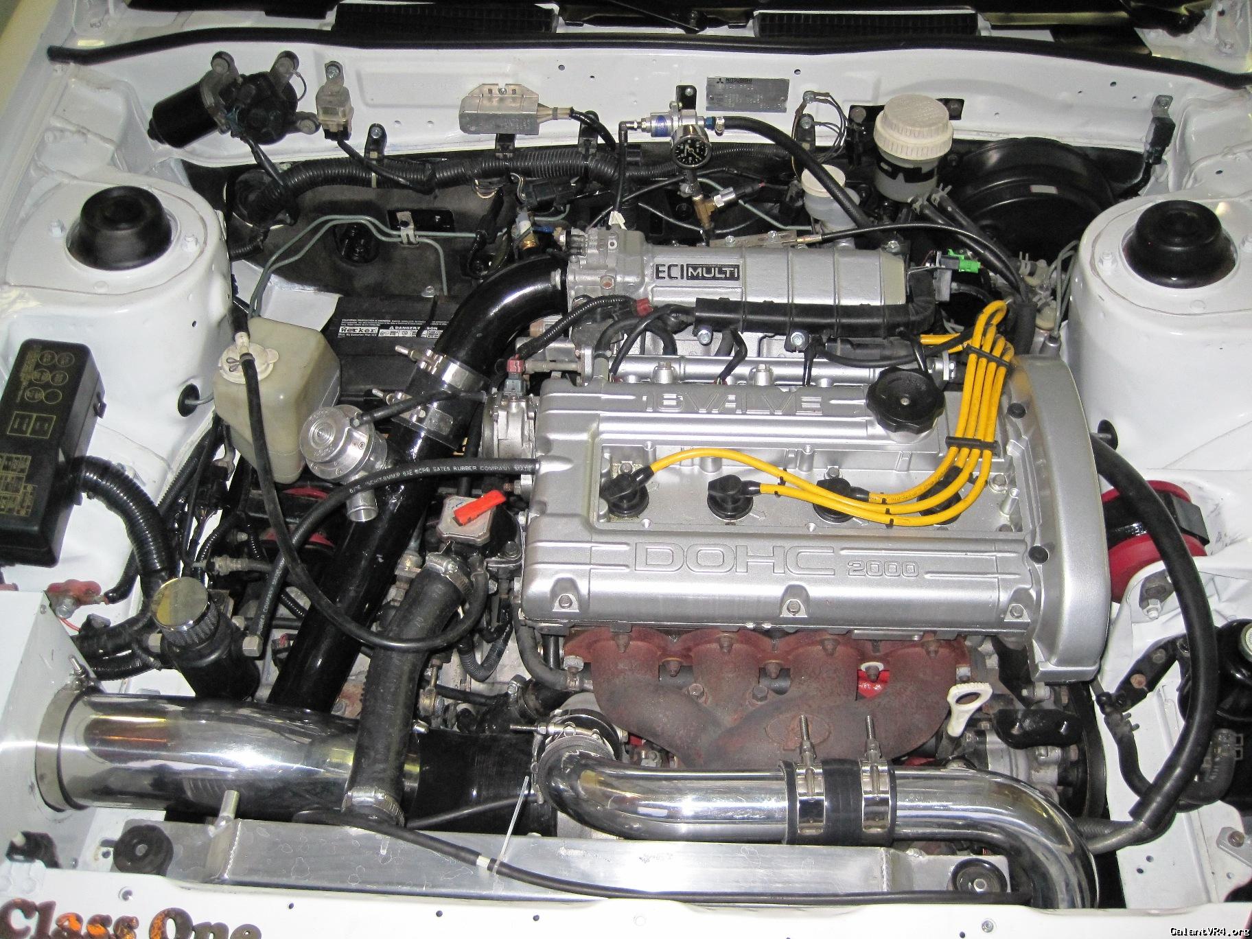

Just for you guys that don't remember what a stock(ish) engine bay looks like, this is what I started with about 6 years ago:

so they said it was getting too hot, and you decided to just change out the whole damn cooling system... =) thats how i do things haha. What kind of radiator did u use? i only see u put '1g style'
Terry Posten
Dec 16, 2003
9,009
Davenport, Iowa USA
Used to be a Small VW dual pass style unit. The old core was 12x20x1.25 with one 10" & 8" fan and the new core is 14.5x27x2 with dual 12" fans. And the old t-stat was 185 degree. The old setup drained out less than 1 gallon of coolant. The new setup took 2 gallons of coolant and that is after cutting 6" off the top hose.
