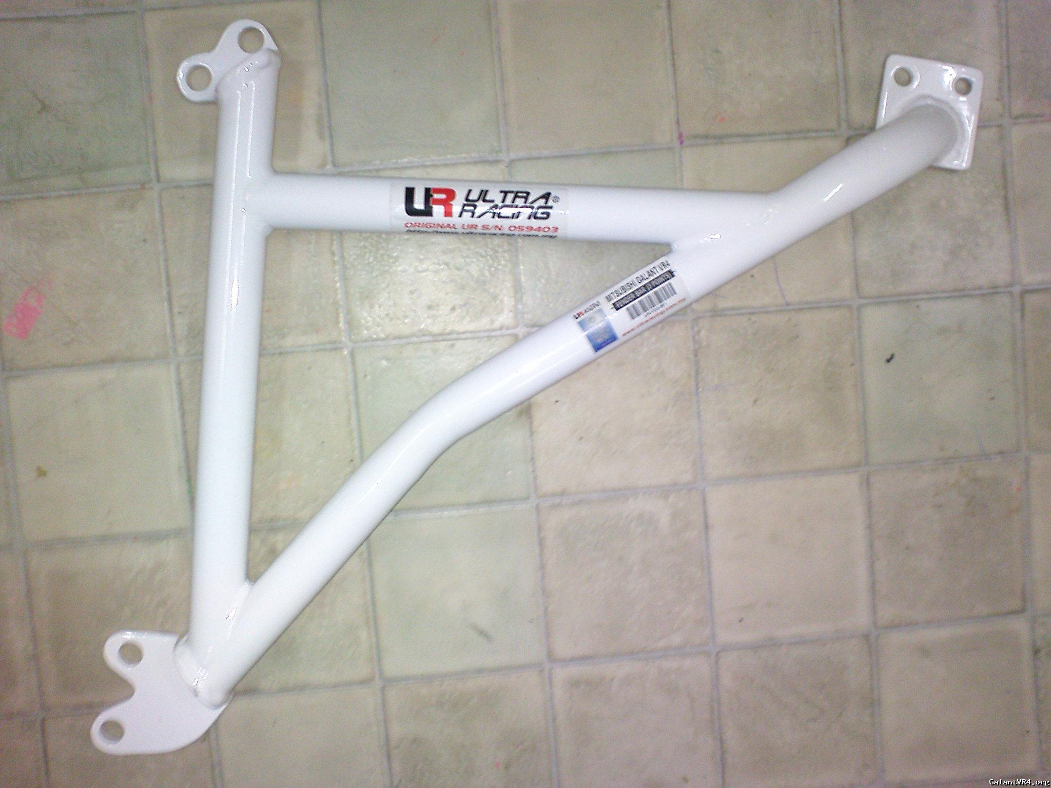

I just bought VR4 '92 ULTRA RACING 3 PTS FENDER BAR from ebay.
What do u think?
I think this is good upgrade for handling. I am thinking to make custom X bar down the car also.

The triangular bar behind the fender design is also flawed. By connecting the upper hinges, lower hinges and the behind the fender mounting point, any deflection on the front quarter area are going apply a pivoting force to the behind the fender mounting point (the one showed in your picture with 3 mounting bolt). They really need to square off the design of the front mounting point by adding another mounting point to keep everything square and prevent the force from pivoting on the front mount.

I am sure this is not the perfect design. At lest the only plug & play I sow for GVR4. custom is pain most of the time. I did brackets for 3kGT caliber & ended to say I spent money for non perfect one & sorry not to buy one ready.

Well, I just ordered a set. I can't see them doing any harm and although they are very nice looking pieces they are going to be hidden under the fender so if they need another support point to be welded in it could be done and doesn't have to be pretty. I really just want to see if this creaky door issue that I have is due to chassis flex and if I can reduce it by stiffening the chassis at that location. I'm not sure yet but I may also weld these in rather than just bolt them on.

Right Gentlemen,
We installed these on Saturday. Preparation (i.e. removing the fenders) is 90% of the work. The pieces are very well made and the mounting holes for the door hinge brackets lined up perfectly on both sides. My only concern is the forward mounting bracket. You simply drill two holes in the chassis and bolt it up with the supplied hardware. The section which it bolts to is double skinned but I still felt that if any force was applied to this bar that the chassis mounting point would deform long before the bar itself did.
We mounted the bar as suggested, by drilling and bolting it up but I do think welding it at the front would be preferable. In a perfect world I think maybe even welding more support into that section of the chassis would be beneficial, but I may be over engineering things.
What I can say however is that you can definitely feel a difference. It certainly is more noticeable when the suspension is under load. There is a slight improvement on cornering similar to that felt by upgrading a sway bar but the more noticeable difference comes when both struts come under compression simultaneously like when driving over a speed bump or going up a ramp. It feels more solid, there is more feedback through the chassis but like many chassis reinforcement mods like hard bushings, swaybars etc it does make the car a little more harsh and less compliant.
Edit: They have also solved my creaky door issue and the doors seem to close better now.
Anyway just thought I'd give these a thumbs up and my first impression. I'll monitor these and see if they develop any issues over time with the mounting points being too weak, but initial driving suggests that isn't an issue.

I just got mine. I am thinking to wild a sheet on the body then drill it. and may use bigger bolt than they sent.

As for the fender bars, I can definitely say that they have resolved almost all of my creaking issues. I was listening as I drove the car today and pretty much all the noises that were emanating from the driver's door area have gone, which suggests to me that a combination of chassis flex and door hinges inside the fender that clearly hadn't seen lubrication for years were the main culprits. The only remaining sound sometimes evident on acceleration and braking seems lower and could well be a subframe or control arm bushing. It's not a ball joint or sway bar link, since Ken swapped those out for me last week. So overall, I'm very happy with these bars already.
