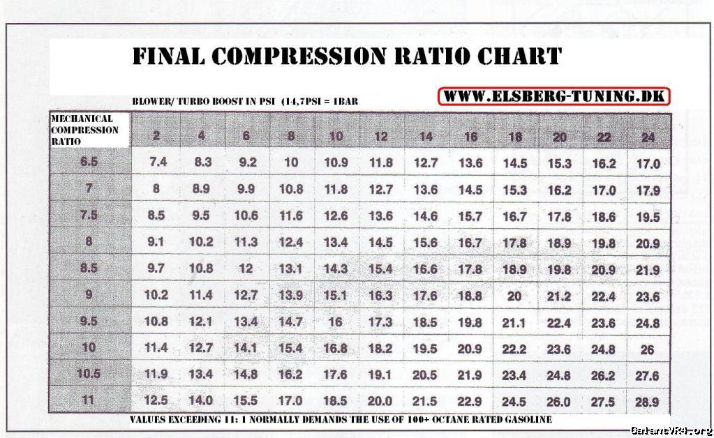

forced induction basically adds to the compression ratio and in addition creates heat, so the engine is then much more likely to knock or detonate, go lean, etc....there are ways to combat most of that (intercooling, more fuel, richer mix, etc.)...the higher your static compression ratio is (think of baseline ratio), the less additional pressure (boost) you can do, as that raises your total effective compression ratio (base/static and additional pressure).
with higher performance cams, aluminum heads and such, you can bleed off some of the pressure, but youreally risk getting too much with higher static CR...we're lucky we have EFI and electronics, but even on a N/A engine, 11.0:1 is pretty high...I wouldn't risk any boost on it, as it would almost be useless (max 5-10 psi, let's say and that's nothing for a puny 4 cylinder).
as a GENERAL rule of thumb: increasing compression ratio 1 point (1.0, not 0.1) = ~4% increase in power.
Here's a handy chart I stole off another website...see how high the compression ratios get!
