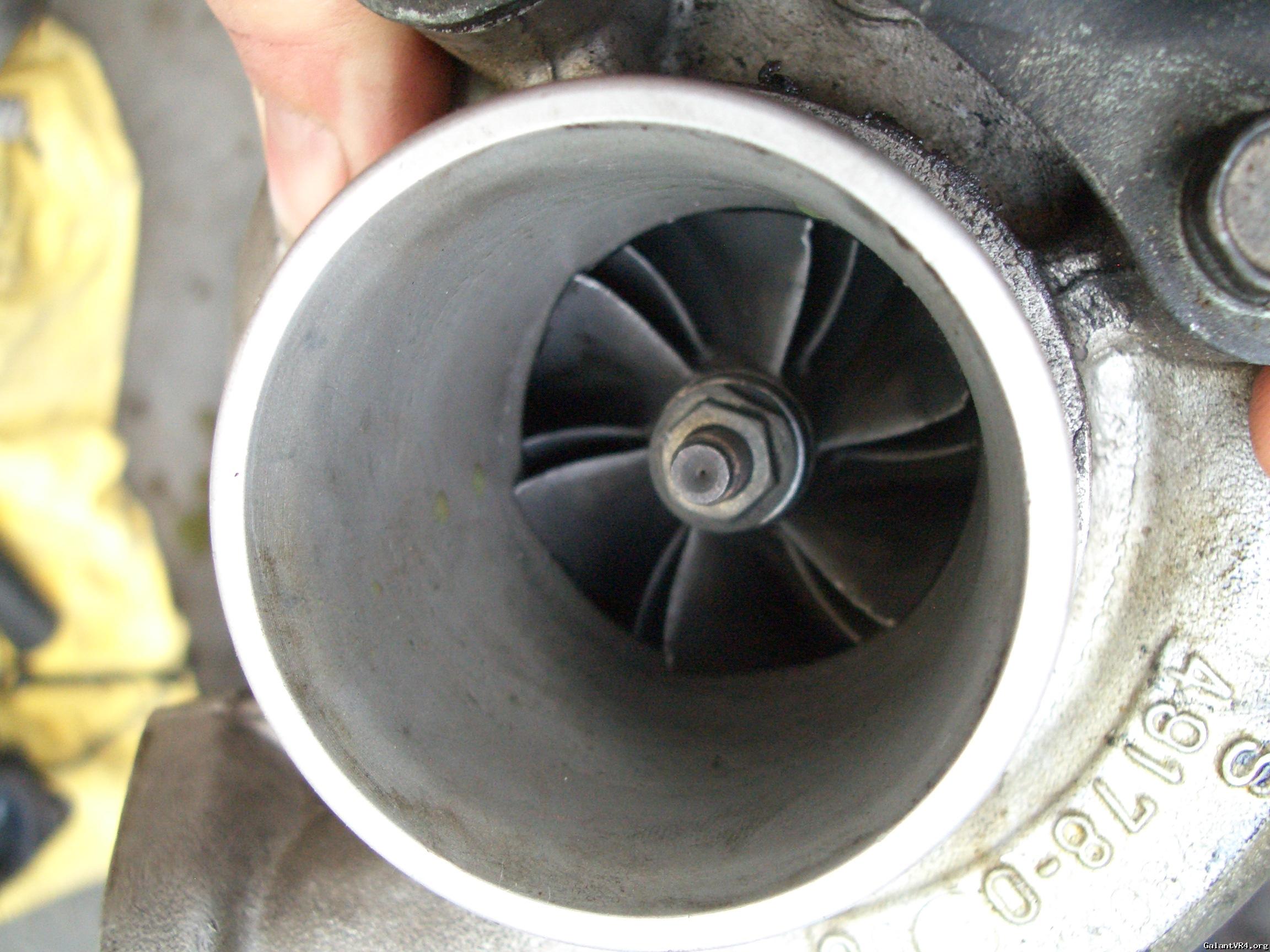

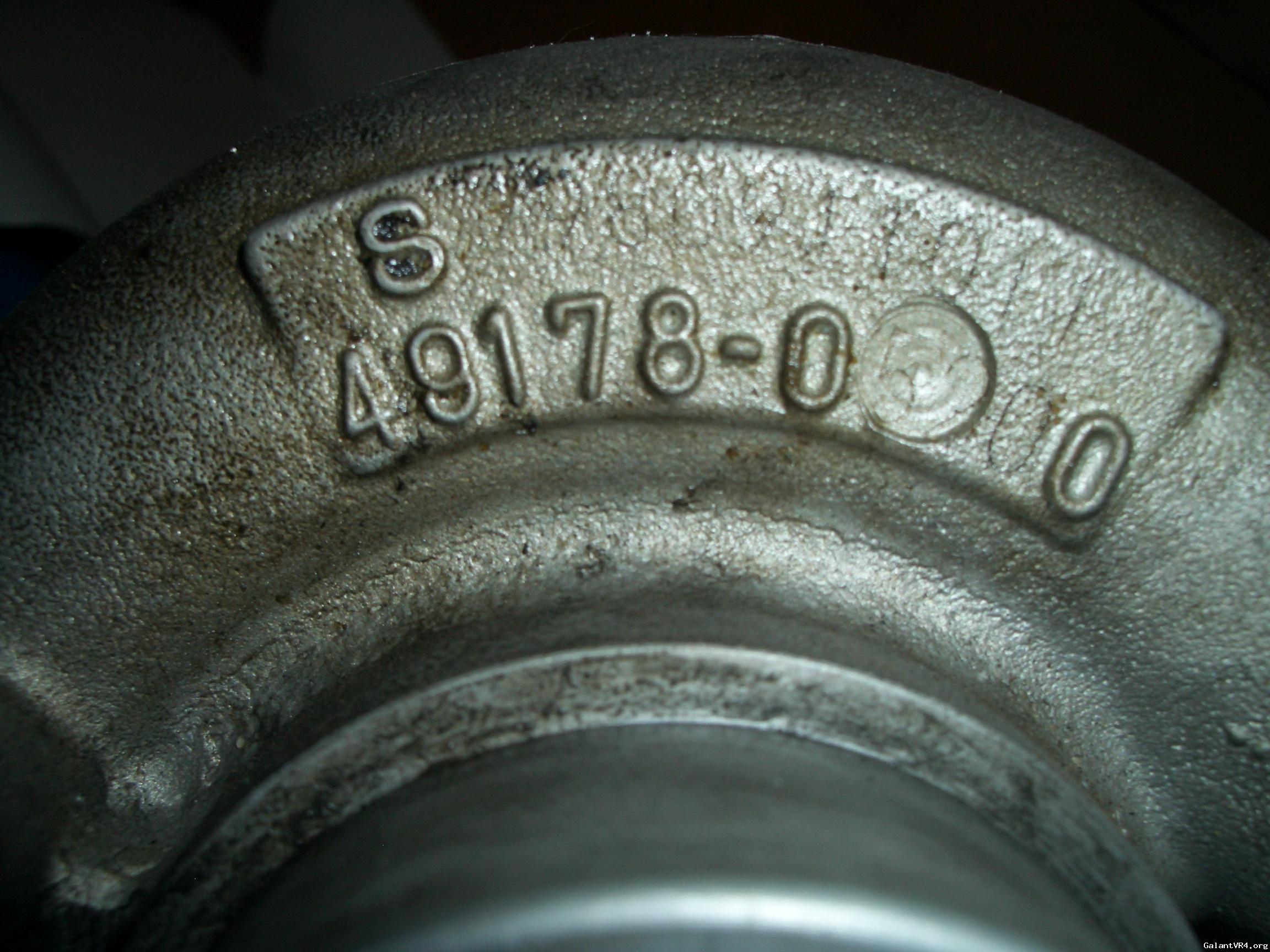

My turbo markings are 49178-0520 0 and it says tdo5 on it. I found these identification numbers online and none of them match up exactly to my turbo. What turbo do you think I have? I'm hoping it is the small 16g since it is the closest number but I'm not sure.
RE: Mitsubishi Turbo identification
49178-01(40)0: 14B
49178-01(41)0: Big 16G
49178-01(42)0: Big 16G
49178-01(45)0: Evo I Big 16G
49178-01(46)0: Evo II Big 16G
49178-01(47)0: EVO III 16G
49178-01(52)0: Small 16G

Nice turbo. What is it? A 16g, 14b...? My looks almost exactly like that. I think yours has a small taper on the inside edge just like what I have and the fins look just like that. Thanks.

Nice turbo. What is it? A 16g, 14b...? Mine looks almost exactly like that. I think yours has a small taper on the inside edge just like what I have and the fins look just like that. Thanks.

Quoting nandovr4:
Thanks, but your link went to Google gmail login. I don't have a gmail account.
Fixed. Both pics reflect the same genuine MHI small 16g.

Sweet!! I got a small 16G and didn't even know it! I thought I had a 14b all along. It is in perfect condition too. Funny thing is I almost bought one a couple of weeks ago. Thank goodness I didn't. Thanks guys! Awesome! I'm just putting on my 2g manifold and ported O2 housing as well. This should help. Once I got my ecu and boost gauge and controller hooked up I'll be rockin and rollin.
