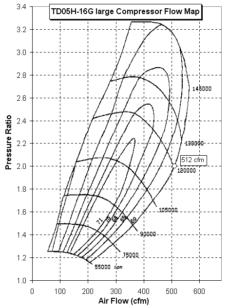

here ya go kenny.. this would be a killer setup.
And here are the specs on the jdm evo9 turbos...
RS and GT use the TD05HRA-16G6mC-10.5 with the titanium turbine and the mag. compr.wheel.
GSR use the TD05HR-16G6C-10.5 with iconel turbine and alu wheel.
MR use the TD05HRA-16G6C-10.5 with titanium turbine and alu wheel.
