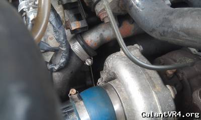

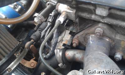

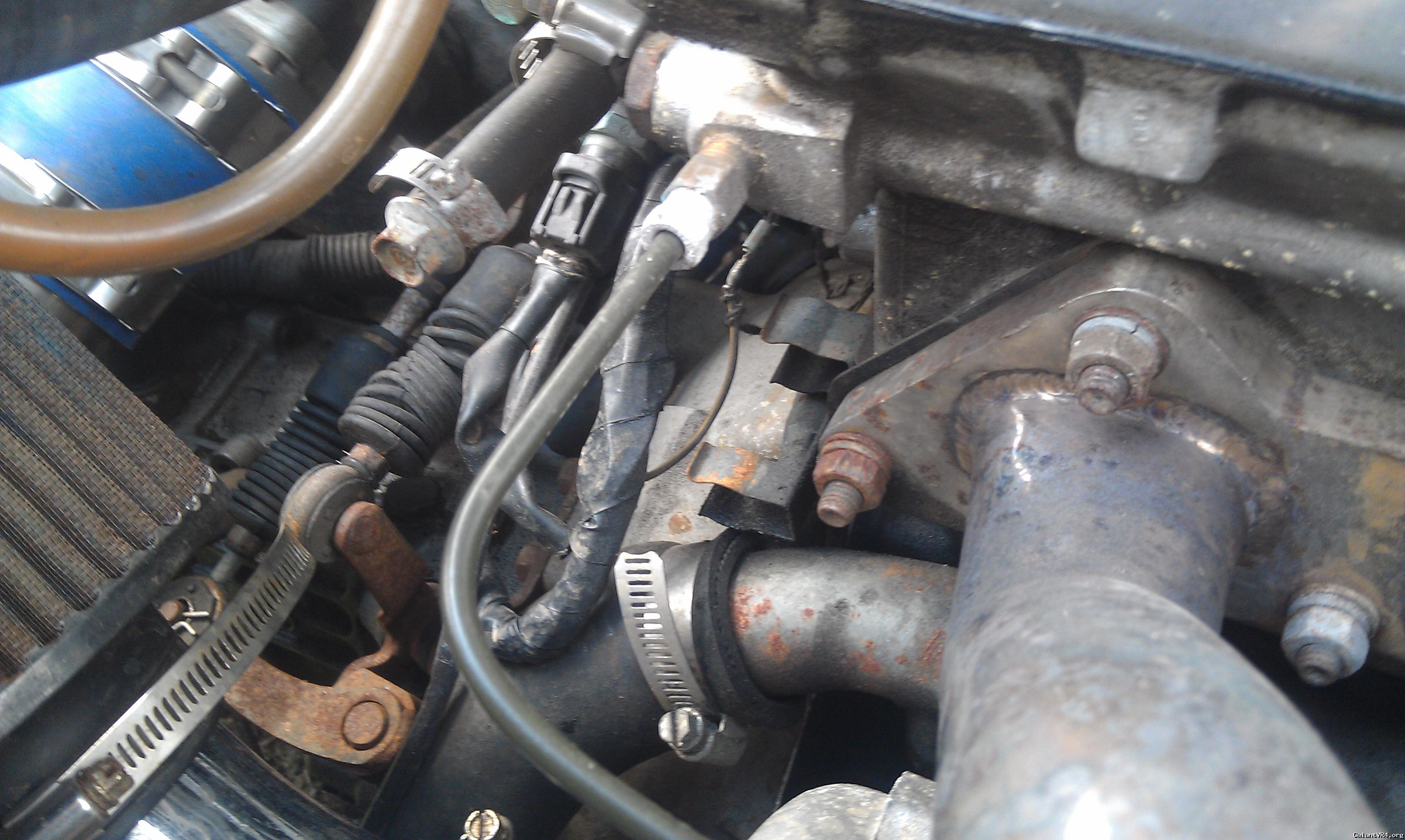

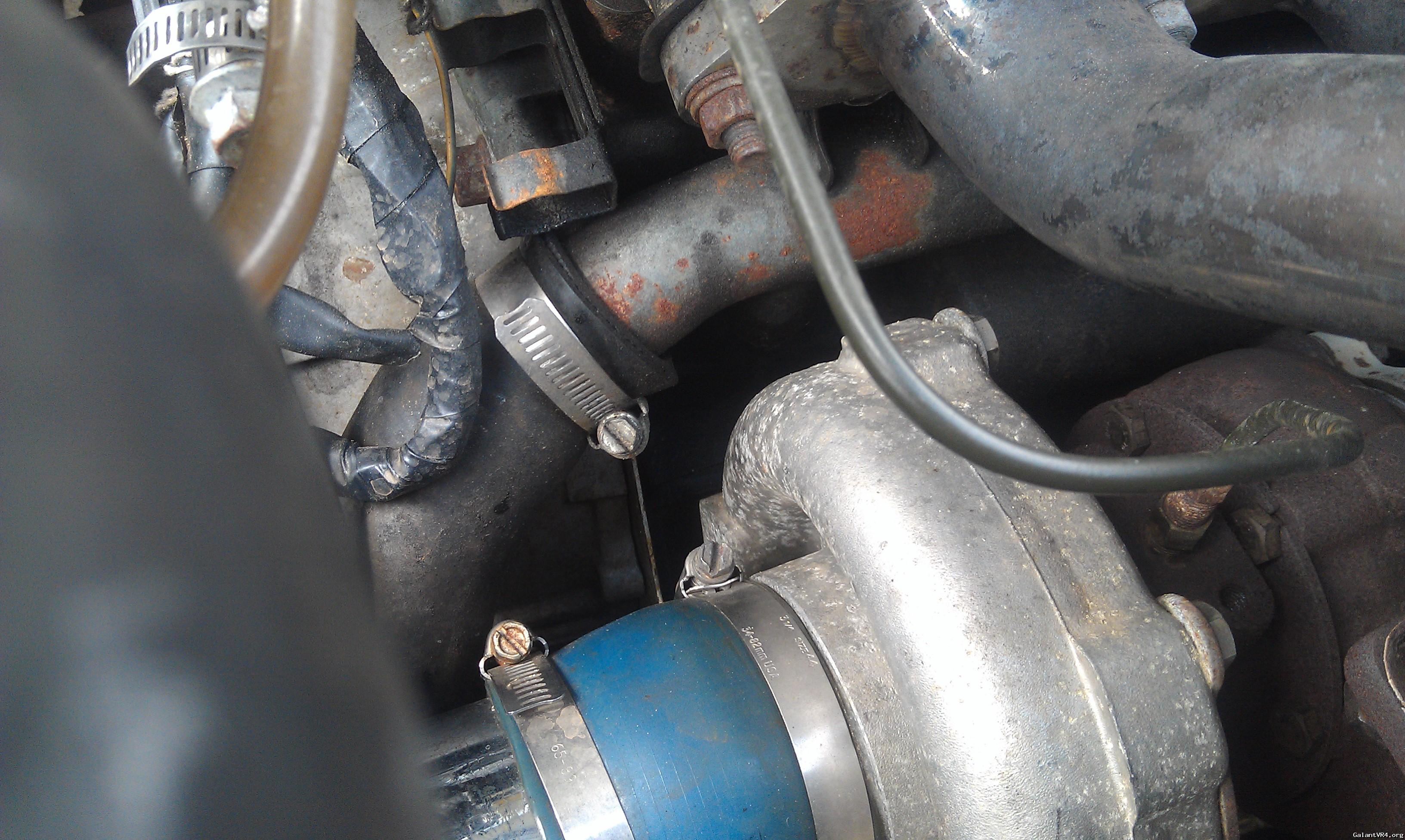

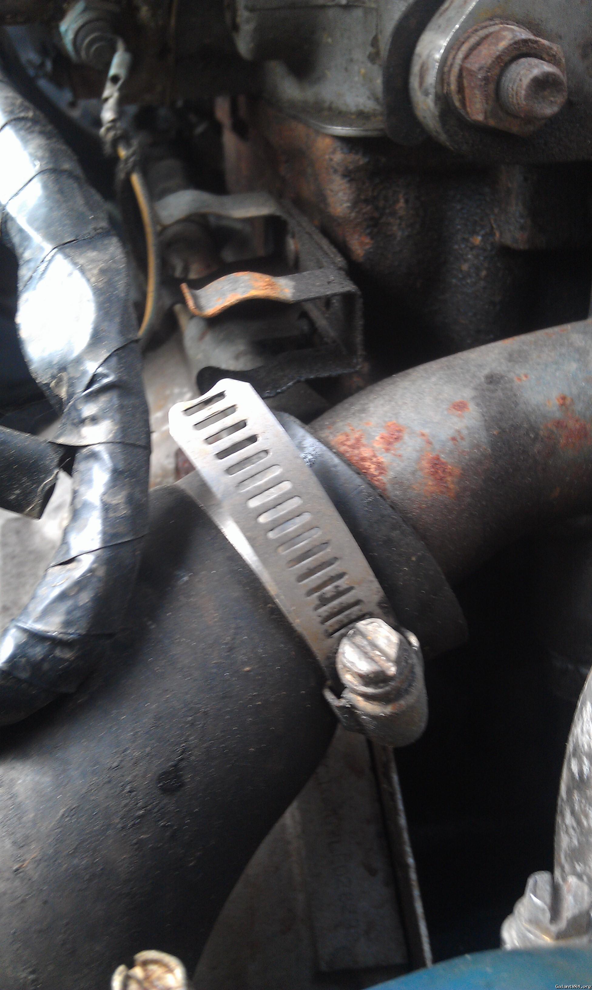

okay so I got the turbo and setup in the mail. thank you boosted! I checked my situation today. my water pipe has a pipe going down that is crimped or something. I took a picture of it with a cell phone just waiting on that to charge and ill post. I may be able to use my current down pipe and just remove the o2 housing. I think I'm down to just needing a couple gaskets. coolant lines and maybe a new feed line as well? the feed line on my turbo is just screw style. I don't have a banjo bolt. what else uses a banjo bolt on the turbo?

okay so ive done some reading... I do have an external oil cooler. is adding coolant lines to the turbo necessary? I did see your post about 20k+ miles as a dd might show through. I'm just worried about my water pipe and the line that feeds the turbo from there. seems like mine was hacked.

You would find the outlet for the turbo water/coolant feed behind the turbo. If there is a blocked off port, then you have the correct connections to run coolant. But, if they installed a non-turbo water-pipe (very common) then the pipe will be smooth with no outlet.

Looks like a NA water pipe to me. Not hard to swap though.
Personally, and it's just my opinion, but I would set up coolant lines. Not necessary, but it does help the center section run cooler and keeps oil on the bearings happier. Parts aren't that much and it's not much work to run them. Looks like the thermostat housing has the fitting, but it's just plugged off.
You'll need the water pipe form a turbo car, plus the lines.
All the fittings at the turbo are banjo bolts, except the turbo drain. The oil feed at the head is banjo as well.
