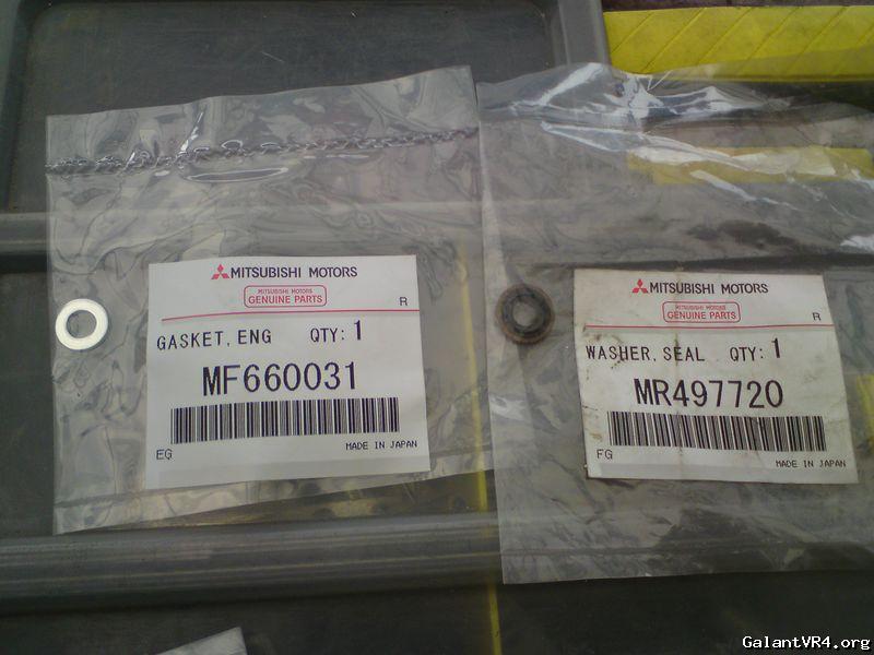

Hi guys.
I remember getting a part number from this board for washers to seal the drain line.
Anyway, I purchased a bunch of these and have used them with limited success.
So a while ago, a friend who works for MITSU gave me some new washers.

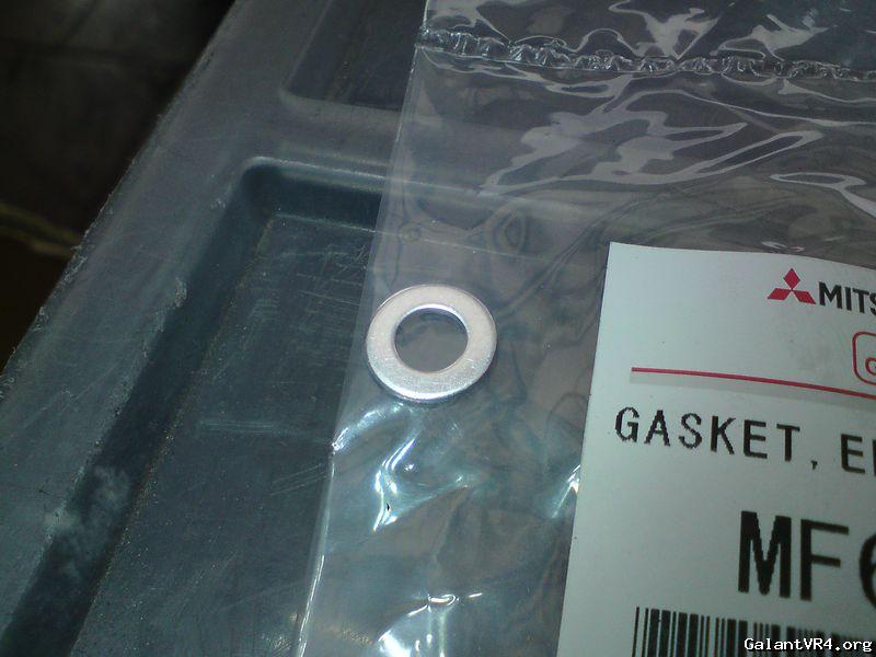

I'm not sure if you guys have used these before but they look like they will work more effectively.
Pics will describe the differences.
Part numbers are also displayed.

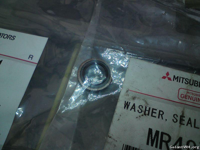

You will notice that the dark washers are the newer ones. They have an built in oring. These should work better imo. I haven't used them as yet but will give it a shot shortly.
Opinions?

They look bigger than the old ones. /ubbthreads/images/graemlins/dunno.gif The best success I have with the old style is not to reuse them a bunch of times.

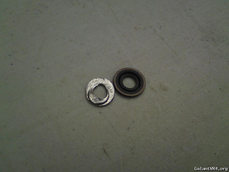

I just checked the AMG washers (alloy) and they are leaking due to the excessive crush. The nut bolt caught the washer and has broken it during the torque up.
I'll give these new washers a go and see if it stops the leak

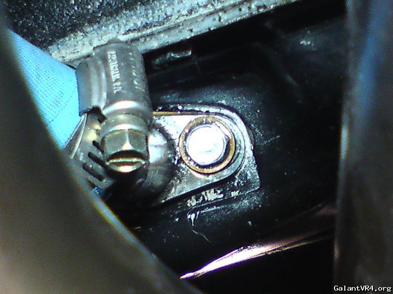

Pictures of the problem.
I'm not sure if it was due to the bolt not having a washer itself which caused the sealing washer to catch and grab which caused the distortion.
Pictures of the new washers installed. Not a sign of damage on install.
