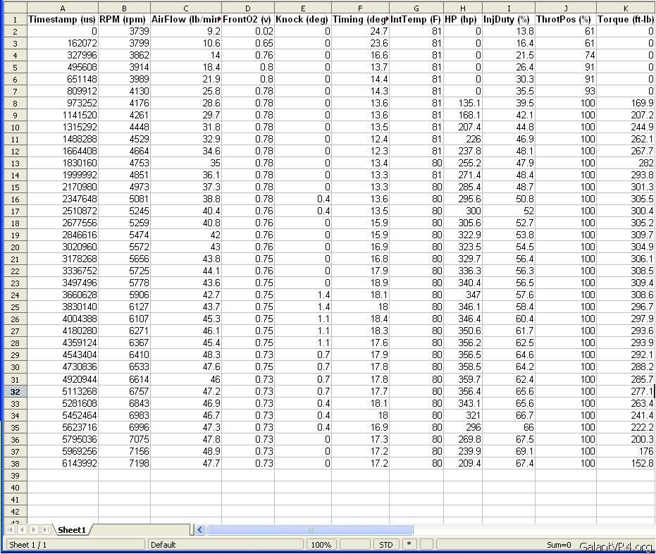

Well, I've been trying to tune this 20g with water/meth and have had issues getting this damn knock out. If I try richening it up, it will knock, if I try to take away some timing, it still knocks. This is only at 19psi. Most of the time logs show no knock but every now and then I get a log like this. /ubbthreads/images/graemlins/bawling.gif

It looks like your GM Maf needs calibrated, it's reading pretty high. Definitely get a wideband, you can't really do any accurate fuel tuning without one. Get a good tune without the water/meth injection, then try turning up the boost and using the water/meth.
What octane fuel are you using? It's really hard to say for sure, but you might be trying to get too much timing advance out of it, try shooting for around 15-16 degrees and see what that does for knock.

Yeah the sliders on the maf compensation window are zerod out. I am trying to tune for 93 pump gas. Wideband should be on sometime this week.
I appreciate the link and will tune the gm maft first. I still have the virgin vr4 mas here (thank god). Or I can try to tune it via boost guage and boost est, since I dont have a gm sensor.
