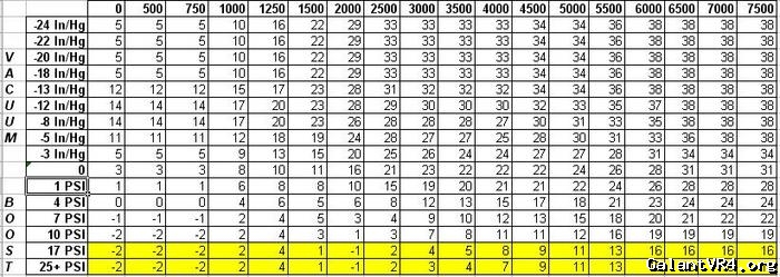

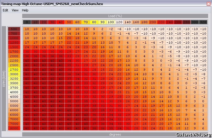

Also, for reference, these are the 2G and Evo timing maps. Yours should be similar, leaning toward Evo since they also run 8.8:1 compression.

I LOVE YOU MAN! I've wanted an evo map for a while now and haven't been able to dig one up. I'm running close to 8.8:1 so I want to start with that.
