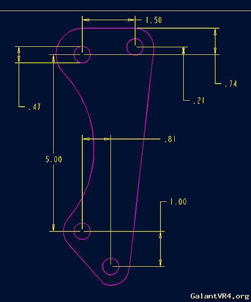

Quoting Okayplayer:
I found this little guy:
This design will not work the same as the Tuners Nation brackets. It's meant for a different rotor. I think it was for a cobra rotor, but I can't recall exactly. I can try to get measurements for the Tuners Nation brackets, but only if the original designer explicitly agrees to me posting them for someone else to make.

I know they are for a larger rotor, for the 94-04 mustang cobra which is a 13.1" rotor. Which would not be a bad deal as I've found brembo evo 8 rotors on ebay for $33 a pop, which would only be 10mm smaller than the cobra rotors. That would be really nice if he saved me the trouble and gave out the specs. I need to know which one I'm going with so I can buy my rotors.

Well Let me know. If you get dimensions, I came make a quick batch of them. Not trying to make money but help out situations like the above ^

Quoting 524of1000:
Quoting Okayplayer:
f*** that, it's just a bracket. post them up!

If you're going to copy something, do you really trust that "drawing"?

Somebody just post some dimensions of the tunernation brackets and I'm sure people here will be resourceful enough to make them. I'd try, but the only brackets shown supposedly won't fit the 3si calipers or rotors.

The only bracket I found on tuners is set up for a '94 & up 3KVR4 brakes with cobra rotors. They also position the caliper a bit lower than the GW brackets.
